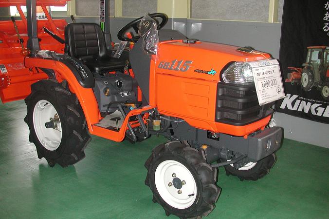

I Bought a BX2200 last summer. I wanted a smaller tractor for grass cutting and misc. things. I already have a B2910 so I did not get the BX2200 over the BX1500 for size reasons.
I mainly did not like the BX1500 engine. That extra flywheel for balancing did not turn me on. It is probably not an issue. It just did not seem like something that should be needed.
There is a fair jump in price from the 1500 to the 1800, but from the 1800 to the 2200 was something like $500, so I ended up with the 2200. For reasons that have all ready been stated by others in this thread. Also liked the 60" mower.
In Japan, Kubota offers a 2 cylinder diesel in their tractors down to 10.5 hp. There is no rotating weight on them. They look just like the 3 cyl. engines, with one cyl. missing. I did not think to put my hand on one running so I don't know about vibration...I doubt it would be THAT bad, but I don't know.
Attached is a shot of a Kubota Granbia-boy Series GB11.5. Engine size is 2 cyl. 10.5 hp.
I will also post an engine pic...

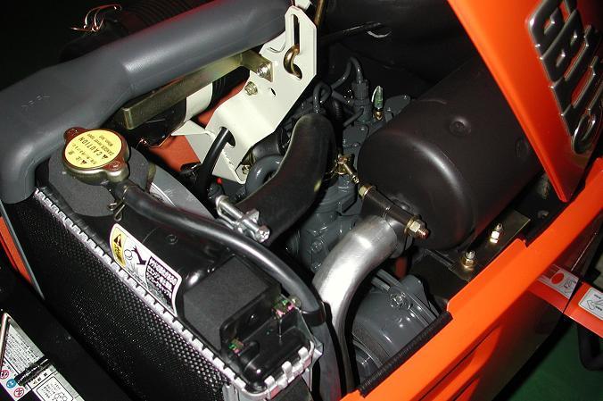

Here is an engine shot. Hope it is not too dark...
These pictures were taken last November when I was in Japan. I have more and if I ever get them resized I will start a seperate thread showing them... /forums/images/graemlins/blush.gif
