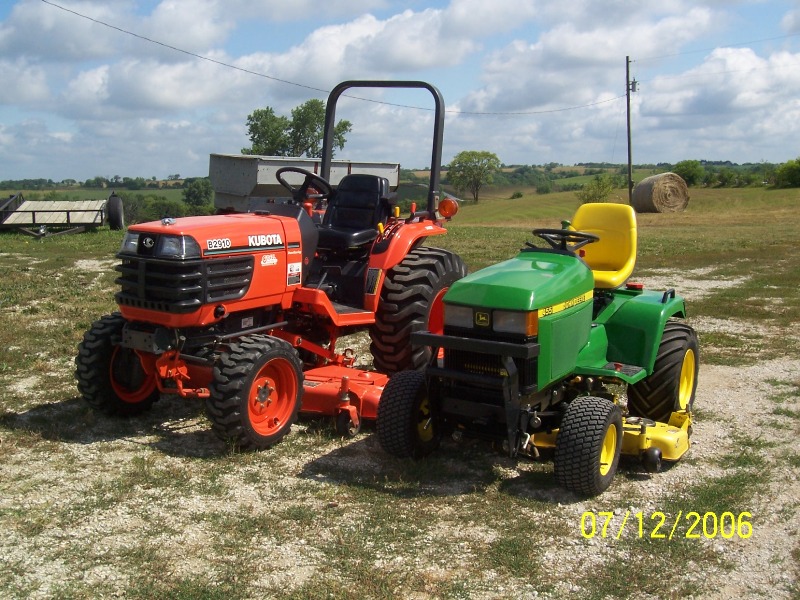

My first JD was a 1974 140, it's still running and my Son uses it, hydro, no 3pt lift. Not sure what the going price for a 140 is but they are pretty much an antique now. My Son bought a 420 which is considerably bigger with a 72" deck and 3pt for $2250 last year.
My second JD was a 1990 322, gas, 3cyl Yanmar, hydro, 3pt, pwr str. My second Son is using it now with 1500 hrs on the meter and no major repairs. great unappreciated tractor. Smooth as glass, great power. A good one will bring $2500 in the midwest.
My third JD is a 2001 455, diesel, 3cyl Yanmar, hydro, 3pt, pwr str. I bought it last year used with a 54" deck, 54" hyd front blade for $4750 in the Midwest. It's my favorite. As jeffinsgf said, it has awesome HP to weight ratio. I filled the rear tires and have chains for pushing snow. I also have a homemade 3pt box blade, angle blade, tote box, tandem disc. It's a great tractor that bridges the gap between a garden tractor and a CUT. Mows my lawn like a champ and within a couple minutes is converted to a hard working SCUT. I really loved the 322, but the 455 is just better, stronger and uses less fuel. I don't expect to wear this one out. Am attaching a picture of it with it's bigger cousin.
