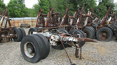

Is there some kind of dolly you could use? It would support the weight, but would need to be fixed for backing. You would not want it to pivot at both the 5th wheel and the draw bar.
   / Which compact tractor will move 5th wheel campers? #5
something along these lines might work for you. have a fabrication shop make it up for you.
I move my 30 foot gooseneck with my front loader...but i have to use a good counterweight.
   / Which compact tractor will move 5th wheel campers? #6
I might move the attachment point for the gooseneck forward 6" or so from that one to give the tractor a little more tongue weight, but that should work.

Yeah, I've looked into Dolly's. The problem is with backing. Anything that turns will create 2 pivots which cannot be backed. Anything that doesn't turn will not pivot and binds due to having an extra axle.
I have found a portable self powered device that will work. The cost is more than I want to invest for something that has one purpose ($4500)I will stop working on 5th wheels before I spend that much

I'd personally go the dolly route. True it isn't as easy to back a trailer with a steerable axle, but you'll get used to it. My dad can back two loaded kicker wagons of hay into a barn, without even having to pull up to straighten out.
Takes practice to get good at, but you learn a new skill. Think of the truck drivers that have to do it all the time when they are pulling double or triple trailers.
   / Which compact tractor will move 5th wheel campers? #10
I beg to differ. I frequently back up haywagons which have 2 pivots. It takes some getting used to, but it can be done (especially with a long tongue on the dolly).
Here is a video of it being done:
If you only want one pivot, I would make something like Hitch Helper Motorcycle Carring Trailer Hitches by ACC Towing (possibly with brakes) to mount on the 3 point and bear most of the weight of the trailer.
That would keep a single pivot, push the hitch point back (so that the trailer turns faster) and help with the tongue weight.
