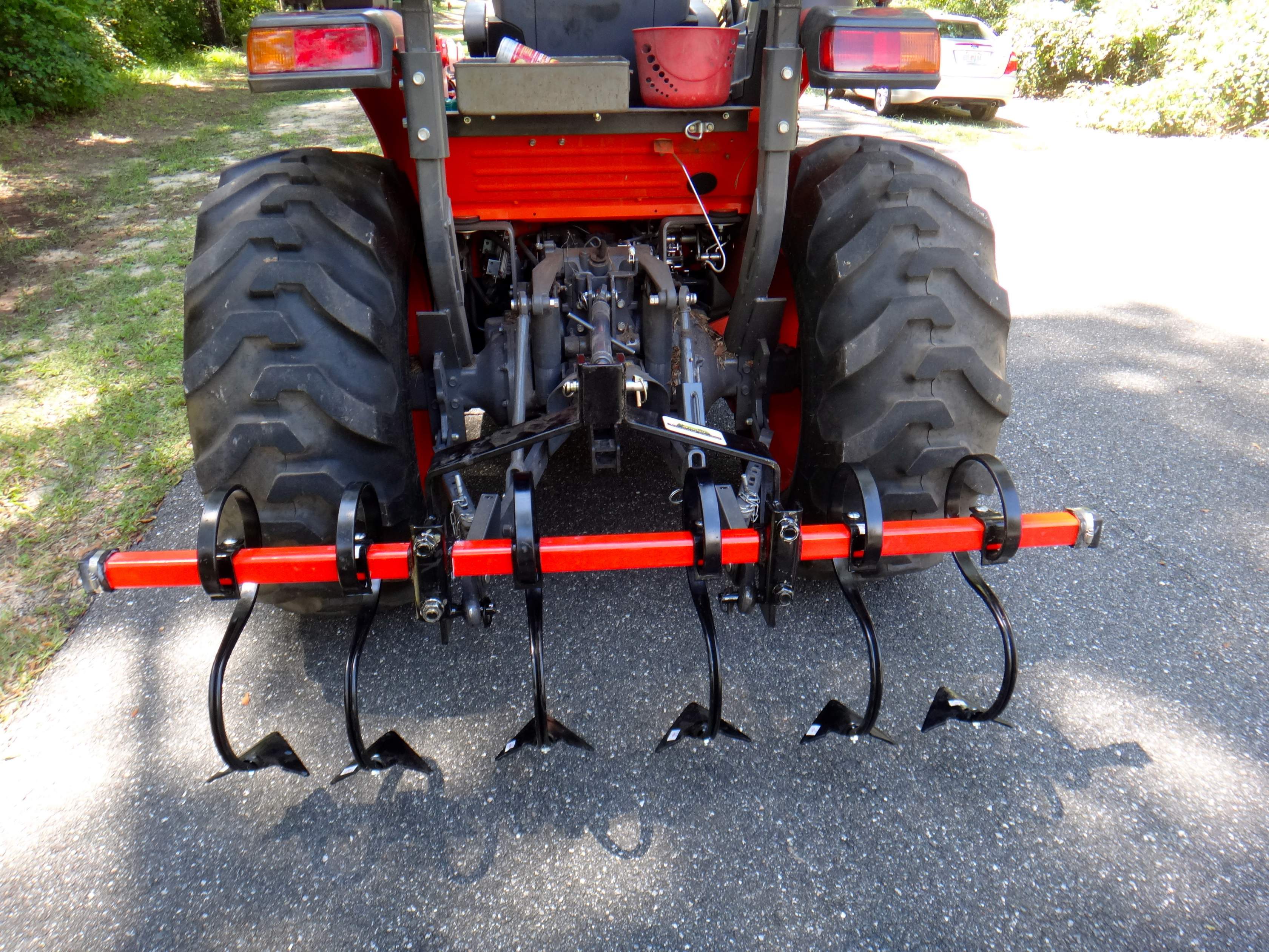

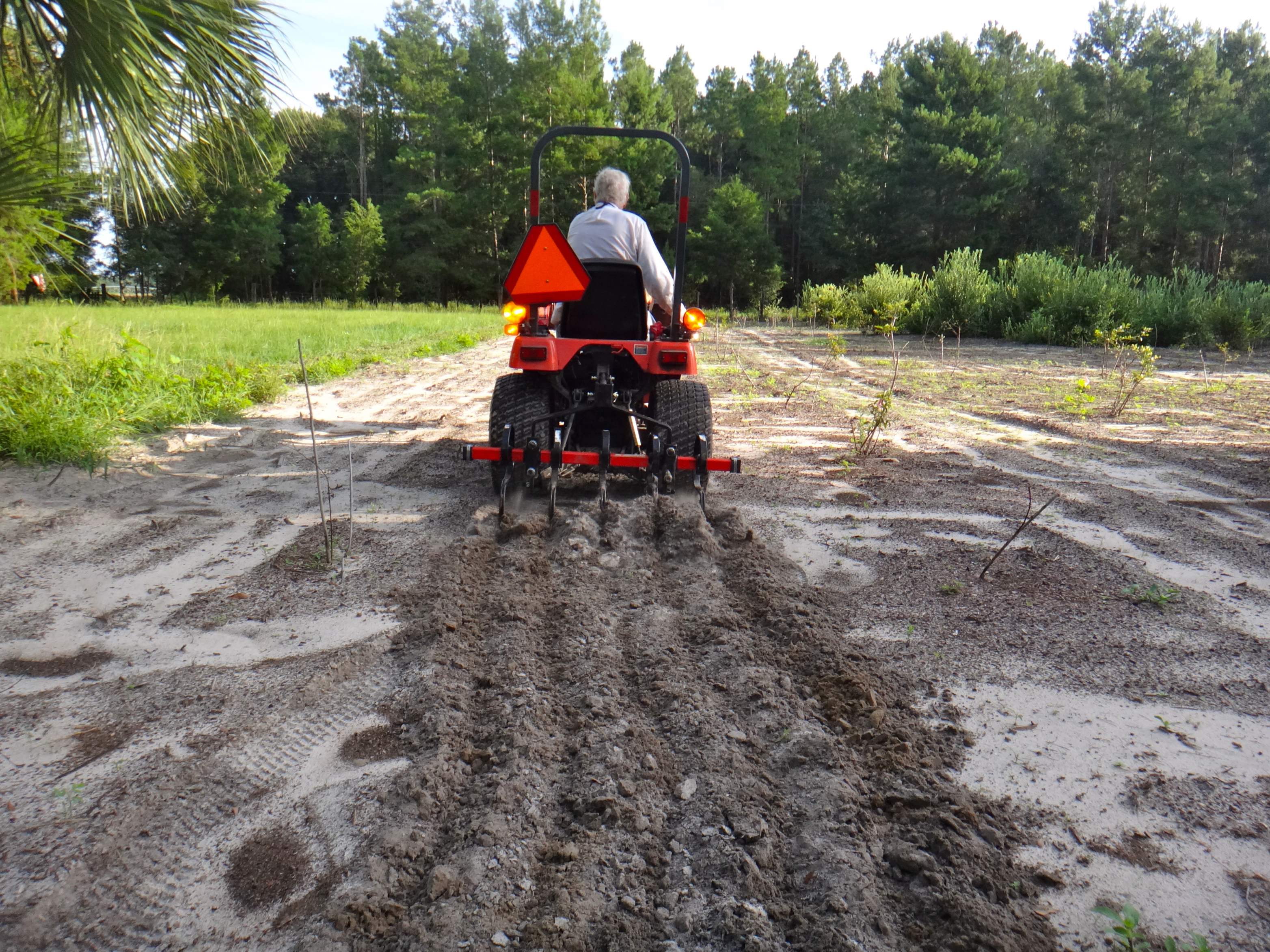

I volunteer in a small organic Rabbiteye blueberry patch. We have 240 plants, generally add an additional row of 20 plants from cuttings, each January.
We plant 8' on center. We tractor with a B2230.
We harvest. Wish we had started with 18" raised beds.

I got a Kobota BX2670 (which has a cat1 3 point linkage) as I may need the extra HP to run the spreader ran the spreader with a 25HP old Kobota and it managed just but only had a one stage clutch and taking off as well was a big ask. I put the rows at 8' centres because it is under hail netting to keep birds out mainly and it cost a lot in time effort and money so I wanted maximum plants underneath. Rather than at 10' I get and extra 8 rows 90m long which is an extra 1000 plants.
Thank you everyone for your input.
