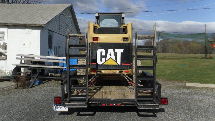

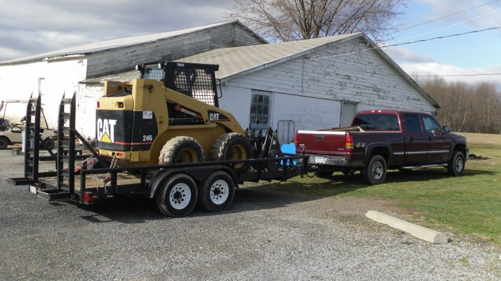

OK i just bought the 5\16 g70 20 footer from lowes this past saturday for $36 and had them cut in half but went to get a g70 hooks and they did not have any just g40 hooks will g40 hooks be ok?I went to tractor supply and they only had g40 hooks...g40 hooks be ok?

The chain is rated at 5,400# so you will need a hook that meets or exceeds that. I would not think a G40 hook in 5/16 would be that strong. Not really sure though. Try looking on the net for a chart showing hook strength. You may have to take them back and order some.
To be honest you really only need a hook on 1 end if you are using four binders. Just hook the chain to the tractor and the binder to the trailer and cinch it up instead of the common chain to trailer and tractor and binder in the middle.
Chains used for tie downs must conform to the "National Association of Chain Manufacturers Welded Steel Chain Specifications" and have the appropriate WLL limits required for the load being hauled. Any chain used for tie down should be marked with it's WLL for easy identification, if it is not then a minimum is assumed and in the case of chains that I believe would be a Grade 30 chain which has about less than half the WLL as an equivalent sized G70 chain. At the present time unmarked chains are allowed without your vehicle being taken out of service but you will receive a warning. Come Jan 1,2011 all tie-down WLL's have to listed by the manufacturer or your journey will be interrupted somewhat.
So if your G40 hook is stamped with the above spec then it should be in full compliance for use as a component in a tie down assembly. If it is also stamped with it's grade then it's full associated WLL (3900 lbs.) can be used. When attached to your G70 chain (WLL of 5400 lbs.) your chain assembly can now only be rated at the lower WLL of the grade 40 hook at 3900 lbs. Though I doubt this would be perceived as an appropriate method by DOT inspectors and would probably raise a red flag for a far more thorough inspection I can't find anything in the standards which precludes that particular chain setup being used legally.

I just happened to be in Lowes this weekend and was looking their chains over. I thought about this thread and made a point to look. The 20' chains were priced as most have said and also found that the only 5/16" hooks were only rated for #3900. I looked all around and found no others. I'm not really in the market for any but was just checking. Chris is right this is an economical way to go when buying this size of chain.
/ which chains and binders should i use? #51
Well did a quick net search and the brand of chain Lowes carries is Campbell. I found a site that listed the working load limit at 3,900# for 5/16 so its not strong enough.

The little plastic package/bag thing containing the Lowe's 20 foot Campbell 5/16inch grade 70 chain I purchased listed 5400lbs as the working limit.
