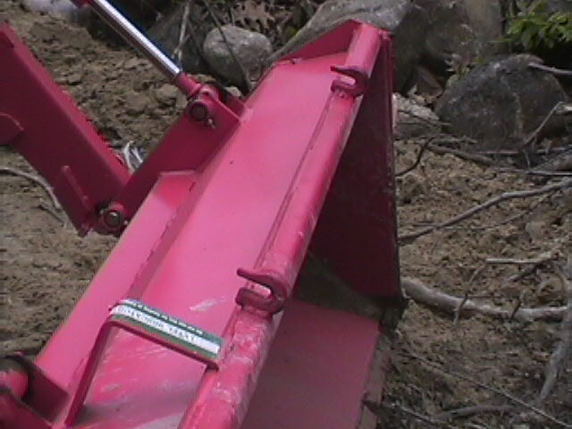

REMI,
I have a 3010HST and have a 66" bucket. I have used it for extensive digging and rock hauling. No dents or bends in the bucket. I also have hooks on the top with a welded brace. Good luck
