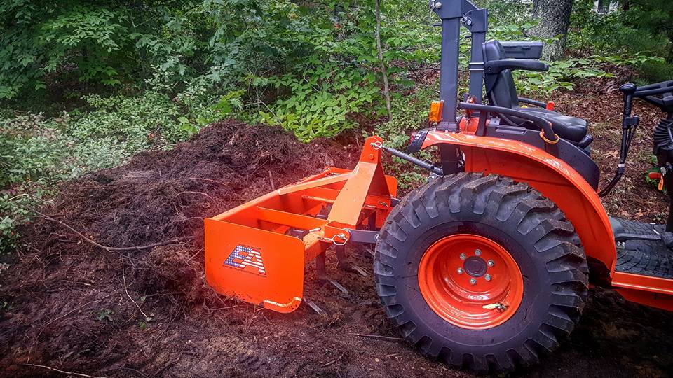

I would not put a land pride 12 series blade on any 40+ hp tractor. Our 2.1 Land Shark box blade is an enhanced/improved version of the land pride, and, even though ours is stronger, we still chose not to make them above 60" because of the bolted hitch design.
My ultimate pick for a 30-40 horsepower L Series(or comparable) tractor is our EA Xtreme 30-70 Box Blade.
More goes into our box blades than meets the eye, substantially more if you really take a close look.
The side plates, hitch and other components are tabbed by the laser. Benefits include precise, uniform assembly and extra, Xtreme durability compared to something that is only welded. The edges are also smooth and rounded rather than sharp and jagged like many economy models.
The side plates normally reflect the age and use/abuse of a box blade. To minimize that wear and increase the life span, we weld extra plates of steel to the front leading edges.
Our hitches, from the lightest to the heaviest, are all solid welded. Yes, it's easy to stack and cheaper to ship a square box with no hitch sticking up in the way, but we feel that a solid welded hitch provides more rigidity and durability.
All EA box blades have horseshoe shaped plates welded behind the bottom of the ripper shanks to strengthen the tube and prevent piercing.
The minimum grade of steel found in our factory is A572 Grade 50, which has a higher tensile strength, shear strength and yield strength than most commonly used A36.
Just a few things that we do to provide you the most for your money; more than you'd think! We've been using US cutting edges since the start!

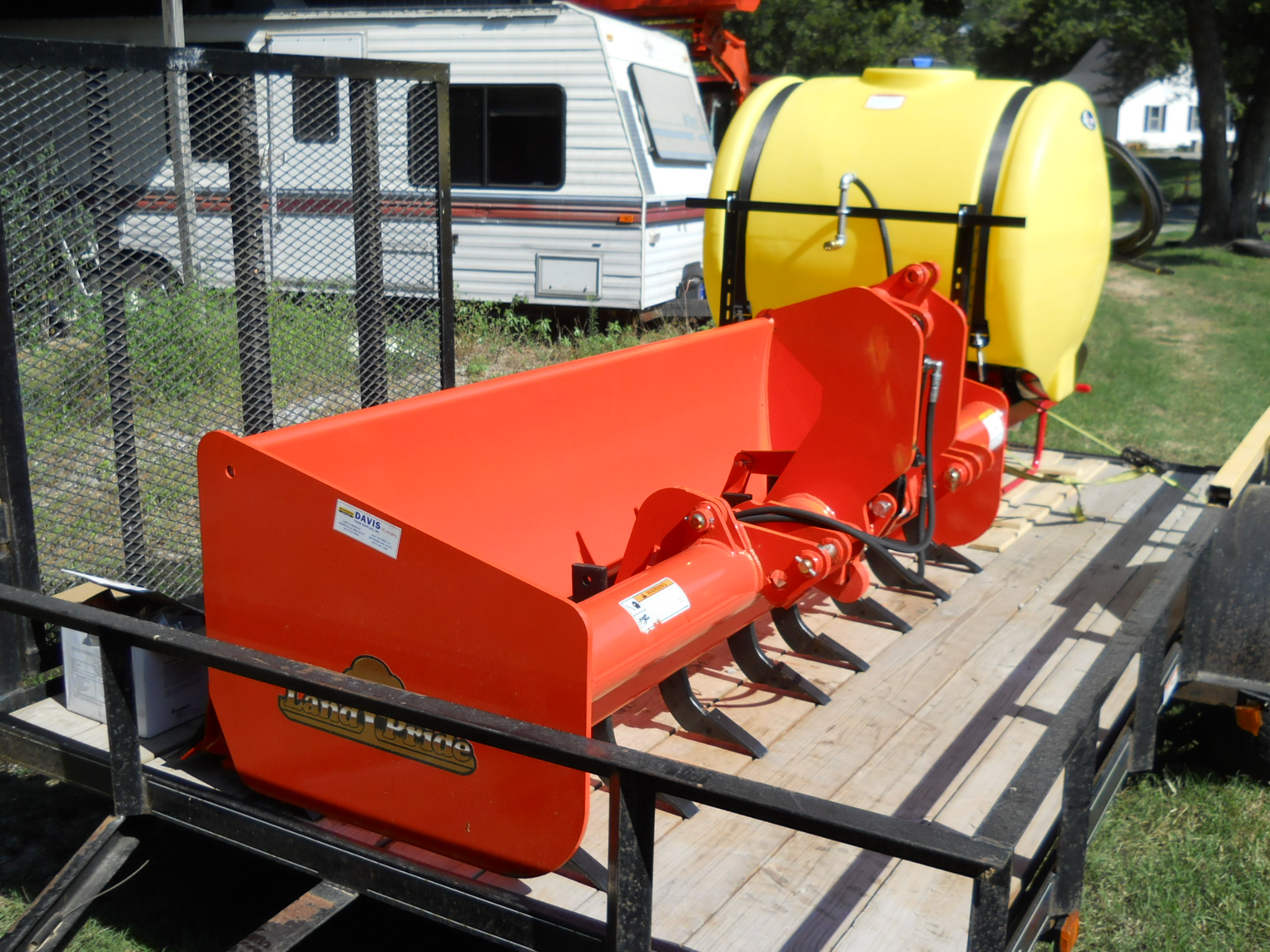

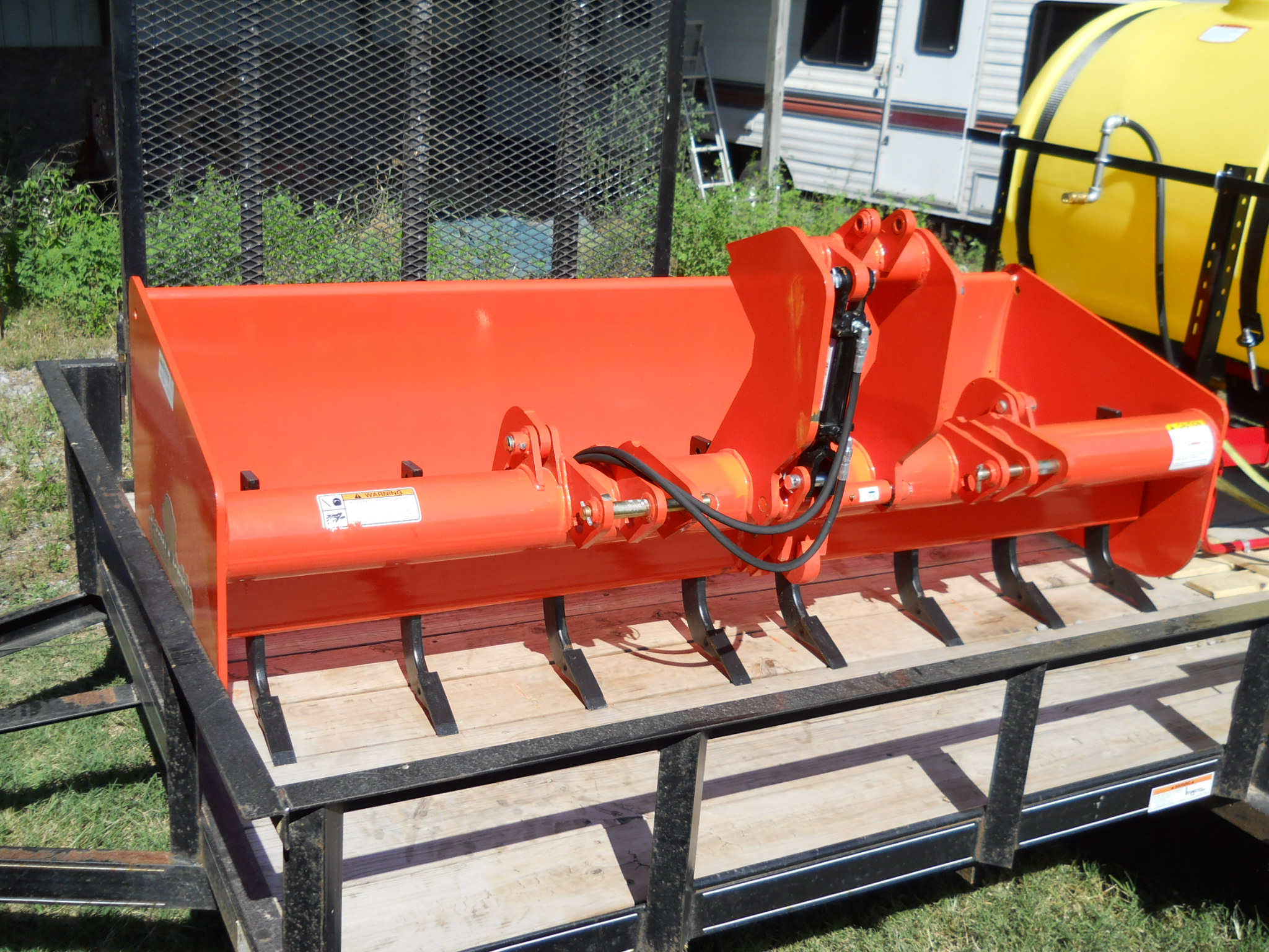

No way would I use a 12 Series on that size, I bought a BB2584 for my L5030HSTC and added weight and it was "OK". When I bought my L5740HSTC, I bought a LP HR3584; expensive but worth it for my uses. I do like LP, but sometimes the cost doesn't match what you get. I never bought anything from EA, but they have really good reputation.
You might consider a Roll Over Box Blade, several members use them.

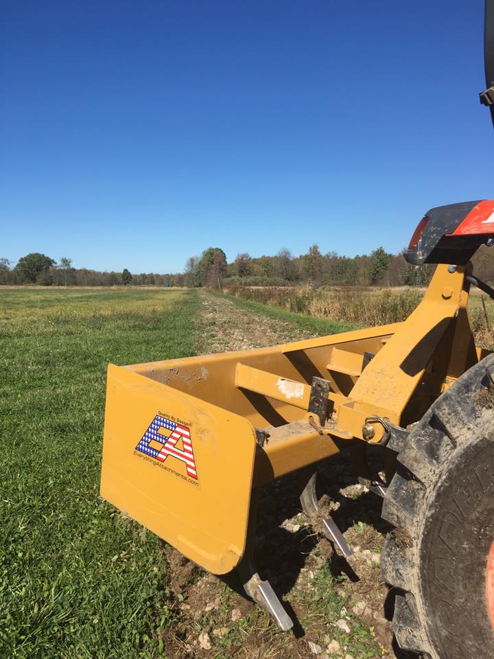

So FWIW I'm using a 72" Category I & II Severe XTreme Duty Tractor Box Blade - Everything Attachments on my L3560, and the only thing I've managed to bend is one of the ripper shanks (think it got caught on a very large root that caused it to bend a bit to the side). Fortunately those are easy to replace.
While overall it's been very useful implement there's been more than once I've considered selling it and buying the hinged-back version as (more than once) the fixed rear cutting edge has been the limiting factor on how much material I could remove in a single pass.
