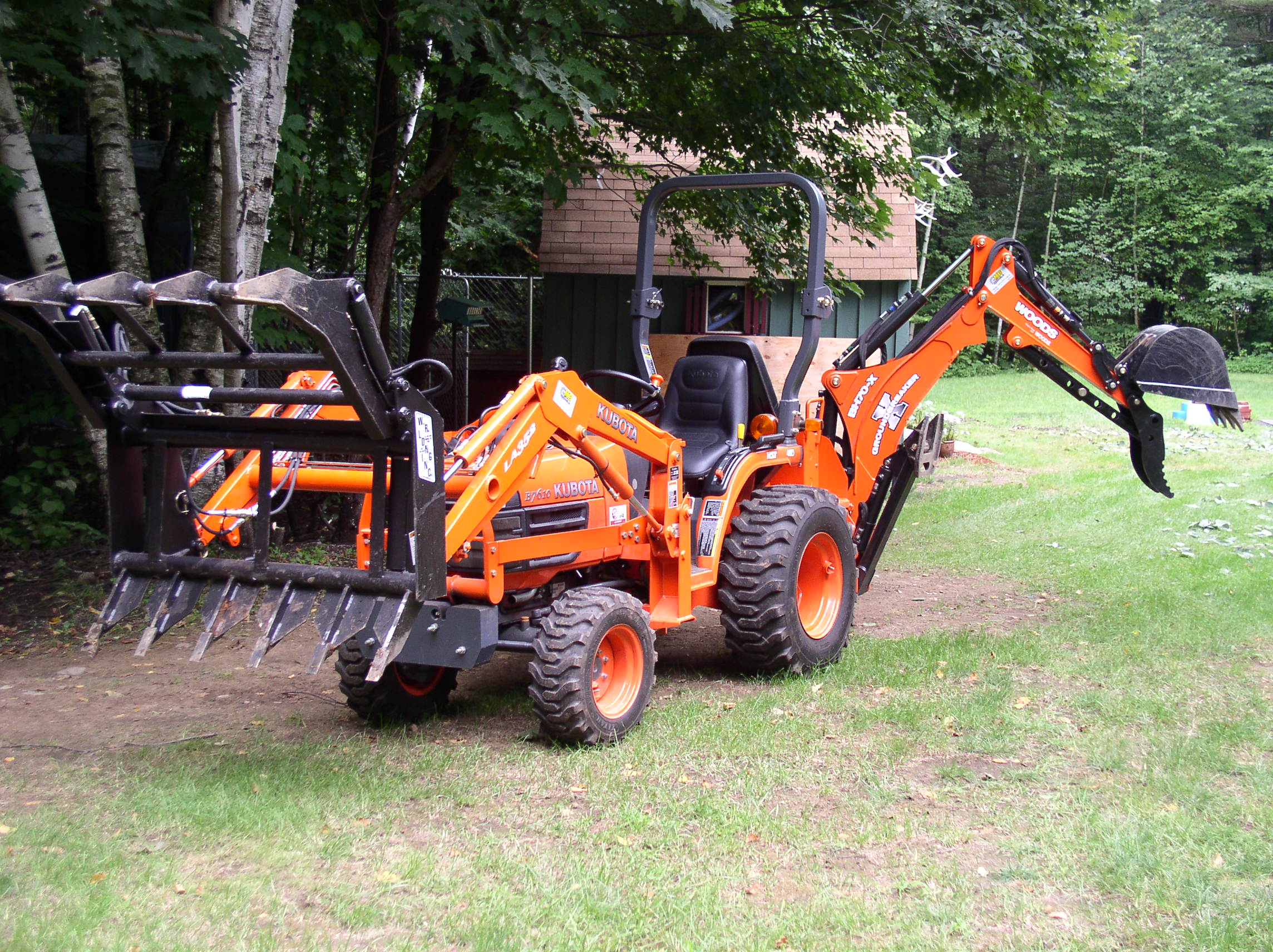

I have the woods 70X with thumb & I love it. I have the subframe package, and find the whole thing is very rugged. I can disconnect the hoe under 5 minutes and reconnect in about the same time frame.
The loop that Joel mentioned is exactly they way my kubota is set up. When the hoe is off, I just connect the lines to complete the circut. Hopefully, I attached a picture correctly.
