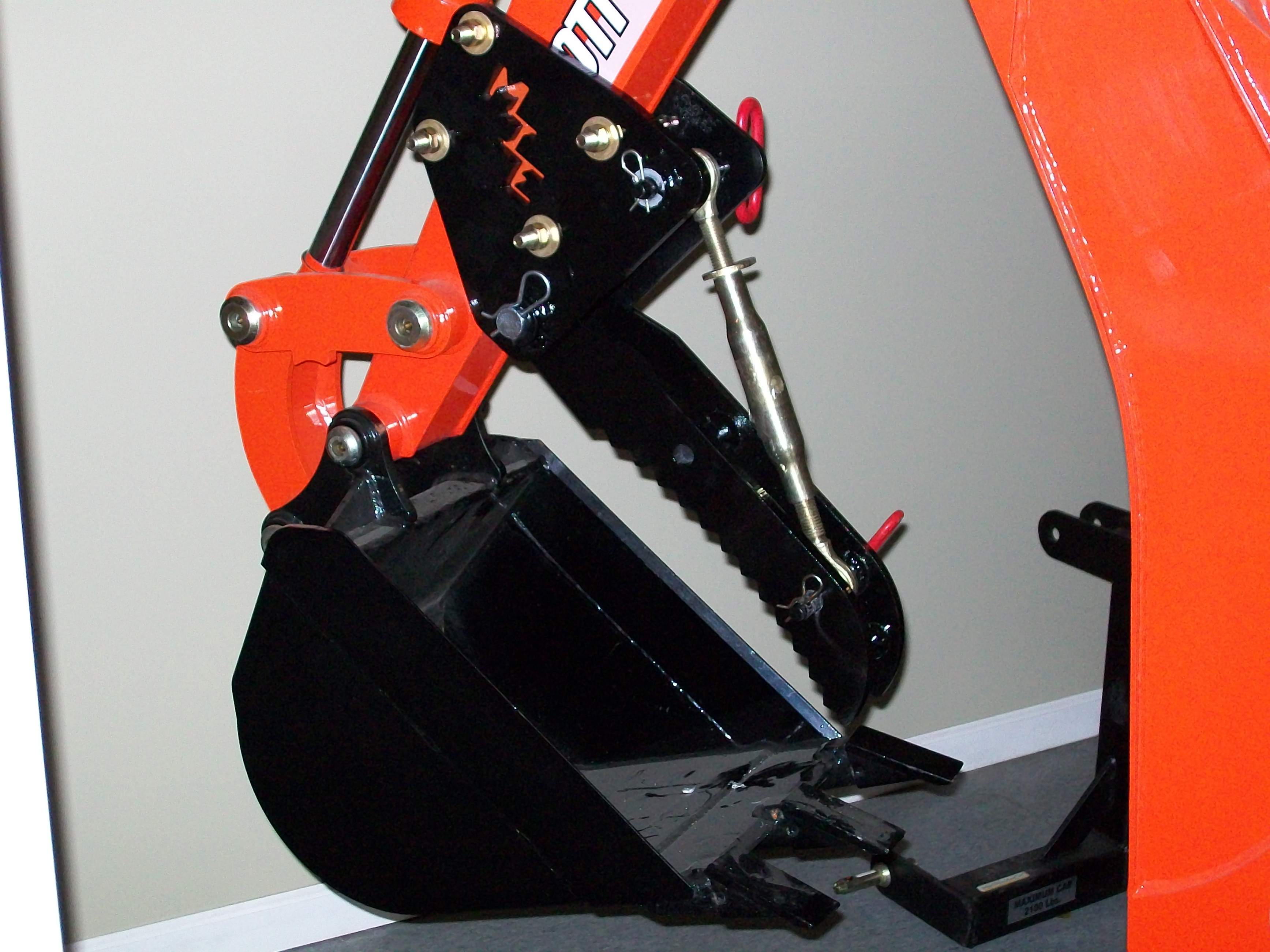

The bucket is a 12" with three teeth. Bought and wanted Kioti for warranty issues. Lack of power compaired to other hoes. More twisting and bending than others. Seat hits back of cab. This is weakest hoe I have owned,,,regardless the bucket binds half way thru a curl and you can see the "dogbones" rise and fall during the curl. Looked at pins all are fine. Now the pins fit the bucket "ears" fine but thru the dipperstick is way off. I took some pix that I can email to better explain. You can take the dipperstick bolt and move up and down two or three inches. Also stabs need to be reset every two or three scoops. 2000 hrs on two Kubotas and 1000 hrs on a Cub Cadet (mits) with Woods and only issues where busting hydr parts. 25hrs on Kioti

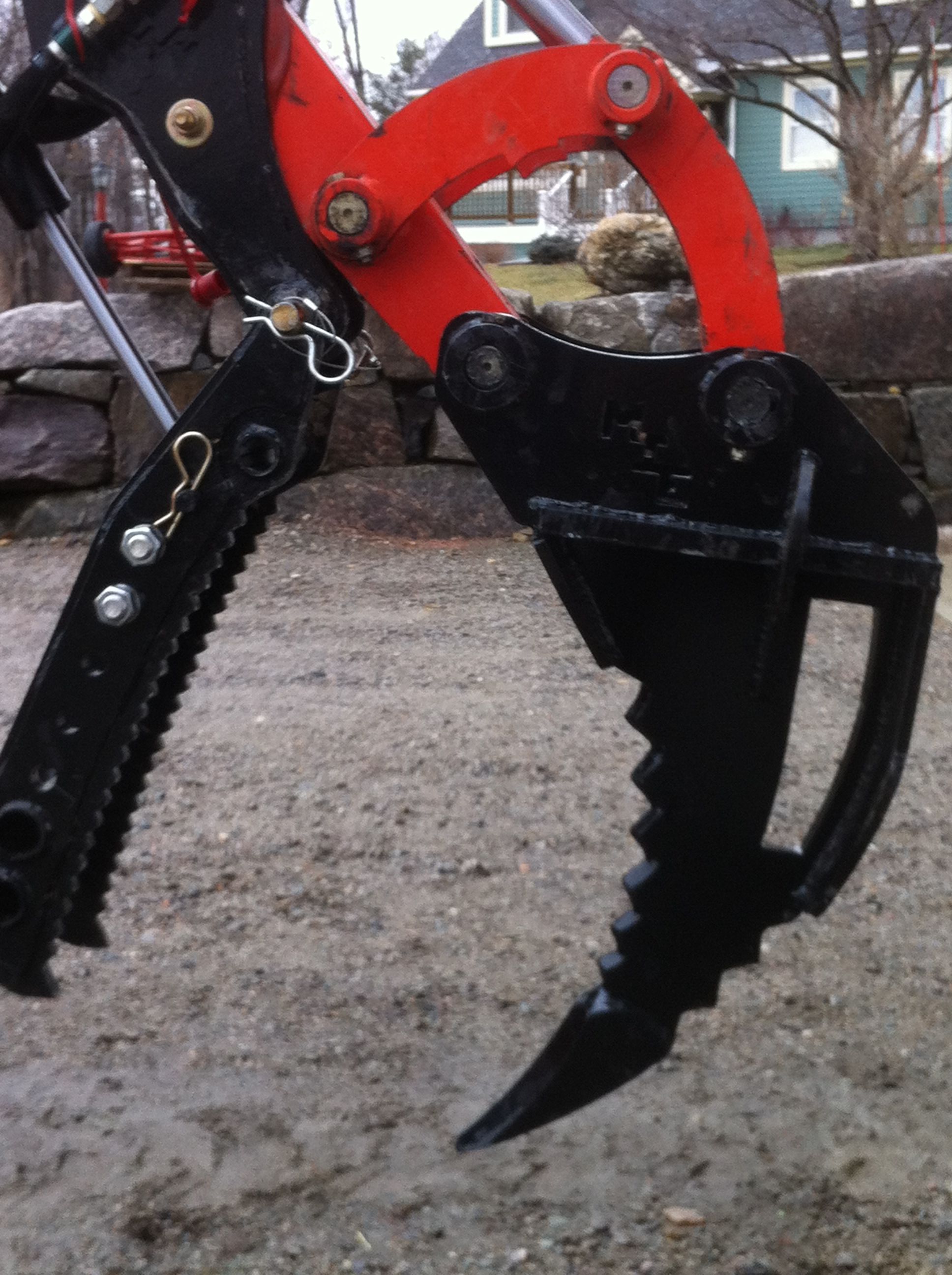

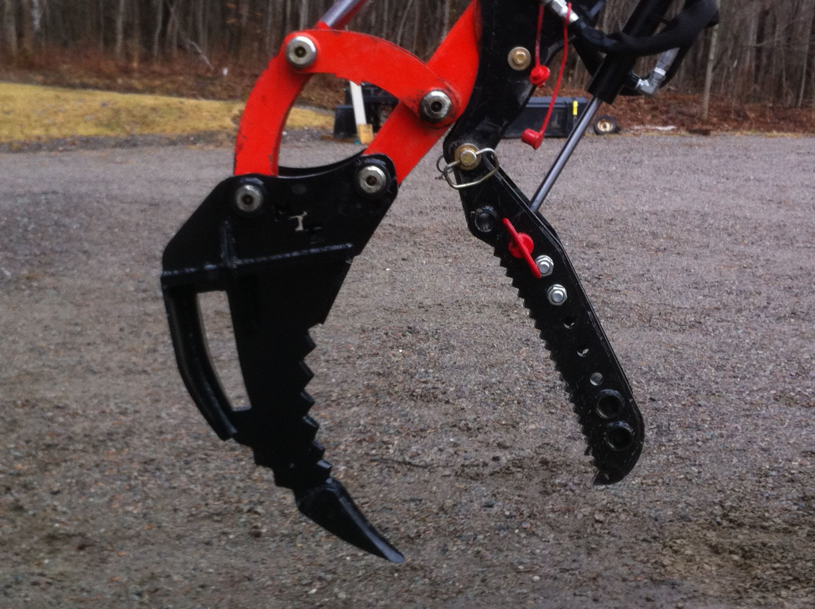

I have a hydraulic thumb and a custom designed ripper tooth I call the 'claw' for ripping out tree roots and stump removal.
Here are just some I found quickly, possibly of interest to you.
First is actually a pic from the supplier of the thumb and "claw", MIE, ( Michigan Iron /Equipment)... A 2485- with 3 tooth like your bucket, yes?
Next two are on my hoe.
To add pics, if they are on the computer you're using, just go to the "+ reply to thread", (NOT QUICK REPLY) button on the left bottom of the section of the page where you want to post them, and a box will pop up with a toolbar in near left and with a paperclip. Click on the paperclip and go to what you want to attach.
