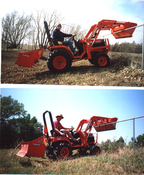

Tileman is probably better off with the 7500 but just for arguments sake here is a pic (again--yes--sorry) comapring the lift height of the 2410 to the BX2200. It speaks for itself. The BX seems--to me--to have very slightly less lift and slightly more reach--in the pic the 2410 is agaisnt the fence, the BX is back off it about half a foot. Notice the BX bucket is farther beyond the top bar. Neither tractor if I remember correctly is quite at max lift. In this contest I fear the BX wins again or you can call it a draw if you insist but now put the MMM on each, the BX will turn inside the 2410 and in that contest the BX kicks 2410 behind. Another oddity--when mowing, the 2410 outside wheel gets outside the deck, on the BX the outside edge of the deck appears to be the furtherest outside point which allows closer trimming---maybe it is an illusion. J

You're right!! BX lifts higher with less load than the 7500 and the 2410, but only by a slight margin - 69.5 - 71.3". However the B21 is 88"+ whihc when loading a F350 with 4WD and side boards its probably close to being max height for the BX and 7500. I have loaded a few trucks as well containers, and like to have a little margin for ground levels etc.
BTW do you just have photos to pull from? To show such a comparison takes some time, and is that appears to be a 4' fence?
I agree the 7500 (or the B21) is a good choice for the task at hand, and after looking at the BX series the other day - its a rugged unit tho lacks ground clearance - probably the biggest factor when working in stumps and rocks that we have in NH.
Carl
   / Which "B" to get? #7
Re: Which
Yep, your numbers match mine except my LA352 has a 50 inch bucket. Yes, and a even bigger tractor can lift even more--there is the buy bigger than you need and the buy what you really need philosophy. Each to their own in this regard. I favor as small as I can get away with not as large as I can make do with--a subtle but significant difference.
I am not sure I follow you in your question regarding pics--time? Got a scanner sitting right here if that is what you are asking and I almost always have a camera nearby--a UFO might land!!!!!!
Oh, yes, that is a 4 foot fence. J
