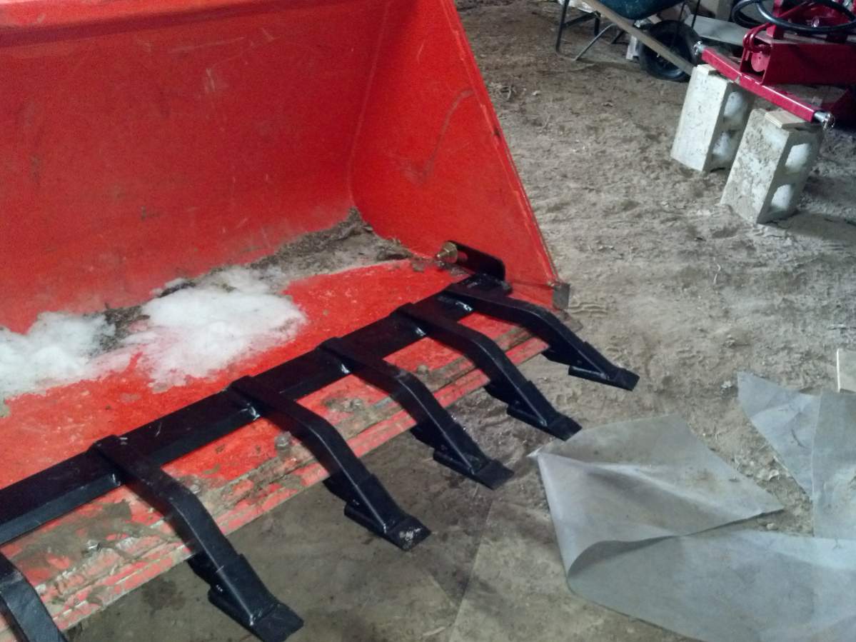

Even making one cost me about half what a Piranha costs. I used bar steel, and German forged harvester teeth I found at a farm auction. Then the plow bolts, etc. Well, maybe not half, but if my labor had value... You'll find lots of posts on toothbars, and lots of potential sources. Measure twice, order once. If you have a smallish tractor, they will definitely help with digging and tearing up ground.

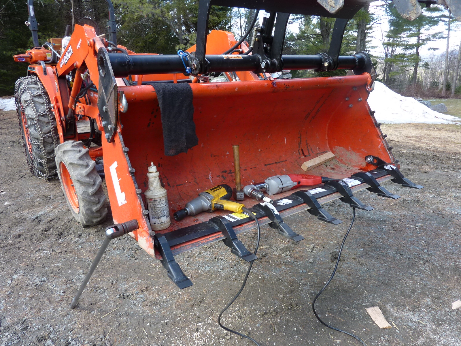

I got a 60" Piranha Tooth bar from BXpanded. I've done some crazy stuff with it and haven't hurt it yet. Give Harry a call and see what he says.
