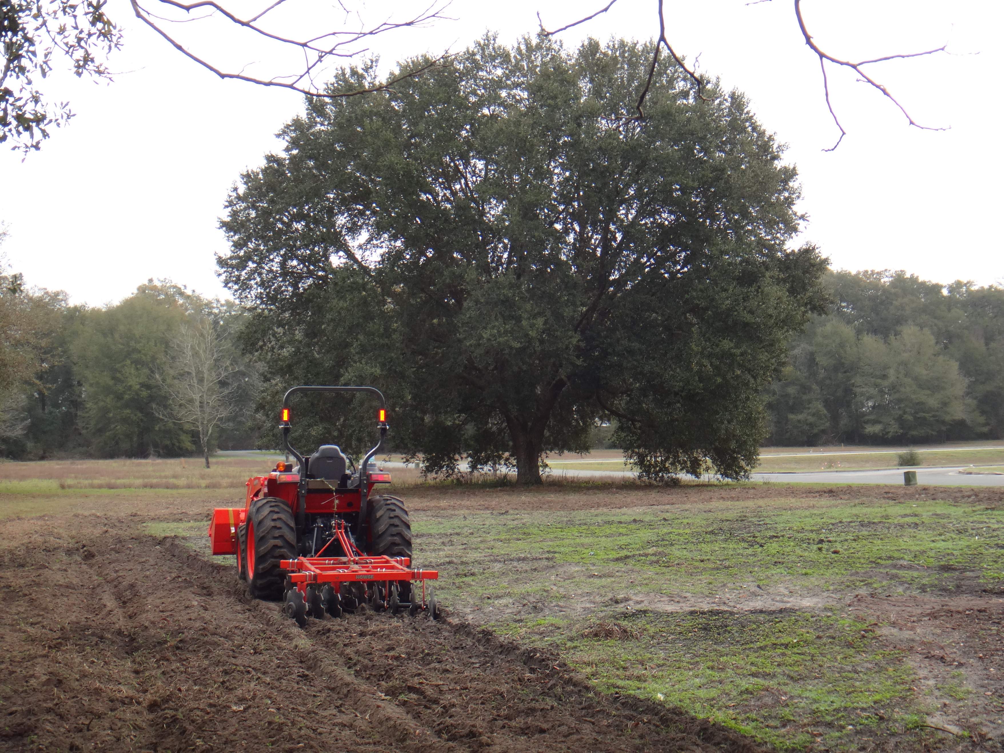

I worked our large garden with a Kubota L3130(2004 model) that was 4 wheel drive,31 H.P.,HST transmission
R1 tires and front end loader.Perfect tool for the job.Not too wide,infinite ground speed with the HST and plenty of power for a two bottom plow,roto-tiller ect.

I worked our large garden with a Kubota L3130 (2004 model) that was 4 wheel drive, 31 H.P., HST transmission, R1 tires and front end loader. Perfect tool for the job. Not too wide, infinite ground speed with the HST and plenty of power for a two bottom plow, roto-tiller etc.
