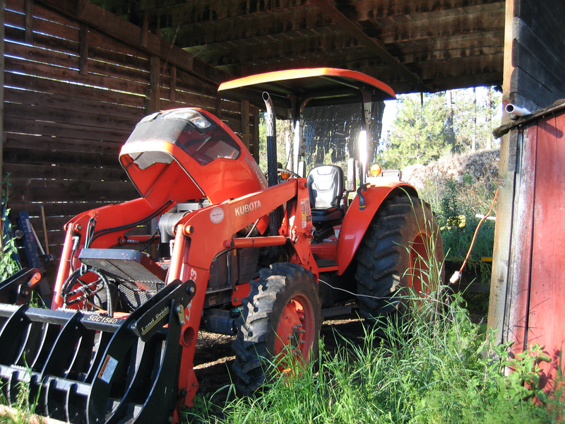

I have the connections that came with my Battery Tender. From the battery out the front with the standard two prong plug. I always have the hood open when the tractor is in the carport stall - mice/chipmunks. I plug the Tender in and set it on the front tire. In this photo I have the Tender sitting on the back side of the grill guard. I now set it on the top of the front tire - a whole lot easier.
