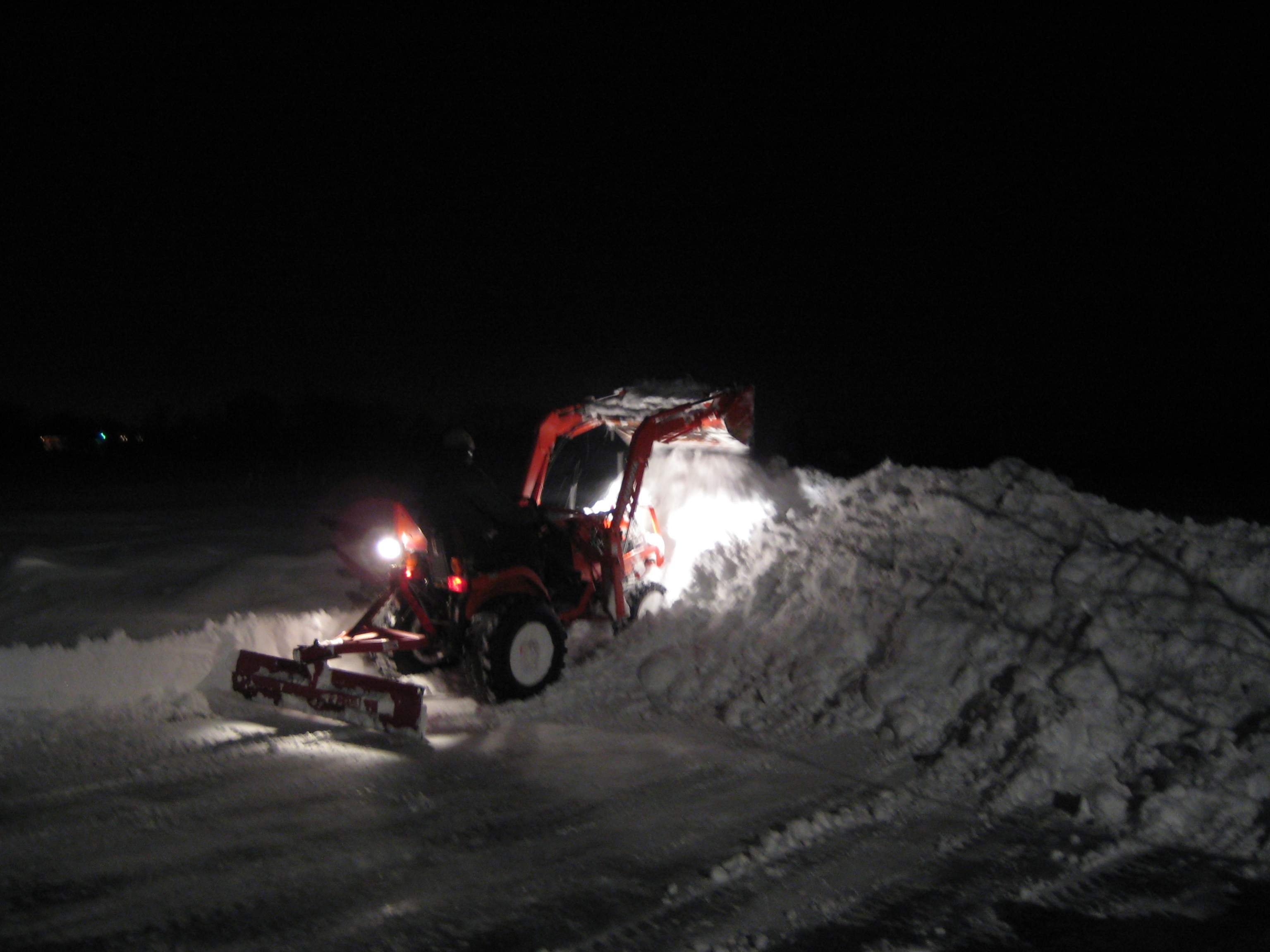

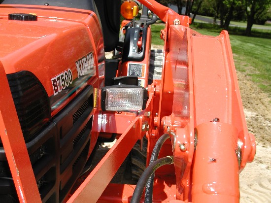

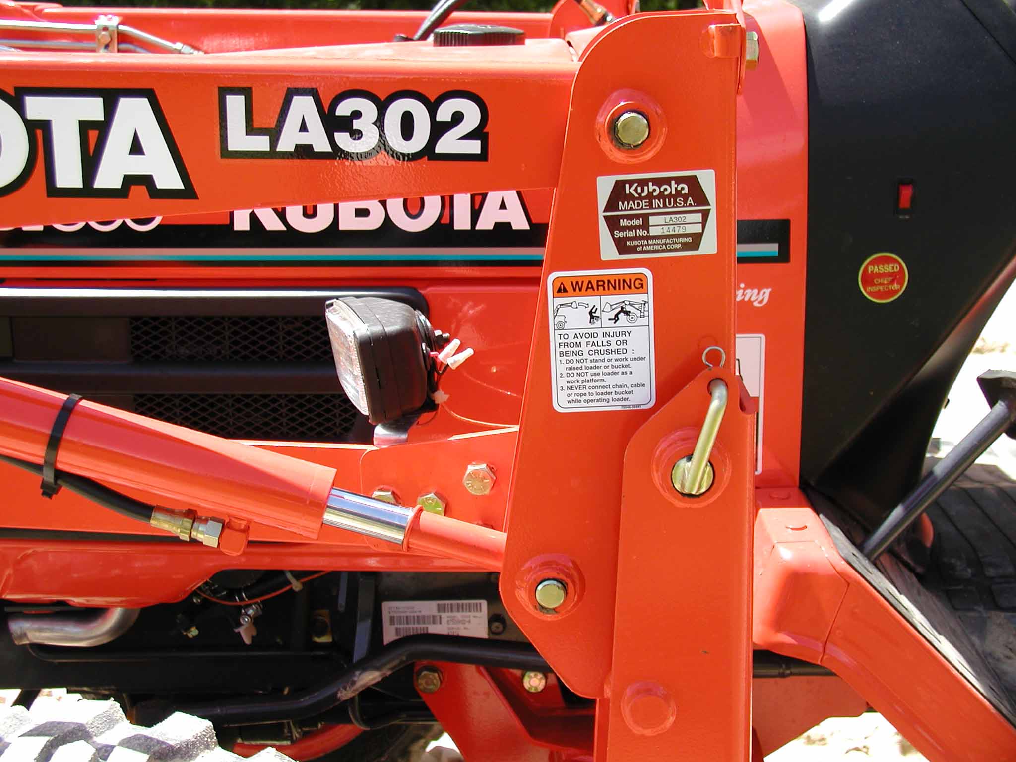

/ Where to mount lights? #6
Here's where I had them on my B7500. It looks like there should have been a dark spot in front of the tractor but they worked great. The best pic I could find of them working is this one with #3 Son clearing the driveway.

/ Where to mount lights? #7
I put two sets of incredibly bright LED's on the top of the ROPS, two facing forward and two facing rearward for the winter snow blower. I mounted a switch box with two toggles on the reflector triangle and they work great.
Thanks for the suggestions. I making a mount that attaches to the FEL frame in front of the grill that will put the light above the hood, and adding another light that will shine behind the tractor.
