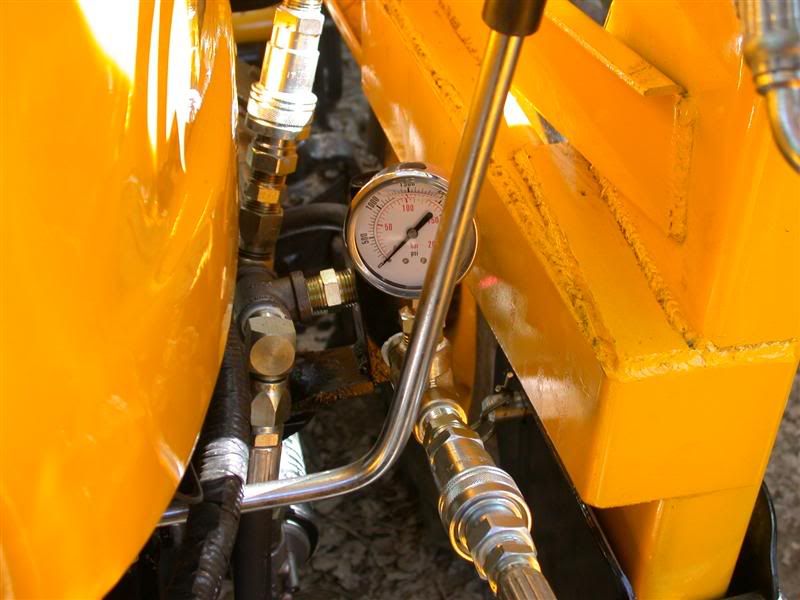

My question is does your pump have it's own relief valve separate from the working valves such as your fel or rear remote valve? Otherwise you are setting the pressure relief for the valve you are working.
For example, my Chinese tractor does not have it's own pressure relief valve built in. I could dead head the pump and destroy it if it wasn't connected to some other valve which has a PRV on it. So I installed a relief valve right after the pump on the high pressure line out of it. I then installed a gauge coming out of that relief valve. The gauge is plumbed into my system now. My manual tells me the maximum pressure for the pump so I set THAT relief valve to right at the maximum pressure. Now I know my pump will make maximum psi but not more that what the main PRV is set for.
Then I used the same gauge to set all the other valves in the system by operating that valve and setting it's own pressure relief. I set the other valves at 50psi below the Main pressure relief valve for safety reasons. In fact, I don't even need to do that now since the system has a Main pressure relief valve which would relieve if the pressure started to build up over it. But I set the other valves slightly lower to avoid any possible problems in case the Main relief valve ever fails, OR in case my wife forgets to reconnect the hydraulic lines if they have been disconnected.:)
