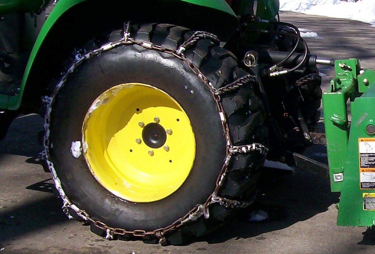

Take some measurements, and order the bulk chain -- side chain, cross chains, fasteners, and make a set. :)
Then they will be a perfect fit.
Can we order the bulk chain from their site or just go ahead and order the parts locally?
   / where to find tire chains for 770, 16.6x16 tires #7
Yes...to both questions. Local truck supplier is where I purchased my bulk chain.
