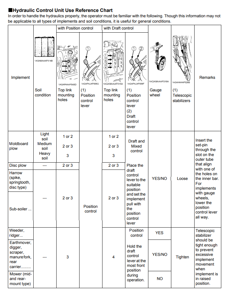

Good morning...second post about mowing, but hopefully this is quick.
In the manual, it says to connect a mower top link to position 3 on the 3PT. The dealer had it connected to position 1. Does it matter?
Thanks

Thanks for the feedback. I was reading over the manual and there's a chart where they mention the different types of implements and position/draft control configurations. Just wanted to make sure it wasn't setup incorrectly or could cause an issue down the road.
Hydraulic Control Unit Use Reference Chart (in the 3Pt section)
In order to handle the hydraulics properly, the operator must be familiar with the following. Though this information may not
be applicable to all types of implements and soil conditions, it is useful for general conditions.
see attached
