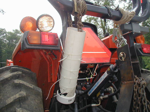

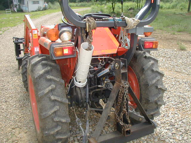

After many hours of thought and research, found the perfect place to put a piece of Schedule 40 PVC with a cap on the bottom. Piece is 24" long and the ties are temp, going to get large hose clamps. No drilling into the Rops.
May put another on the other side for ????????

Right on!! I have put PVC holders of similar construction into the rear of my tractor.... attached to a small platform on the rear... there is an extra bolt hole there. Also, there are holes in the FEL and all of them have PVC pipes in them with chains in them... can't have too many chains...
Yep, you will soon put one on the other side... handy to have.

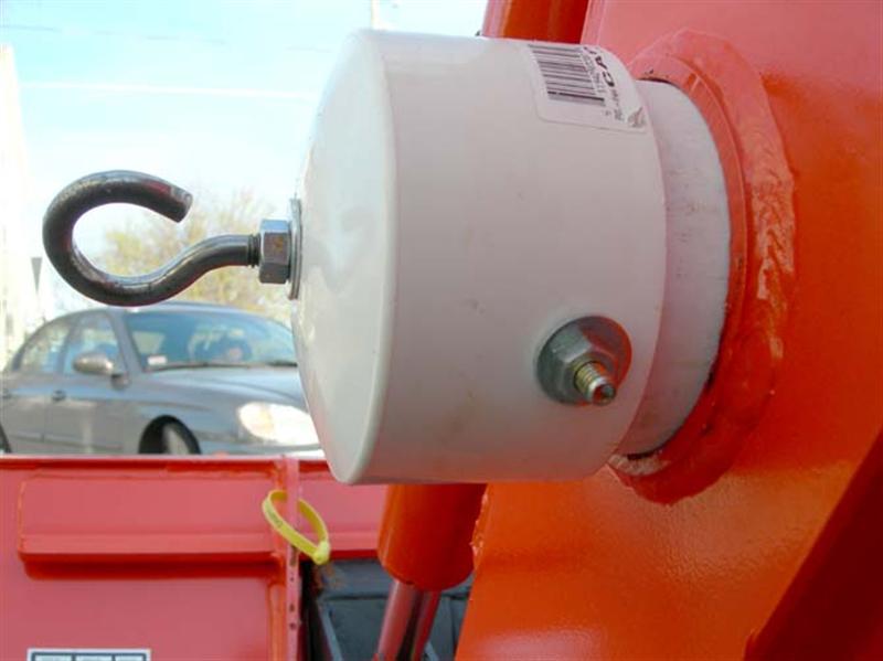

PVC is great stuff. Here's a couple on mine, the chain box is a piece of leftover railing post I have one on both sides next to it is my fire extinguisher holder
the second is a 5' piece of 4" run thru the loader brace this holds a 60" prybar & chain

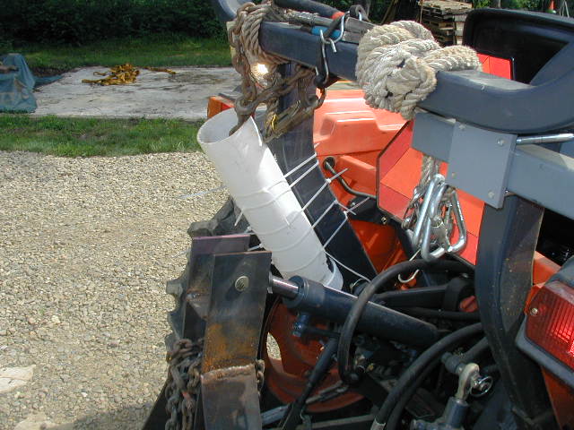

I use a rubber strap to keep the basic's (channel locks, hammer, and drift to remove bucket pins) on the ROPS. Lokkat my pics. Drill a small hole in the cap so water can drain out.

I drilled a 1/2" hole in the center for drainage put it in place drilled & pop riveted the four sides.
I never thought to glue it, I have a life long habit that applies to almost everything I do "What if I have to take it apart?" so I always leave myself even though it doesn't always make sense.
