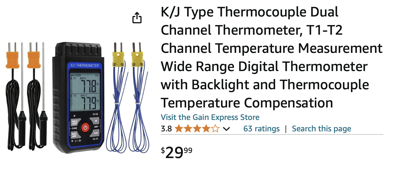

My hydraulic temperature gauge is a Amazon thermocouple taped to the hydraulic hose and covered with a wad of insulation. The handheld readout sits in a coffee cup holder when I'm curious, but it usually lives in the toolbox. $29.00 complete.
The pressure gauge is older & permanent. Amazon sells a complete kit with extra types of adapters for under $100... but I didn't need the complexity. Mine is just an appropriately threaded T threaded directly to the control valve input, and supporting a glycerin-filled 1/8" NPT 5000 psi stainless steel 2" gauge. The T is hydraulic spec, not the plumber's type. Cost of the whole setup was uder $30.
Here is the hydraulic temperature gauge I used:
