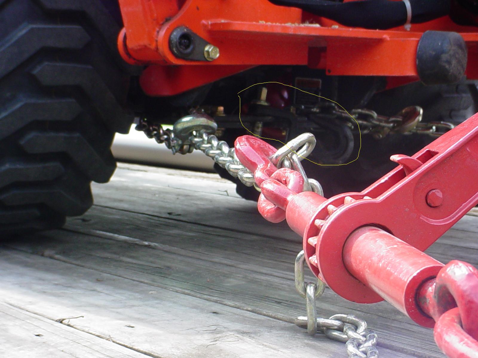

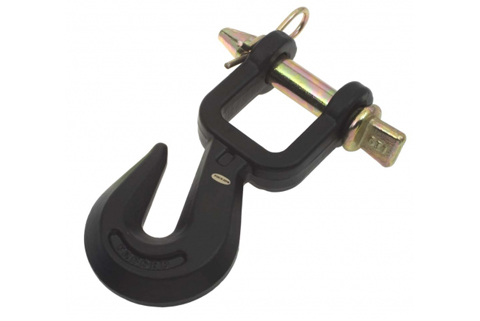

I have a grab hook in the drawbar - since it sticks out a bit and swivels, it is pretty easy to access from the side of the back hoe. Use it frequently with my 4x8 chain harrow and when skidding logs

I have no problem accessing the drawbar with the BH on.
