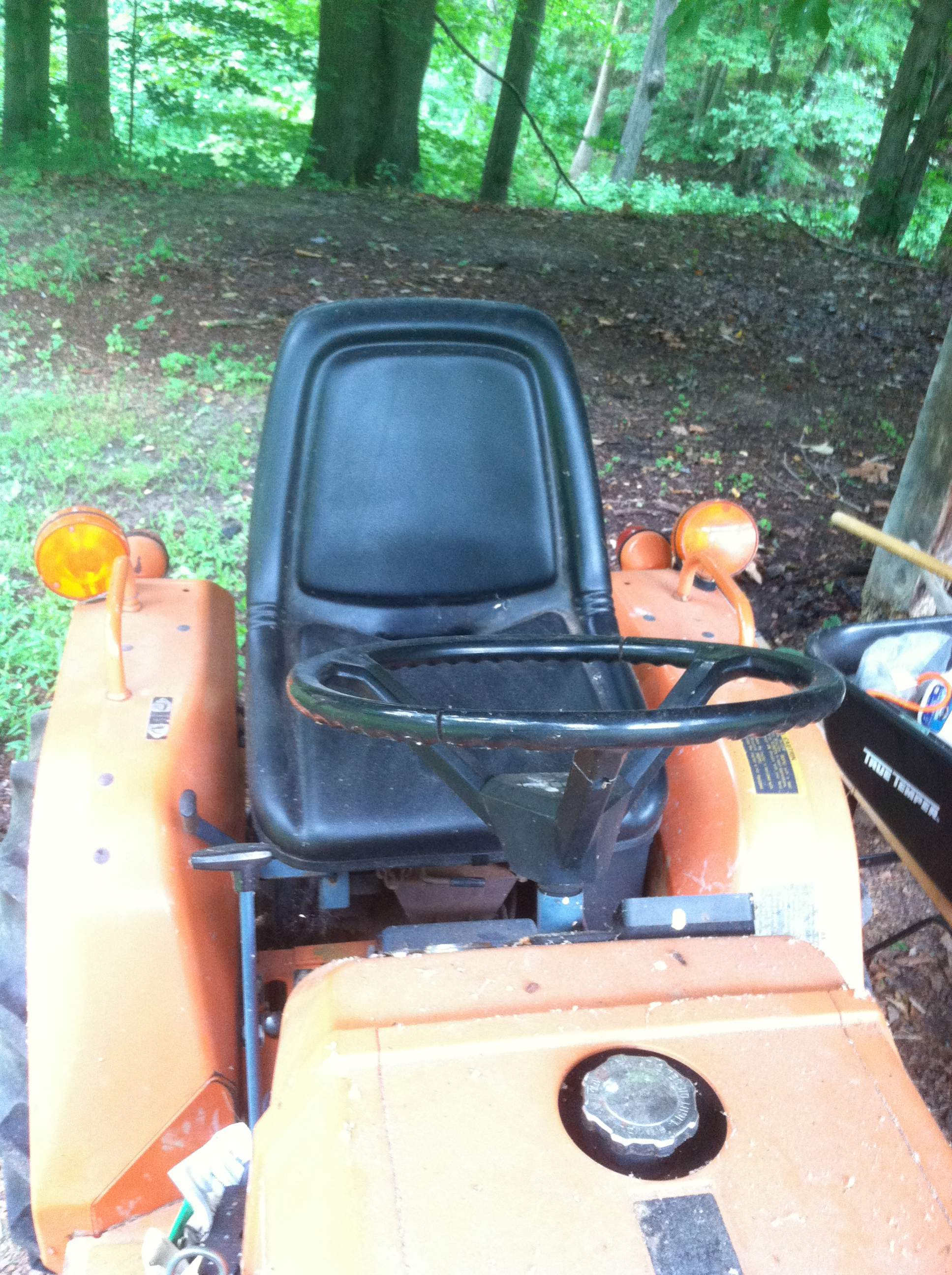

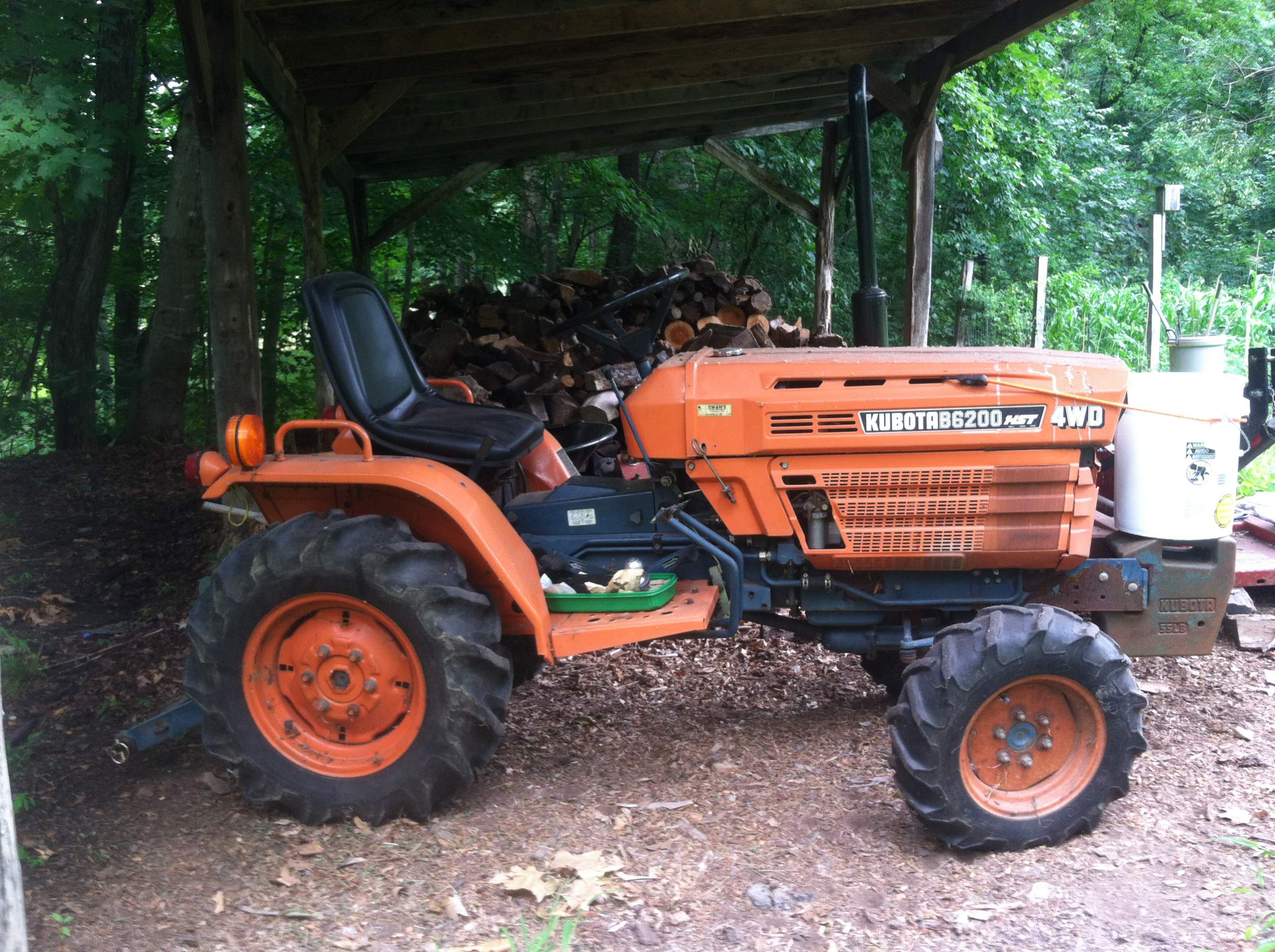

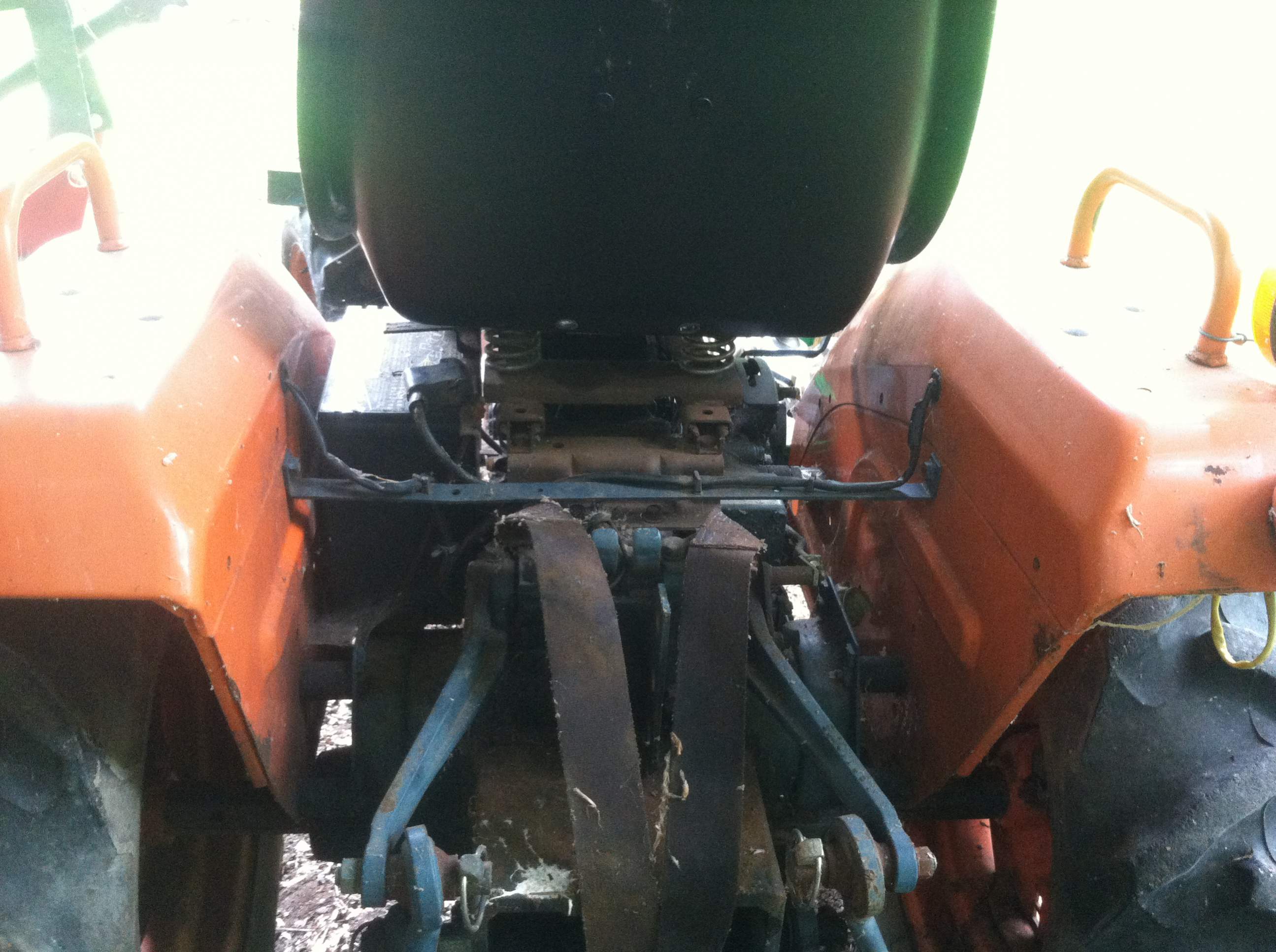

Kubota B6200 HST 4WD: Mine does not have a ROPS and I may want to add one, but looking at the machine I am not sure where it would mount. I think I have seen pics of the tractor with a ROPS but none are detailed pics to help with my question. Any ideas?
I can add more pics if needed, and btw I wanted a bucket on my little tractor so I added one ... :) It's actually a great way to haul a chain, tools, etc. and adds a little weight.

Three suppliers (including Kubota) have retrofit ROPS kits for B6200s -- ROPS. A supplier should provide installation instructions for its kit.

Appreciate the links! Looks like I need to contact them bc they do not have info listed on my model.

Kubota has a program to supply ROPS and seatbelts for older tractors - it lists one for the B6200 for $148. I've bought them for other early models and they are complete with attaching hardware and instructions etc. A very low price for what you get.
   / Where to add ROPS on this tractor?
oh wow, that's more than affordable for the benefit- will check it out! Thanks!
