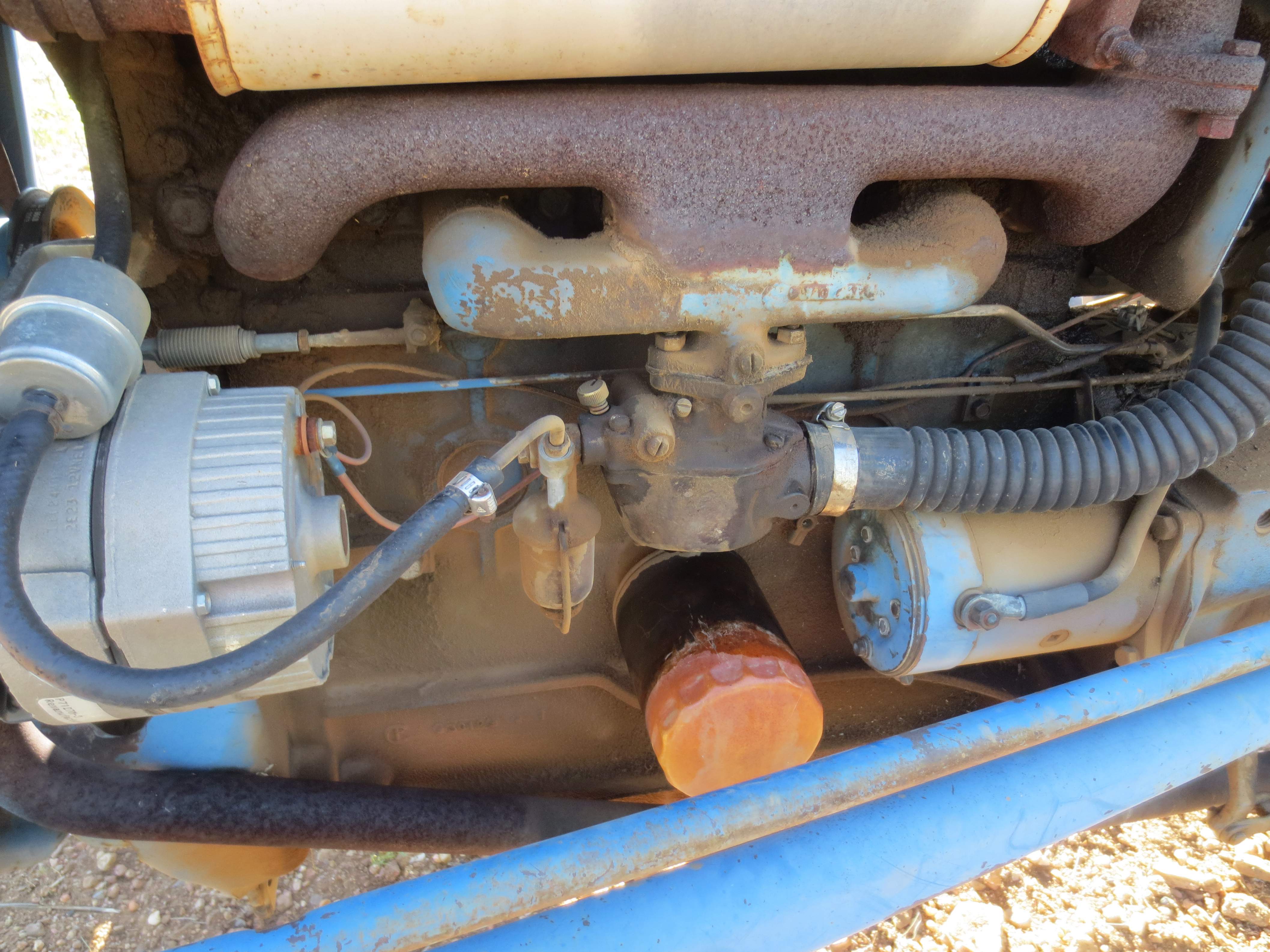

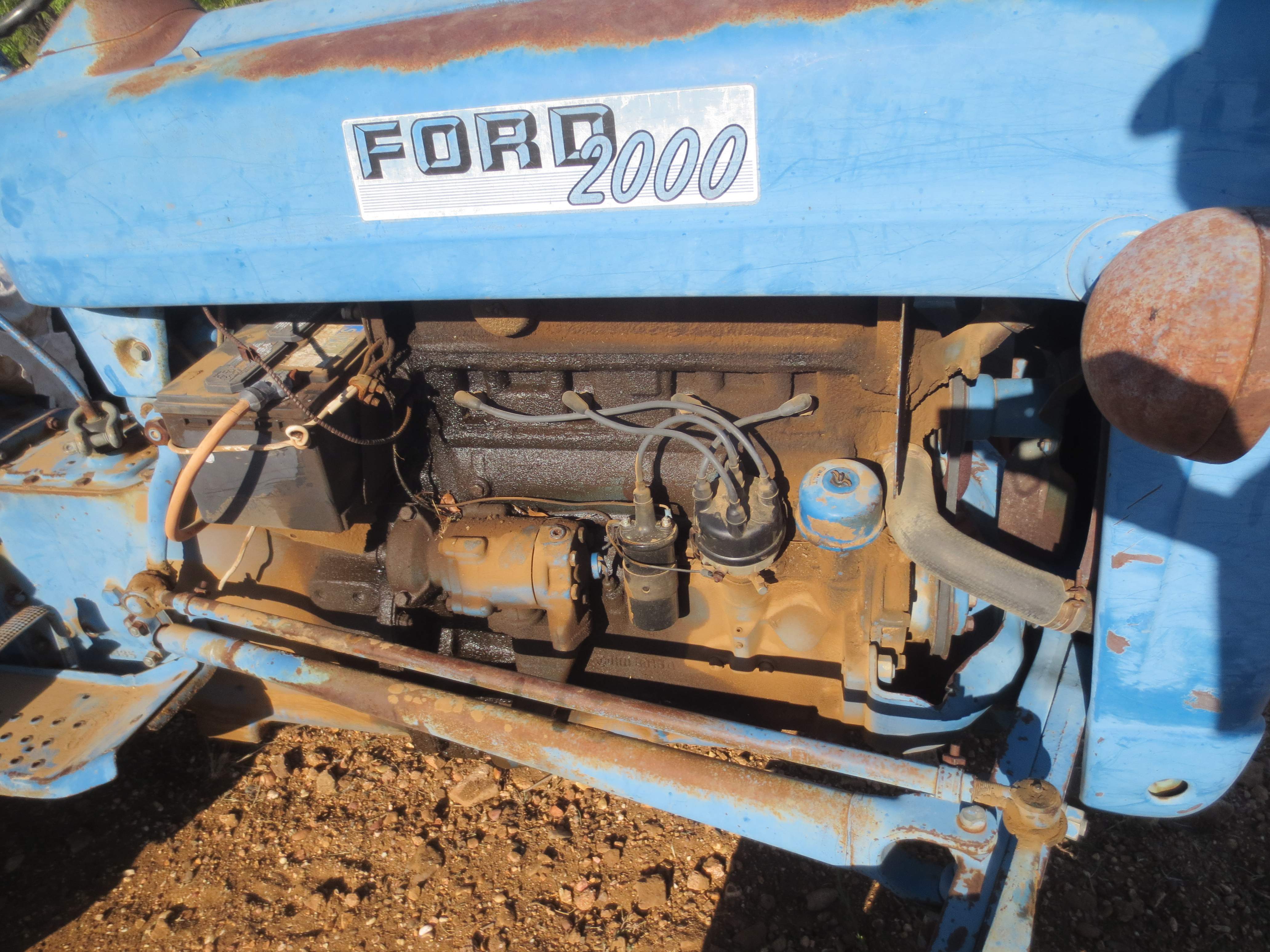

Can anyone tell me where do you add engine oil in a ford 2000 tractor? I think it is a 1962 year?
I included some pics in hopes someone can maybe circle the area that I should be focusing on.
Thanks so much!

Fill tube is just ahead of the distributor, remove the cap with the wing nut.
