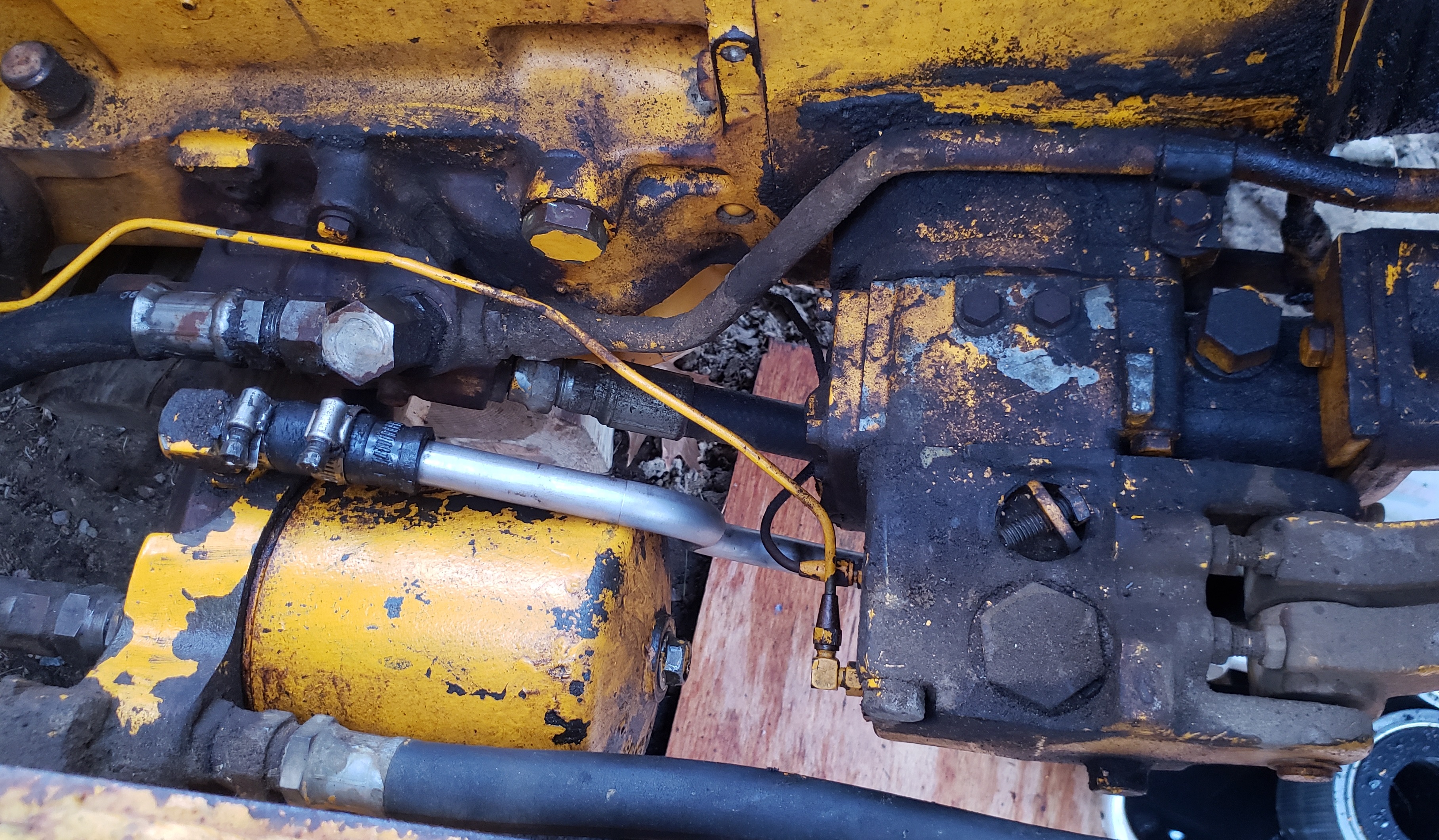

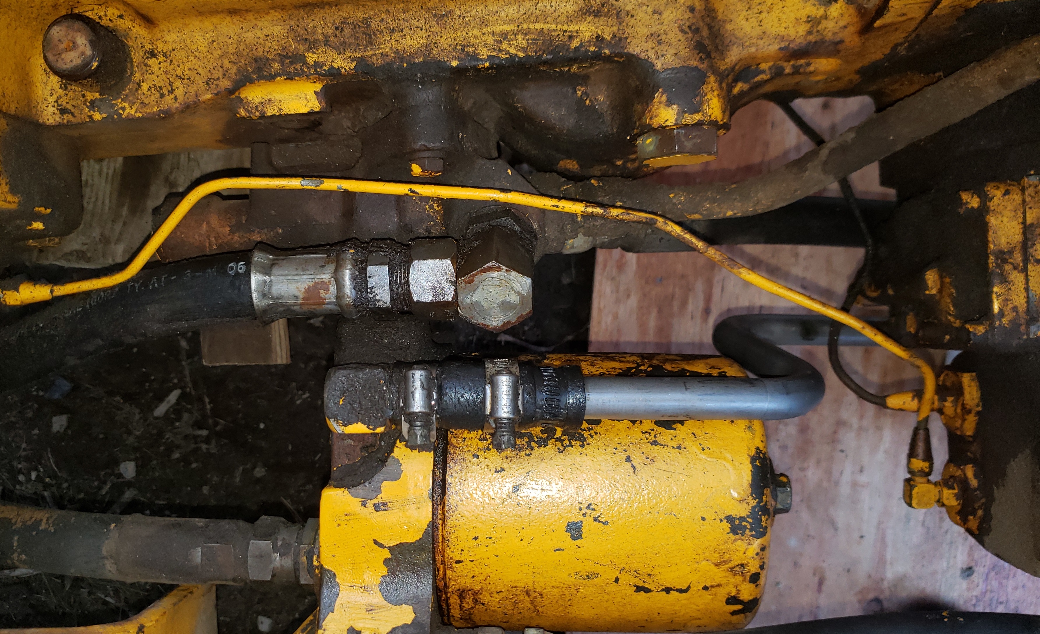

I am going through and changing the hydraulic fluid and all filters. I have bought the filter screen but can not figure out where it is located.
I took of the left side food board and took off one plug but it wasnt it and I cant see any other place where it would go

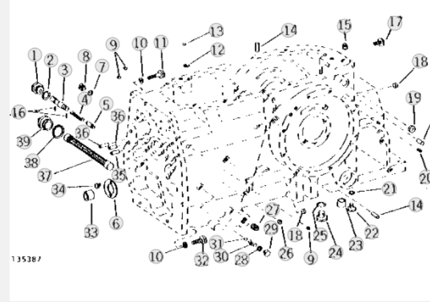

In the drawing key 37 is the screen
   / Where is transmission filter screen
Yes I see that its #37 but I haven't found it on the tractor

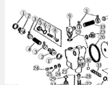

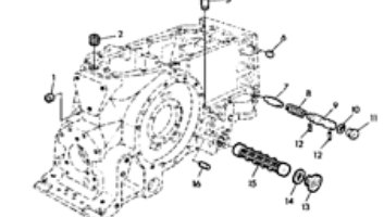

   / Where is transmission filter screen #4
Here a photo with a different view of screen location.

Quite often the suction line going to the suction filter will be drawing from the screen,
the connection of your suction line to the case could be your screen.
On some tractors the screen is held in place by a cap on the opposite side of the suction line.

So is it located behind the transmission filter next to the hydraulic oil filter?
   / Where is transmission filter screen #8
Yes I forgot industrial model tractors have 1 more hyd filter than ag tractors.

Are those two pictures looking down from the top after removing the floor board?
I would expect the suction screen to be almost to the bottom of the sump,
just an inch or two up.
Yes I forgot industrial model tractors have 1 more hyd filter than ag tractors. One must loosen this bracket & remove hose(key 4)/fitting.
