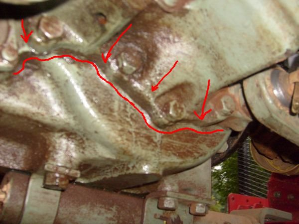

I noticed a small drip under the back end of my 1601d a couple months ago but couldn't find where it was coming from. Now that I've used the tractor a bit more (and used it in dusty conditions last weekend) I have a better idea, but I am still not completely sure. The leak is definitely worse now.
By looking at these pictures can anyone tell where this leak is likely coming from?

ok the next few were taken up under the tractor looking up at the left side of the rear end (axle?). they were taken from the middle of the tractor looking back.
this is also the left side, but looking forward from the rear
here is the right side for comparison
The tractor is still under warranty but the dealer needs to know where the leak is coming from before they will do anything (I live 4 hours away from them, so it's not practical to just load up and drive 8 hours round trip). They kindly offered to let someone local work on it if I can find out where this leak is coming from. I don't have heavy equipment or jacks to take apart a rear end.
I know there are two, the drive shaft seal (the first two pics) is clear, but the leak in the back is giving me fits.

I see oil around that drain plug ?. But, It's hard to tell without looking under the tractor & watching for the drip

It almost looks like the leak is where those two pieces join (see attached).

   / Where is this leak coming from? #8
You might try checking the torque on those bolts. If that is where the leak is they may not be torqued evenly. Of course leaks are extremely difficult to pinpoint. Another thing to try is to clean it good and put some dye in the fluid and see if that helps you find the leak.
That looks like where the rear axle housing meets the transmission / rearend. I had a small leak there once. Not a difficult repair. I drained the hyd. fluid,loosened all the bolts, seprated the axle housing from the trans. just enough to clean the area real good. I then applied high temp. silicone let set for about 1 hr . Reinstalled the bolts tightened everything up. No more leak

I agree that cleaning it up and running it good will help you pin-point the leak. I prefer to use brake clean when I am on a leak hunting mission. I would also like to add; one solid rule of thumb is oil tends to leak down. So look at or above the highest point you see oil. The only time you will see oil above the leak is if it is being blown around.
Most of the pictures are taken below the point where I would look for the leak.
