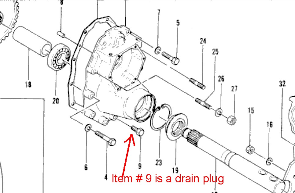

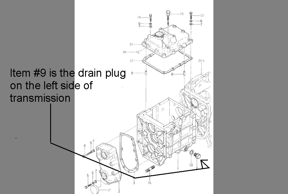

I just drained my rear end/hydro oil, manual says there are three drain plugs (without saying more) all I found were two drain plugs on each side of the pumpkin searched all under the trans/rear end.
Its an early model with the two cylinder engine if that matters...
Is there a third plug I missed?
   / Where is the third Hydro/rear end/pumpkin drain plug? Iseki TX1500F Boles G174 #2
Here are two shots from the parts manual.
One shows the drain plug on either axle housing
and there is one on the left side of transmission.

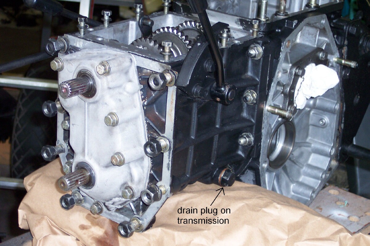

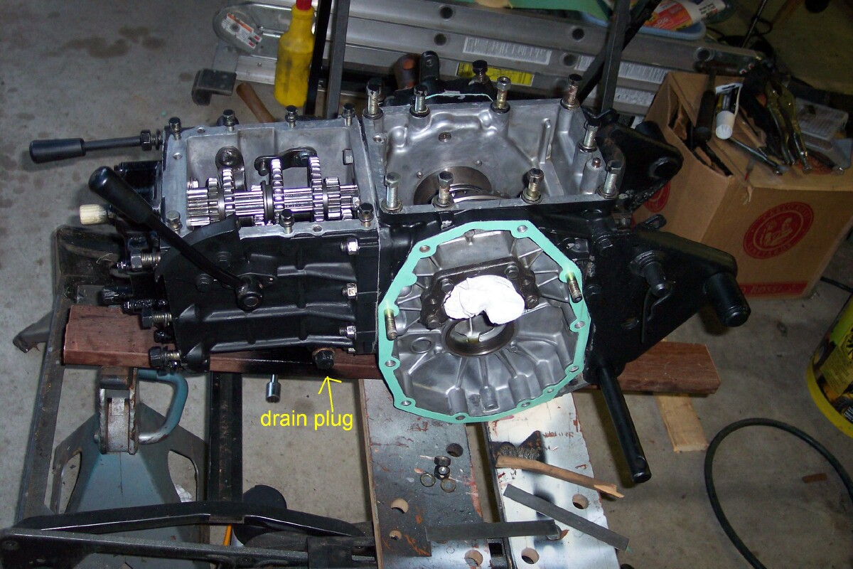

Here a few more pictures of my tx1300f.
Thanks much fxrs!!!!, due to my small garage I was on my creeper at the right side and did not see it. I am enjoying the story of your rebuild, only on page 7 right now.
