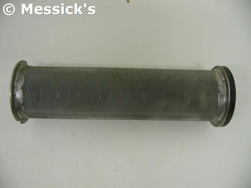

Thanks 5030 for the "young man" words - I've owned two L345's and one L355ss. The L345's have a dipstick but the L355 doesn't. My L355 did have a removable plug by the clutch pedal for checking level. To my knowledge neither machine has a magnet.
Both L345 and L355 have a fine suction strainer 37300-31270 before the pump - see pdf attached. When the oil is drained the strainer can be taken out for inspection and cleaning.
The L345's full mark is 4" down from the top of the trans - with the add mark 1" lower. The L355 would be similar, about 3" above top of the pto bearing. Take care, Dick B

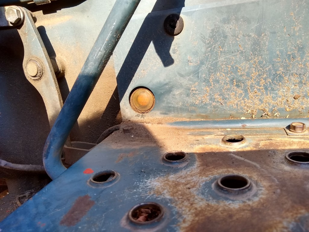

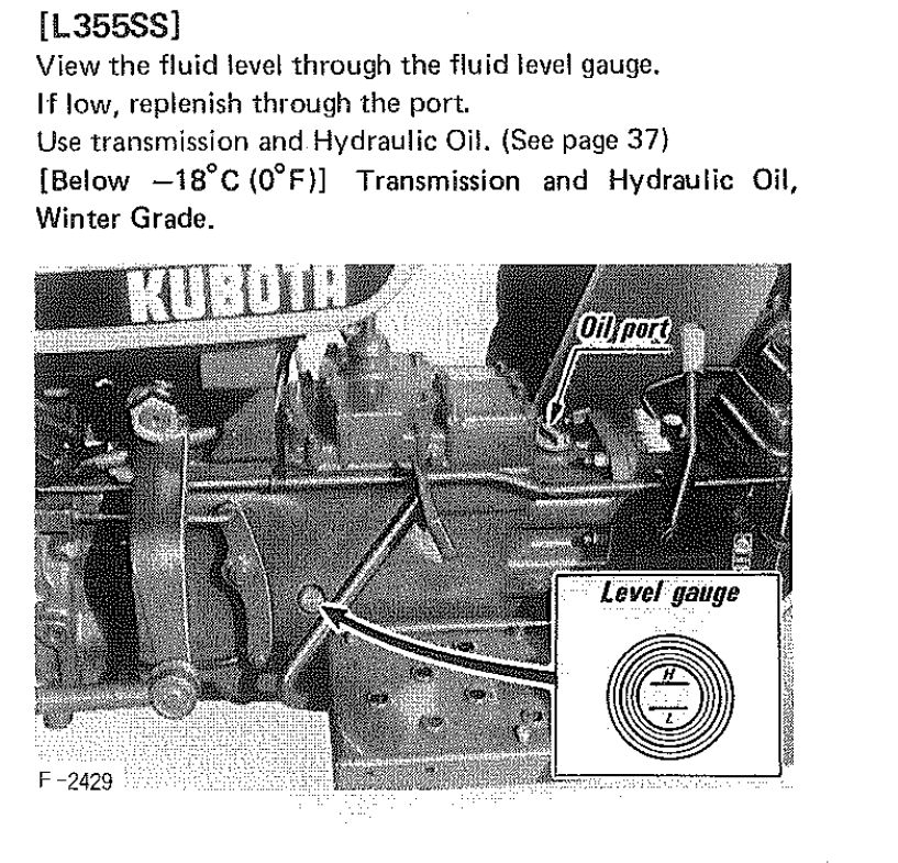

   / Where is the dipstick for the transmission in L355SS #7
CORRECTION - my bad, turns out what I thought was a removable plug near the L355ss clutch pedal is actually a discolored and hard-to-see level gauge. The current owner of the machine sent these :
