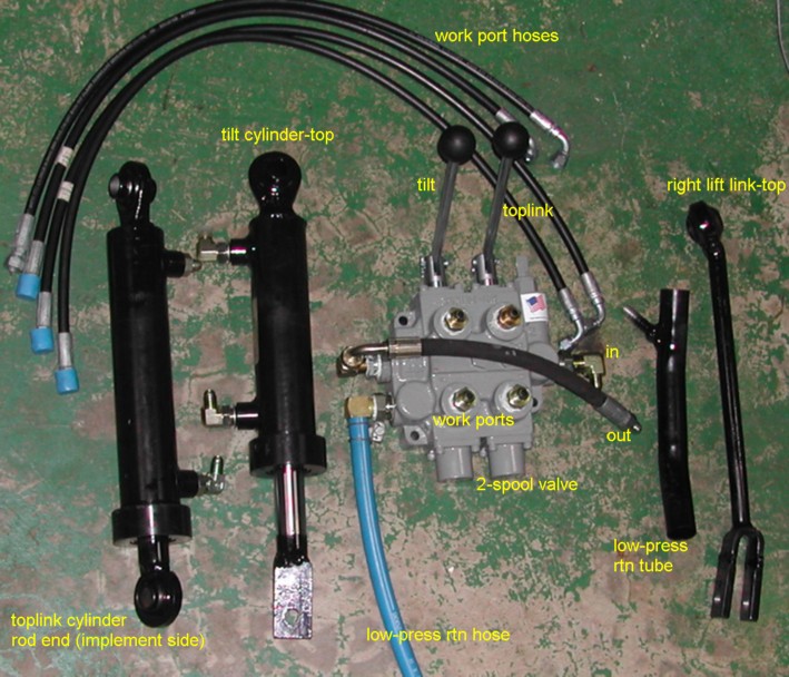

I was recently at the local Kubota dealer and I was admiring the new
TnT they had made up for a customer's new BX24. It did not have DPOCVs
so I casually asked the mechanic if they ever got customer requests for
these valves. He had no idea what DPOCVs were and when I explained, he
was adamant about there being no need. So much for "experts". I do
not use DPOCVs myself, but clearly they are very valuable in certain uses.
Anyway, here is a TnT setup I made for a JD. The 2 cyls are new, from
SurplusCntr ($55). One is 2x8, and one I shortened up to 2x6. I prefer
welded cyls here as there are no tie-rods to gather debris. I did have to
weld on swivel eyes....SurpCnter also has ready-made cyls with eyes.
