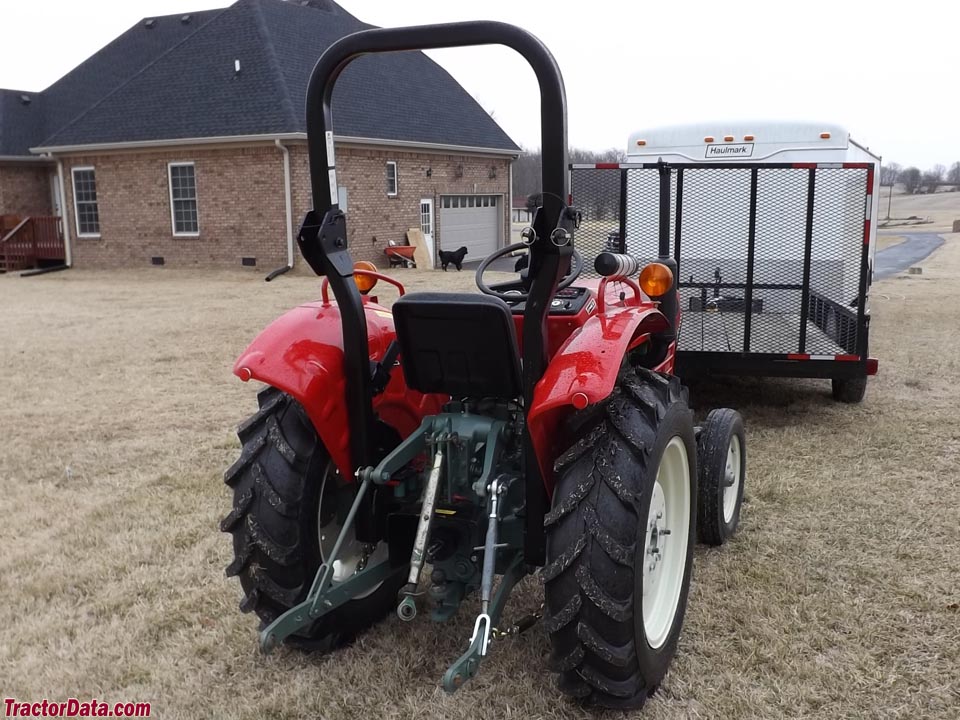

Here's my YM2610 that is really a YM2500. A YM2610 has the Power-Shift and the YM2500 does not. Both on the same chassis and both have the 3T80 engine. Also the John Deere 850 is the twin to YM2500.
Looking between the PTO and the hitch with ball, you can see the 3-bolt circular plate to access the filter screen. Click on the image to enlarge.
