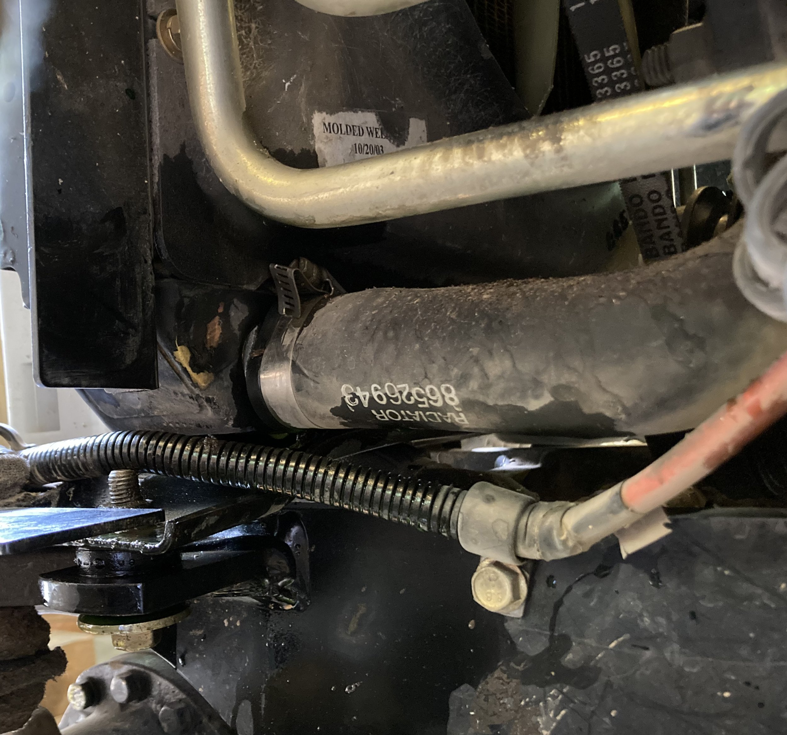

There is enough of the neck that is smooth to put the hose back on..... maybe need 2 clamps, but should seal just ahead of the rolled edge easily.
   / Where does this carriage bolt belong? #12
You can also get one of these:
It would be a lot cheaper than a repair shop. Auto Zone actually rents them out for free.... just leave a deposit that's refunded when you bring it back.
#13
This seems like a good idea, but I would need a pretty small version. The radiator connection is 1 1/4” diameter, and with the dent pushing that inward, I’d have to start with something no larger than 3/4” diameter.
This harbor freight tool starts at 1 1/2”.
   / Where does this carriage bolt belong? #14
Try putting a piece of steel pipe outside to keep thing round and insert a big ratchet socket inside the fitting. Then use a pair of long nose vise grip to work the socket in the fitting until it get back to shape.
Sorry no picture of what I mean.
#15
Update: The lower radiator hose connection was more than dented. It had a leak. So, I took it to a local radiator shop. They did a nice job of repairing it. They also flushed, pressure tested, and even painted it for me. All for far less than the cost of a new radiator.
The radiator is re-installed, along with new hoses, clamps, cap, and the engine fan (which also got a bit chewed up in the mishap).
Total cost of my mistake is about $300 in parts, and maybe two full days total of my time. I gave my tractor a good workout this week, and all seems well.
