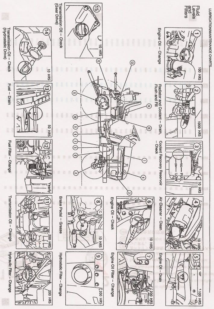

Seems like a silly question, but I am not very engine savvy, so I asked my father who IS much more engine wise, and neither of us could figure out where to refill the hydraulic fluid. I bought my tractor in the late 90's and have had it service by garages since then. I'd like to change and fill my hydraulic fluid myself, but this simple job has me confused. Help please! :)
This is a Cub Cadet 7235 tractor with a front loader.

You can download the operators manual from MTD here. http://manuals.mtdproducts.com/mtd/GetFile.do?filename=772-9044.pdf
And I uploaded the service manual here.
Cub_Cadet_7000_Series_Compact_Service_Repair_Manual.pdf
Here's a chart from the operators manual that shows the lubrication service points.
