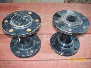

Can anyone tell me what these are? are they to space the wheels out or something else?? I located them on Craigslist and this is the description.
2 NEW TRACTOR WHEEL ADAPTERS
FOR YANMAR MOWER
#794240832
6 LUG BOLT PATTERN-MEASURES FROM CENTER TO CENTER ACROSS 5 1/2"
7 1/4" TALL
   / Where can I get wheel spacers #9
They look like two different size pipe flanges welded on a short piece of pipe.
