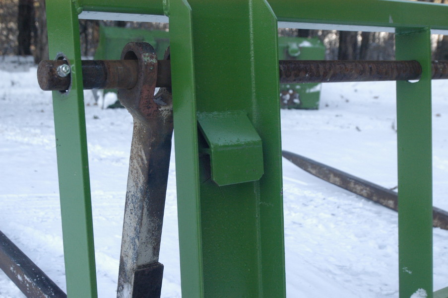

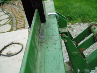

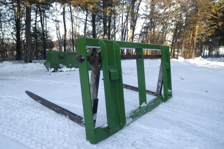

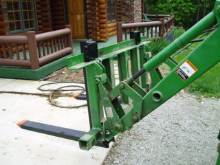

Where can I find the "hooks" and pins that will allow the JD 400x loader to attach to an implement? For example, does JD or someone else sell the invididual hooks, or a plate I can weld to an individual implement that will allow the implement to attach to the JD 400x loader? :confused:
   / Where can I find the loader "hook" #2
You can get them from JD.
Hooks #W43359
Pins #W47211
   / Where can I find the loader "hook" #3
They are also very easy to fabricate yourself also from 1.5" angle iron for the hooks, and CAT2 pins from TSC for the lower pins.
   / Where can I find the loader "hook" #5
Do you know how much they cost? :(
From JDParts.com (you are registered right?):
W47211 PIN, BUCKET ADD 13.99 USD
W43359 HOOK, BUCKET ADD 11.99 USD
I can try to find the picture of the angle iron one if interested...
