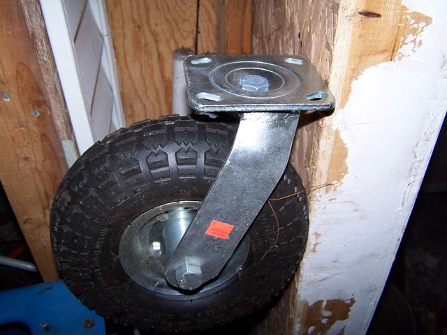

Harbor Freight sells large rubber tires on a swivel caster fairly cheap. I bought a pair just haven't mounted them on anything yet. I think mine are 8" wheel with forks similar to your pic. then the bearings with a flat top plate that has 4 bolt holes. Sticker on other side of fork says 300 lb rated.
