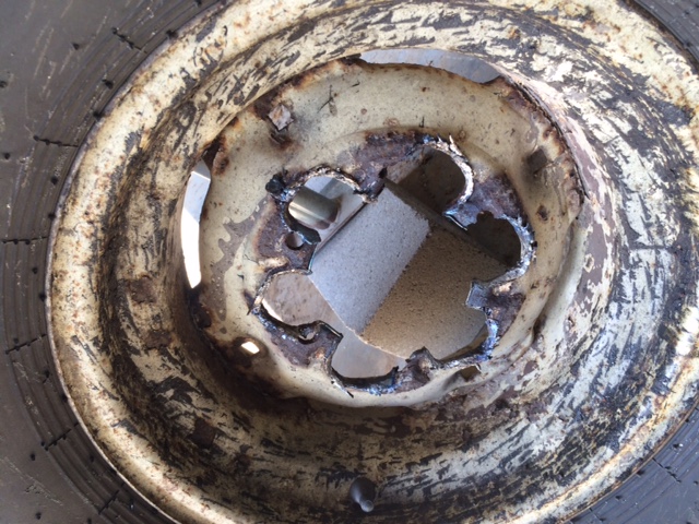

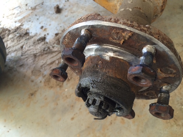

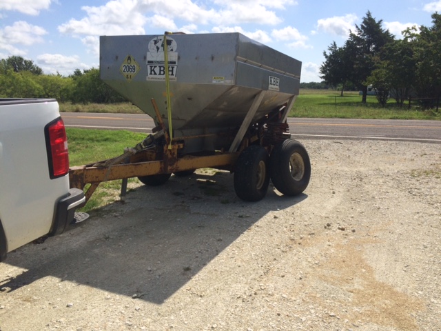

Thought I'd offer some entertainment for the evening. 4 ton fertilizer buggy heading down the highway when the rim absolutely lets go and rolls past me in my truck. Cars in the other lane were skidding and swerving. Luckily no one got hurt. This is a big implement tire. I have $1,600 worth of fertilizer waiting IMG_2658.JPGIMG_2663.JPGIMG_2665.JPG on some trailer repairs and it's supposed to rain tomorrow. Always exciting....

Who owns the buggy?
Did the rim let go because the lug nuts were not properly torqued?

Borrowed the buggy from the fertilizer dealer, luckily. It'll need a new rim, tire and spindle. Lug nuts are trashed. I even think it messed up some of the gearing on the spreader mechanism.
I think that's exactly what happened. I didn't bother checking them cause I just assumed someone was servicing it. When I had it in my barn, I lifted it up so that the weight was off the good tire, viola, the lug nuts were loose. Just amazing how folks take care of things.
