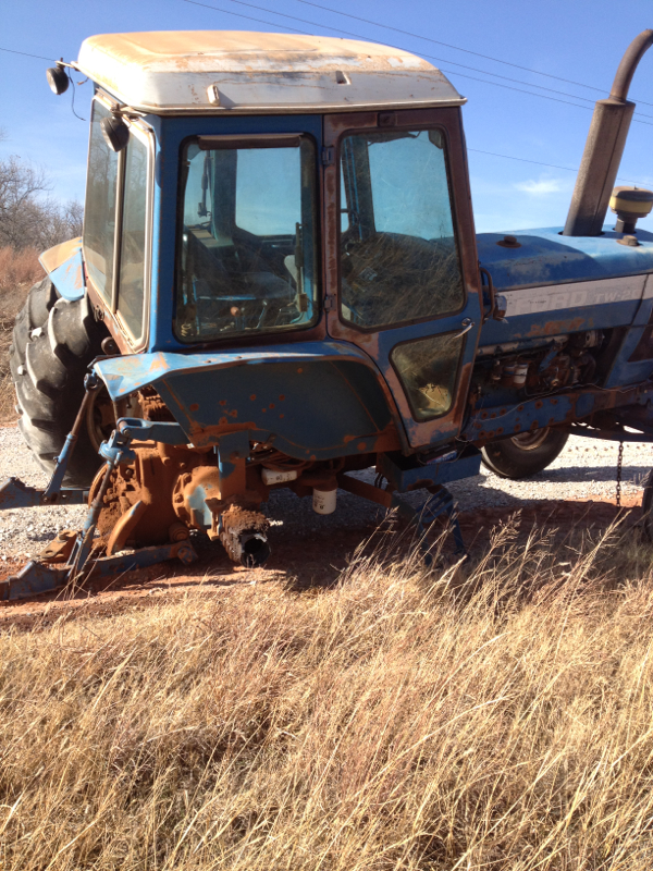

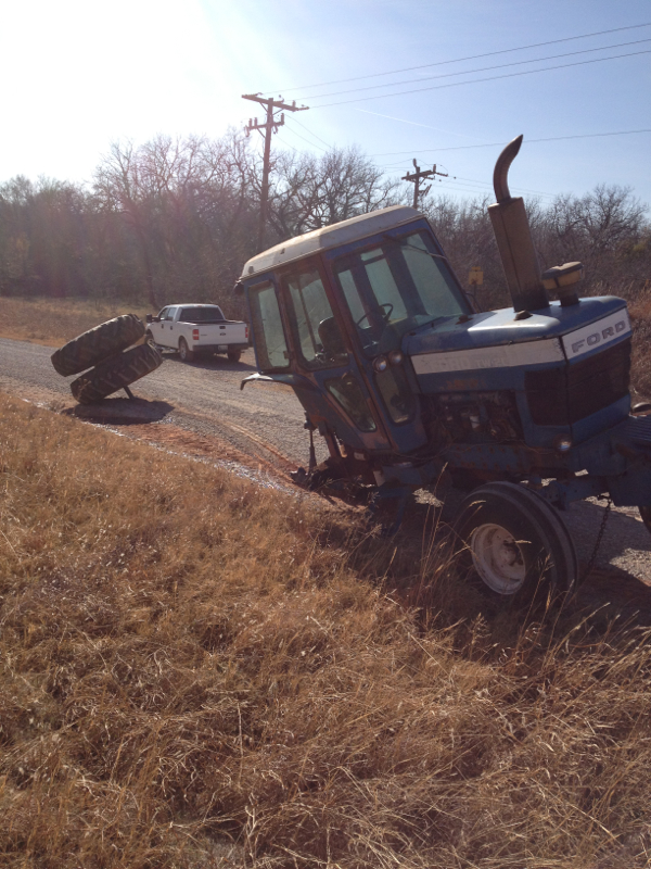

This happened behind my house yesterday. Very fortunate the old farmer did not roll.

Looks like it sheared the axle off. I have seen that happen on hay rake wheels but not on a tractor. Looks to be a fresh break not one that has been broken for some time.

If you look close at the front of the tractor in the second pic you will see a chain. I would bet that they were towing the tractor because it wouldn't move. Now they know why.

Not uncommon. Duals on a tractor designed for singles. Driving on a gravel road. Outside dual runs on the grader windrow, lever arm is so large either the axle shaft or the outer wheel bearing goes. When I worked for Case IH our combine final drives were very weak for the operator who wanted to add his own bin extensions, then drive home with a full bin, corn head, duals, and run that outer dal on a grader windrow. Life calculated in seconds.
