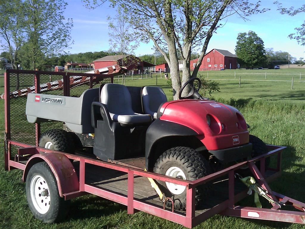

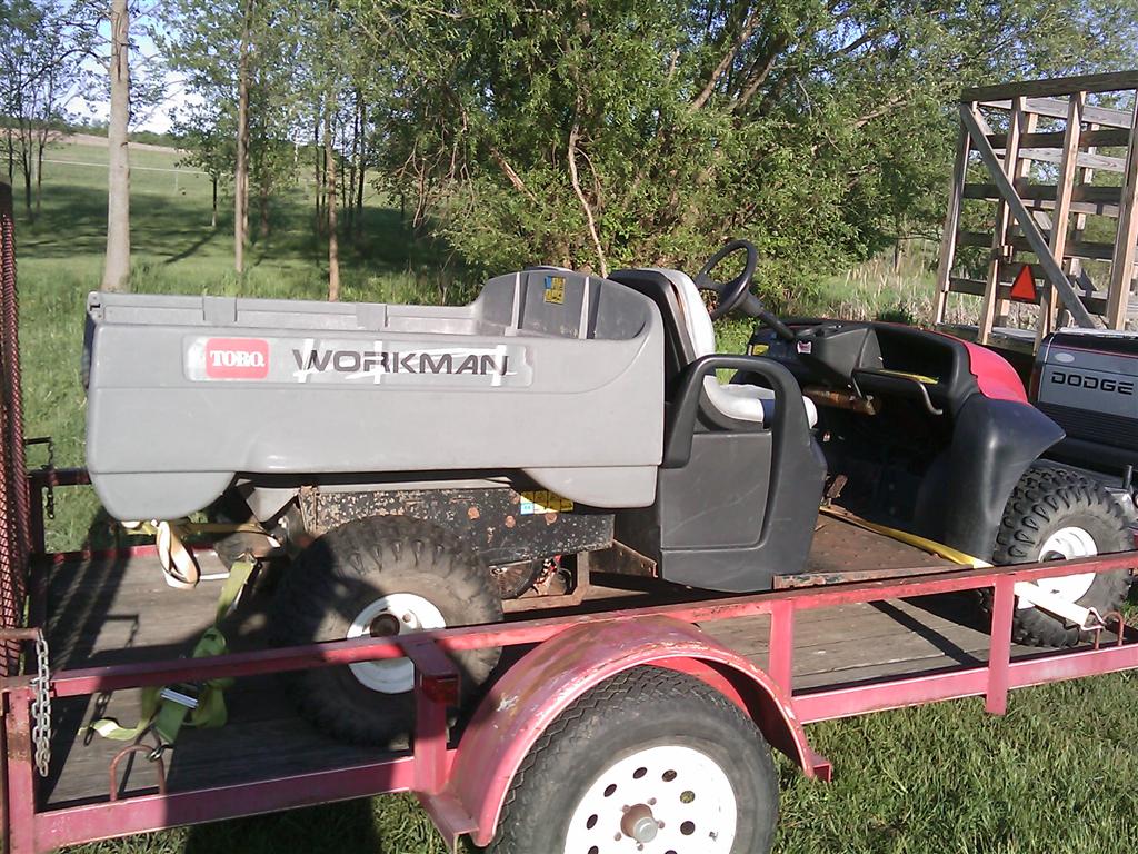

Crazy. My family rags on me at times for going overboard with tiedowns, but I dont EVER want to have something like that happen because I didnt take the extra 5 mins needed to tie it down right.
Here is an example from when we picked up the Toro:

I think you did it just right, nothing overboard about it. What if you had just did the front most strap and the rear, and the front came loose. There would be nothing to keep that unit from rolling back and forth.
