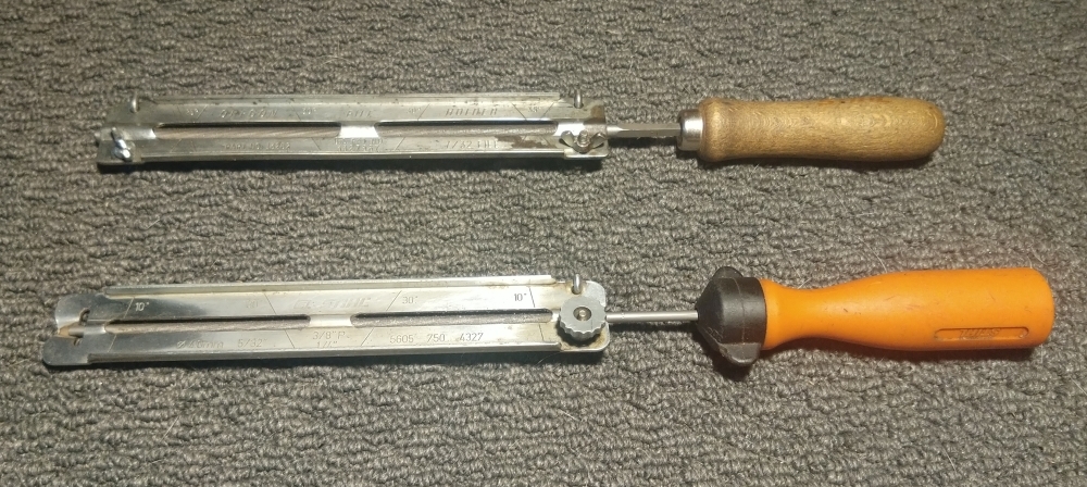

There's a lot of info (good and bad) about sharpening chains on the internet. I just use files in a holder to do the cutters and do the rakers with a burr in a Dremel by eye, no guides or gauges or 2 in 1s. The experts say each cutter should only get a certain number of strokes with the file and each cutter must be kept at the same length but when my chains hit a rock or some dirt any damaged cutters get filed just as much as needed.

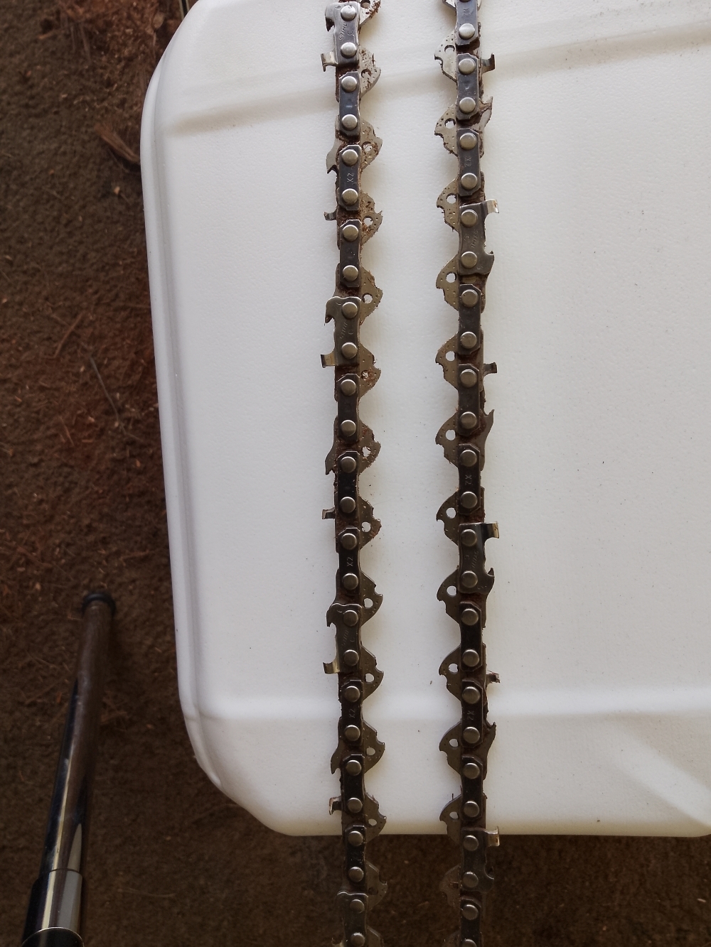

Anyhows often friends and neighbours ask when has a chain got to a stage that isn't worth sharpening so thought to show one of my chains which was still chomping nicely through hardwood but is now ready to throw into the metal scrap bin. I reckon I got my money's worth.
   / When is a Chain at End of Life #2
You're better than I, I guess. I would never use a chain close to that level.
   / When is a Chain at End of Life #3

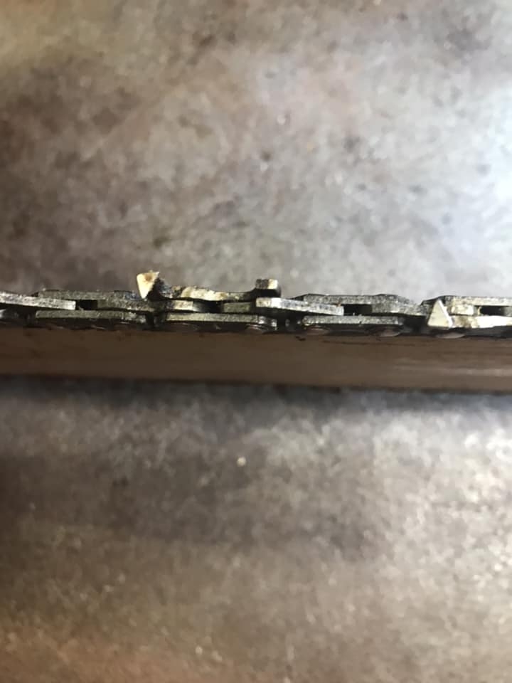

Lot a good hand filing left there IMO.
I take them back till they breaking off.
Thats when they become root crap cutting chains.

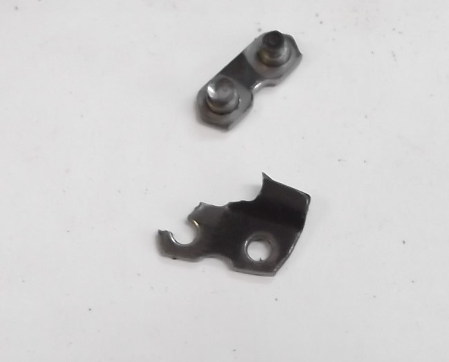

This one come in a farmer was using.
File till they break off in cut.

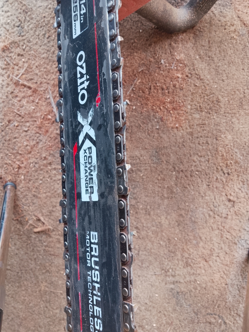

I buy three packs of chains for my Echo chainsaw from Amazon for a good price.
I file the chain to keep it sharp until the chain stretches to the point it won't stay tight anymore. Then I toss it and put on a new one.
I just cut firewood and burn about two chords a year. Winter in East Texas isn't very long, and we only get a few days when it's really cold out.

I have firewood guy that actually brings in his stretched chain and I cut and mend taken one drive link out for him.
After I inspect chain and make sure it is still safe and no worn areas that might break.
Case in point one that come in for sharpening.
Wasnt even his chain another guys. Cut and mended back up as rest was good to go.
