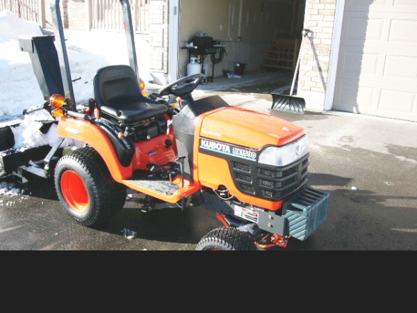

Kubota recommends the use of front ballast when using certain implements or attachments such as the grass bagger. I have never seen any BX tractors with front weights in person, but I have seen some in pictures. I know that Kubota makes a front suitcase weight holder for the all BX series and a separate one for the BX22/23 tractor. I have no idea of how they differ, but am guessing that the BX22/23 model takes into consideration the factory installed BX brush guard. Here is a picture that I got off the internet a year ago. It might have even been TBN.... just don't recall..

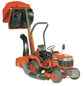

This picture is of the BX with front weights and the European Style grass catcher. I learned that the grass catcher is manufactured in the USA, however it isn't available for sale in the USA. The comments ranged from "it is too expensive" to "it doesn't come off once installed".. Guess that these two reasons are enough for them to only market over seas. Another interesting fact is that the BX comes in a 2 wheel drive model for the European Market, but that isn't offered in the US, but it is manufactured here for shipment across the pond. Notice the item in this picture is the Kubota rear view mirror... seems like a interesting addition if you care to see where you have been. /forums/images/graemlins/grin.gif /forums/images/graemlins/grin.gif

<font color="blue">Notice the item in this picture is the Kubota rear view mirror... </font>
I've noticed the rear view mirror on many of the UK tractors. I'm thinking it may be a mandatory item in the UK, just like the ROPS.
