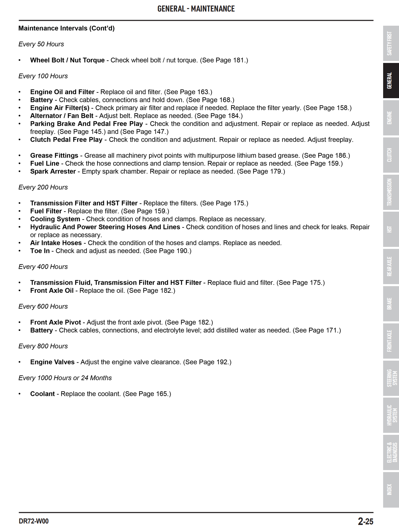

When do I change the oil? Service Manual vs Operators manual: 100hrs vs 400hrs!
