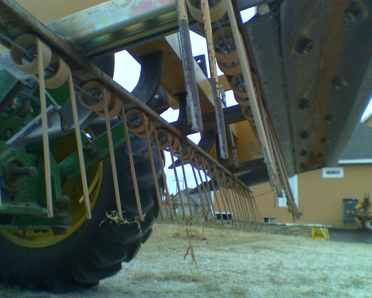

Last spring, I had a hair brained thought about trying to get more use out of my KK box blade. Given the spring time, I thought about a lawn de-thatcher. Here's what I came up with... (since I don't have a welder yet, my neighbor welded what I needed.)

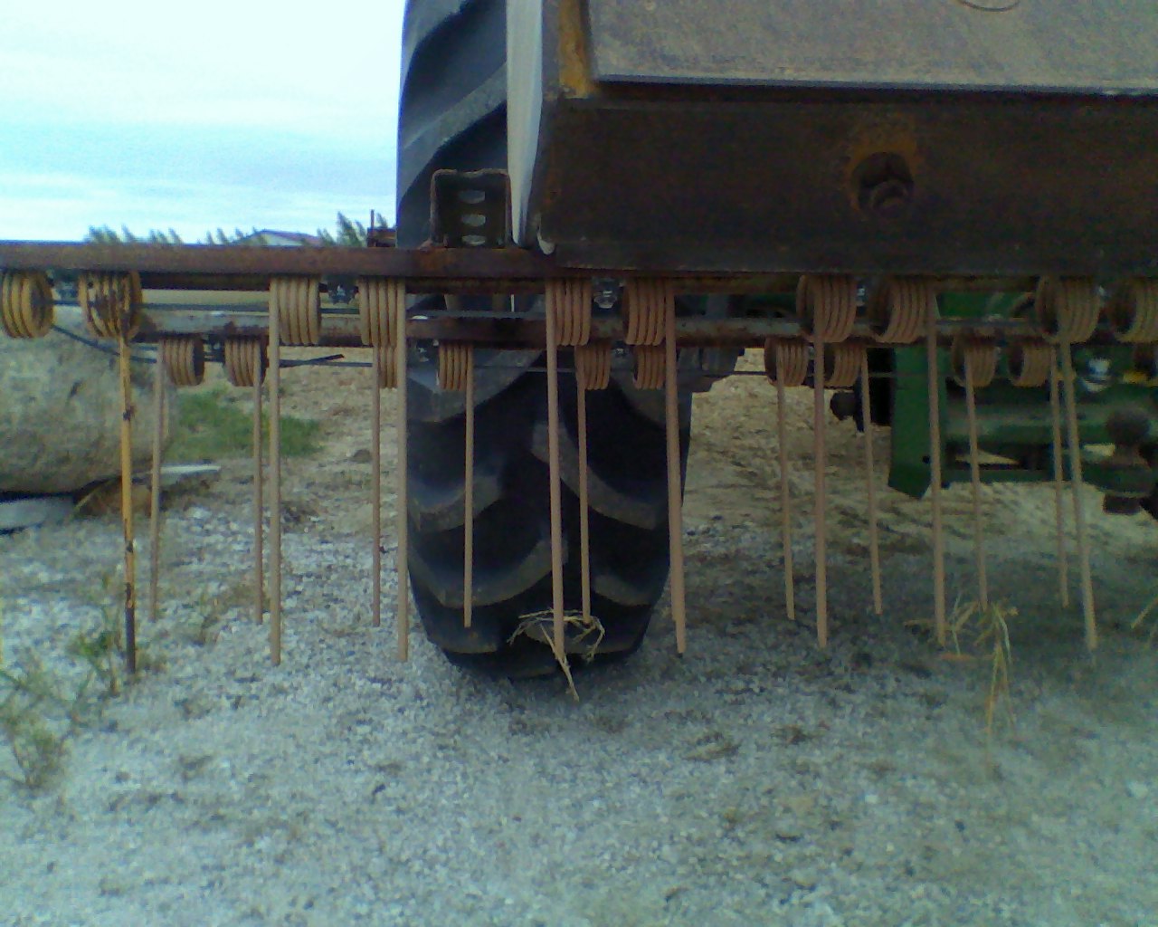

I found the type and style of baler pickup teeth that I wanted. I mounted the teeth to some scrap metal. The teeth are about 2-1/4 inches wide with the front and back off-set one half that distance. I ran a cable through the center of each coil with a loop of recycled cable so if a tooth breaks, I'll capture the broken piece rather than find it with the mower.
There are four struts fastening the leading to the trailing tooth bar. Two are on the outside of the BB sides, they keep the tooth bar from going side to side. The inside rear cutter is below the sides by 3/8" of an inch, and I use this to "push" the tooth bar through grass/dirt. The box blade is 5', and the teeth extend beyond the sides by roughly 8 inches on each side. It's wide enough that the tooth bar will remove the tractor tracks when making a tight corner.
Inside the BB there are two iron struts in the shape of an upside down "T". They are fastened up to the BB struts that connect the 3 point mount to the back of the BB. I over thought this attachement and would make it much simpler if I were to do it again. You might be able to see that I have threaded shackles on the top and bottom, over kill, but it does allow adjustment if needed.
The tooth bar works pretty well as a de-thatcher...the hardest thing being depth (height) control as you might imagine as the tractor moves up and down with the casual ridges in the lawn. My plan is to drill holes in the side of the BB, 2 on each side, to attach my finish mower wheels on each end as height adjustment. If you can keep the depth set where the teeth are just about perpendicular, the teeth do a nice job of brining up the thatch.

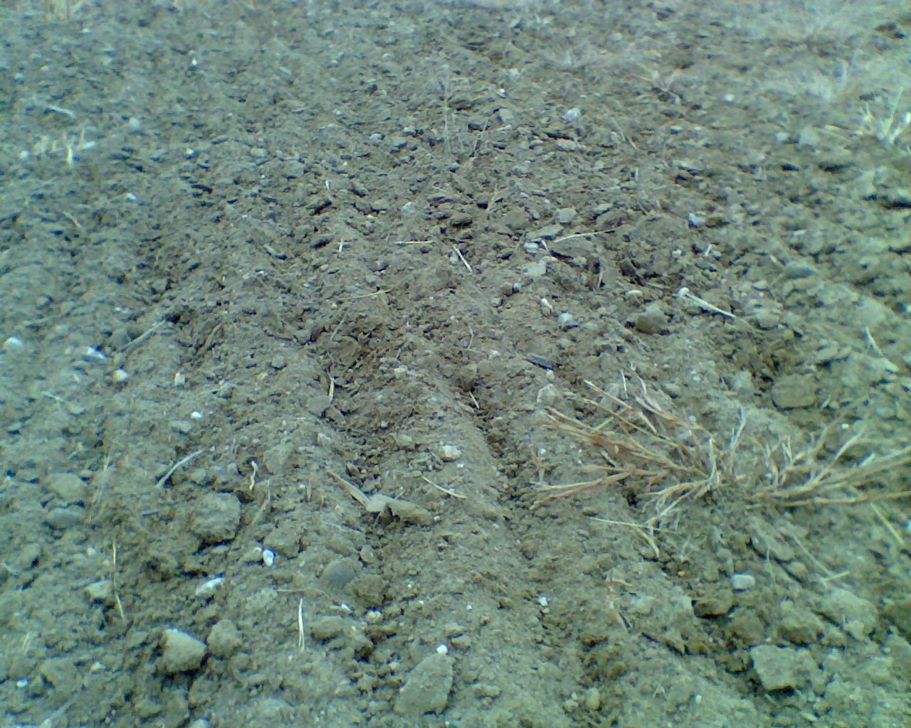

Here's the difference between no pass and 1 pass.

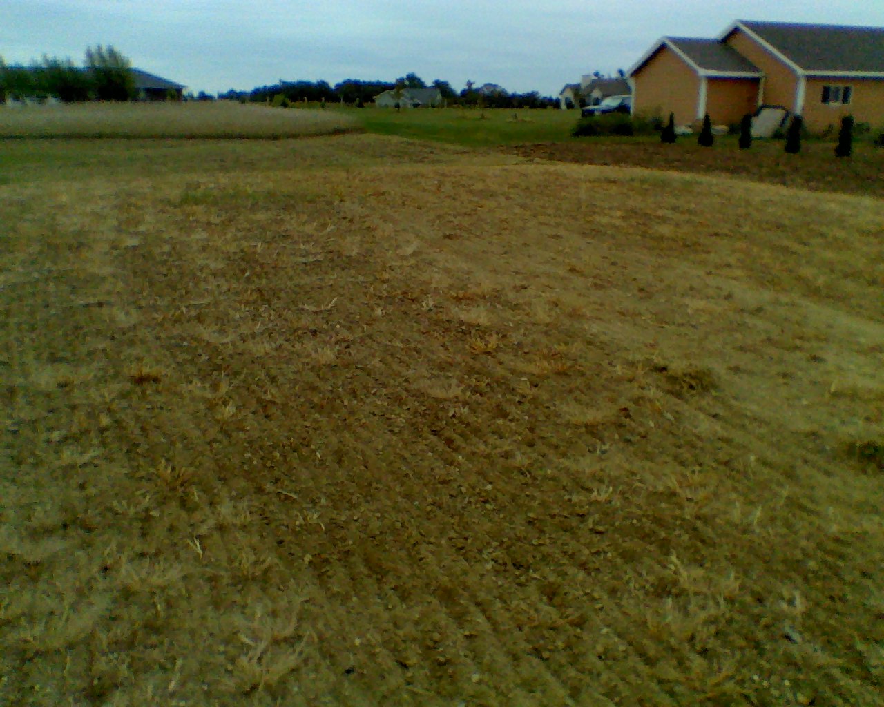

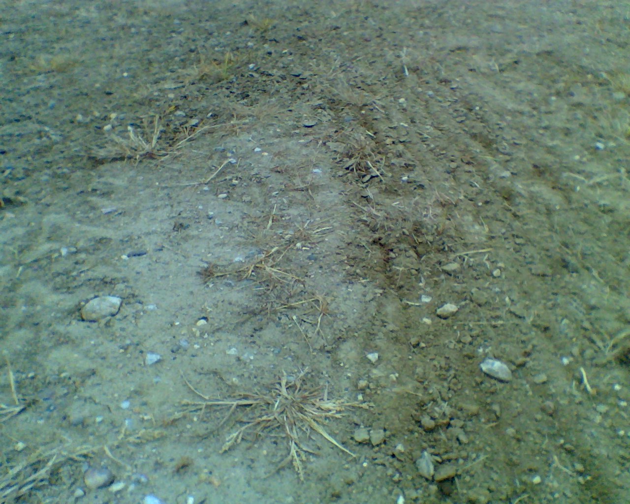

Here's the same area after 3 passes.
And the finished pad....

Darwin, I think you've made a very useful tool.:thumbsup: I can think of many times I'd like a tool like that. I have a rock bucket I stand on it's front edge and use in a similar fashion to smooth and spread dirt/gravel.
One thing about your build that caught my eye is the way your spring tines are mounted. They currently are wound clockwise when viewed from the left side as your pictures are taken, and the springing action expands the coil. In my estimation, that will make them more likely to break. I would think if you reversed the tines so that they are wound counter-clockwise so that the springing action tends to tighten the coil spring it would provide better spring action without as much danger of breakage as the current way they are mounted. What do you think?
   / When a box blade is not a box blade....
Thank you.
I debated with myself thinking about the spring direction, and with a couple of new holes, it's reversible, I may just do that to see if there's a difference.
