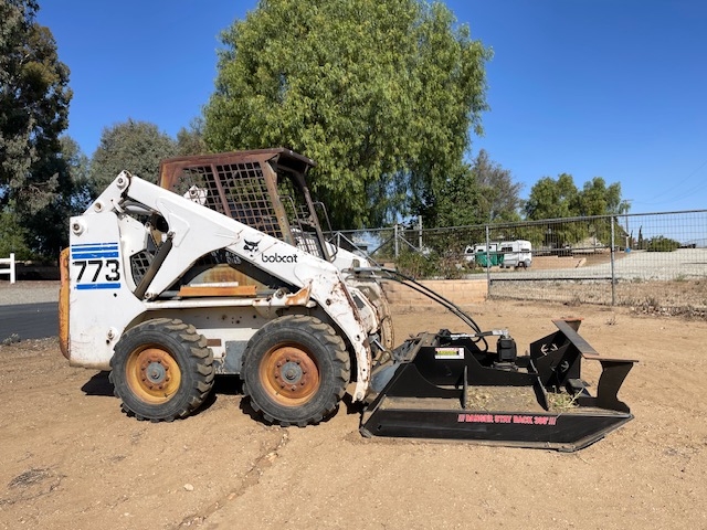

I've got a good ole Bobcat 773 I mow with, I know tracs are better than wheels but finding it hard to justify swapping out the old girl for a new one. The area I mow isn't wet. I don't typically have a traction problem or a tire damage problem. I would like what I perceived to be a smother ride on tracs. Can anybody confirm that tracs ride smoother?

Generally tracks are a lot smoother but if you’re going over a raised obstacle like a curb they’re worse.

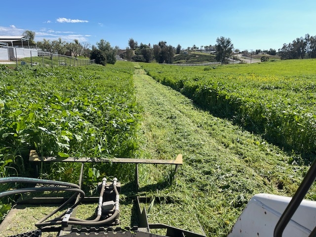

Tight spaces, steep banks, and 5 ft tall mustard weed. The frontal deck gives a better cut as the tractor lays down whatever it rolls over. Requiring a second pass in the opposite direction to get the same result....this was last year.

Tracks are smoother on soft surfaces but shake the crap out of you on hard surfaces like packed dirt or concrete. Track undercarriages are also a higher maintenance item than tires.
