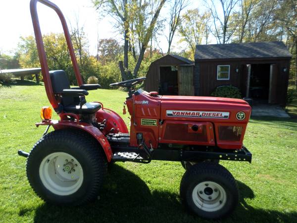

I have a Yanmar 147D with turf tires/wheels but also agricultural tires. They are the proper size for the Yanmar 147D Ag tires of 5 x 12, and 8 x 16 rear. Does anyone know where one can purchase the appropriate ag wheels for the YM147D? I might try Hoye.

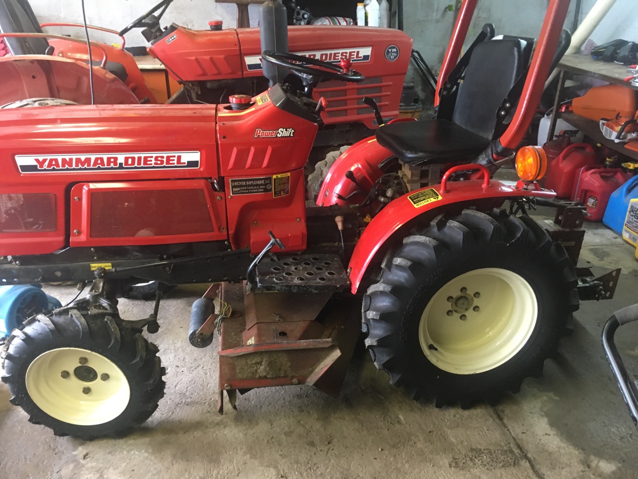

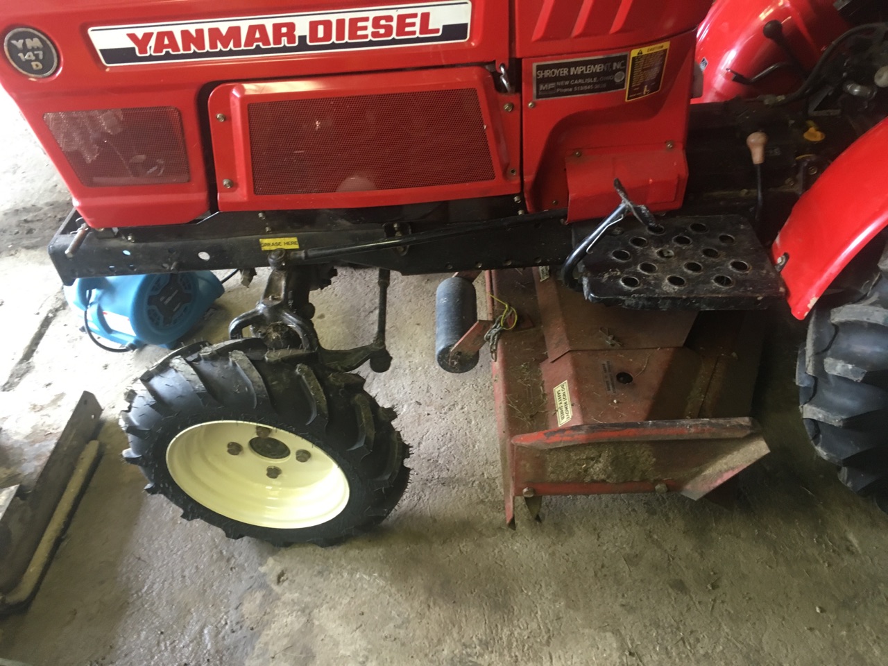

Just so you know, Gary Jamieson came through with having wheels manufactured. Here they are installed on the YM147D. He's a wealth of information, and the Yanmar gets through the yard much faster.

My "Lincoln Log" seating is a bit embarrassing but works. Gary has two sources for the wheels and the ones on the tractor are from the better company. Yes they were not inexpensive but if one plans to keep the tractor for a long time, it's fine. He has the exact specs and they fit just like they were from the factory. Pay once; cry once. My experience is that it's cheaper to buy the exact fit product than repeatedly ordering an inferior product or trying to make something work not designed to work.
