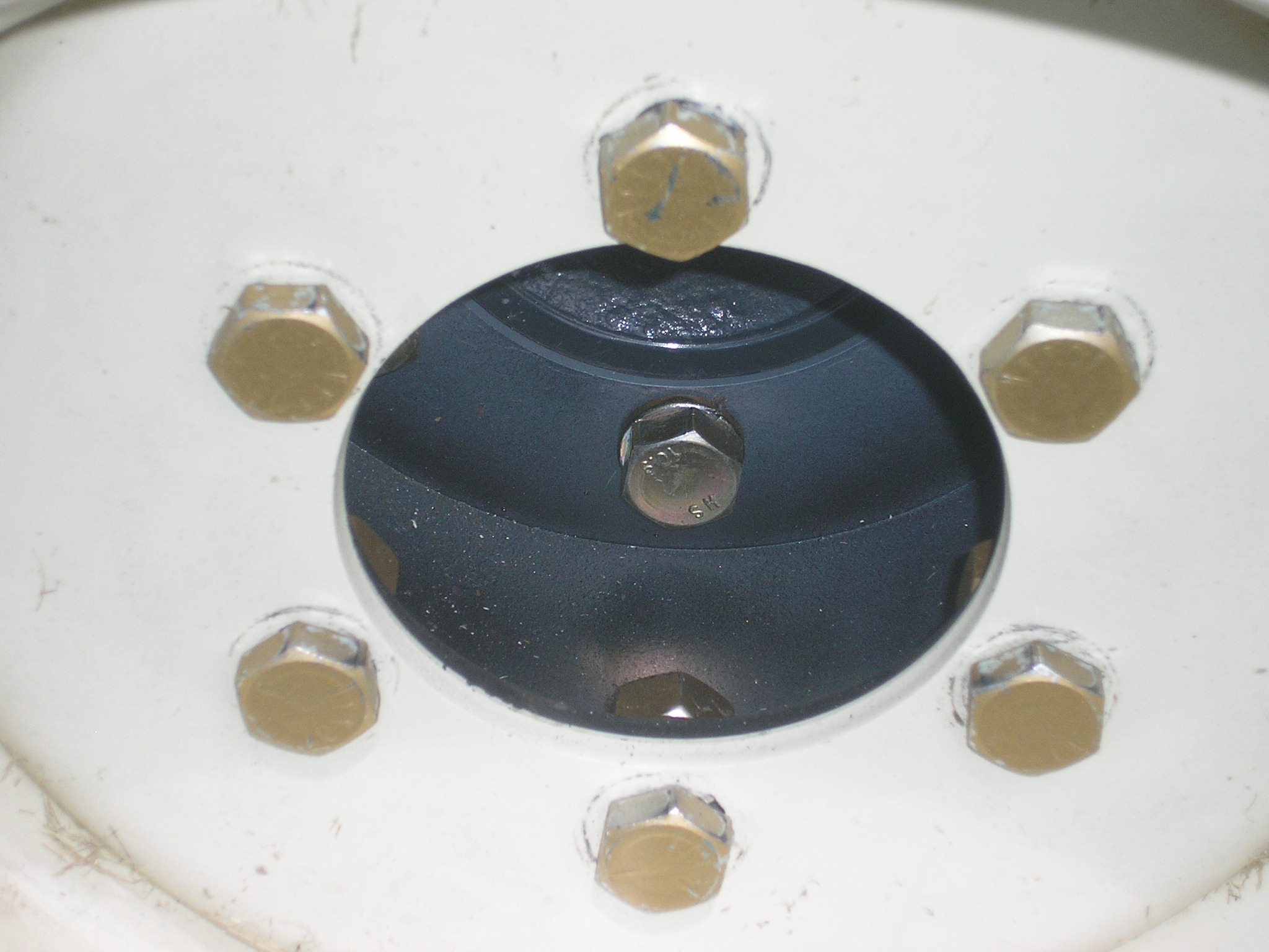

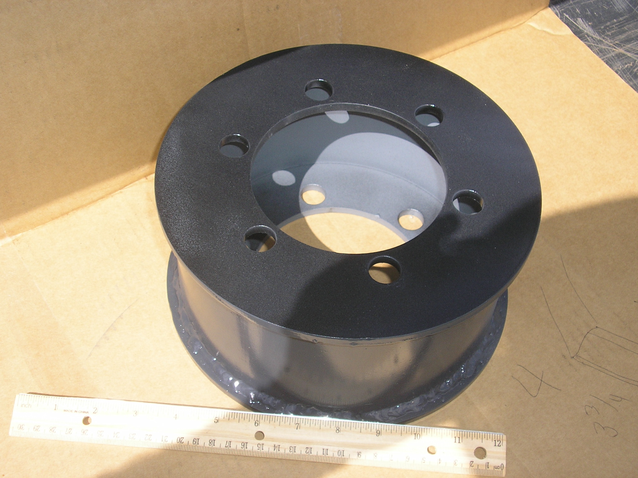

Use a pry bar of some sort, a ready built wrecking (crow) bar works fine and a piece of 2x4 wood. Using a floor jack, jack up the tire to where it is just "AT" the floor level or just above by a little. Undue the lug nuts/bolts and using the bar and the 2x4 (under the bar at the side of the tire) prise up on the bar taking the weight of the tire off the wheel studs and pull the top of the tire away from the tractor.
For spacers I made these out of quarter inch steel plate and a piece of 8" diameter steel pipe.

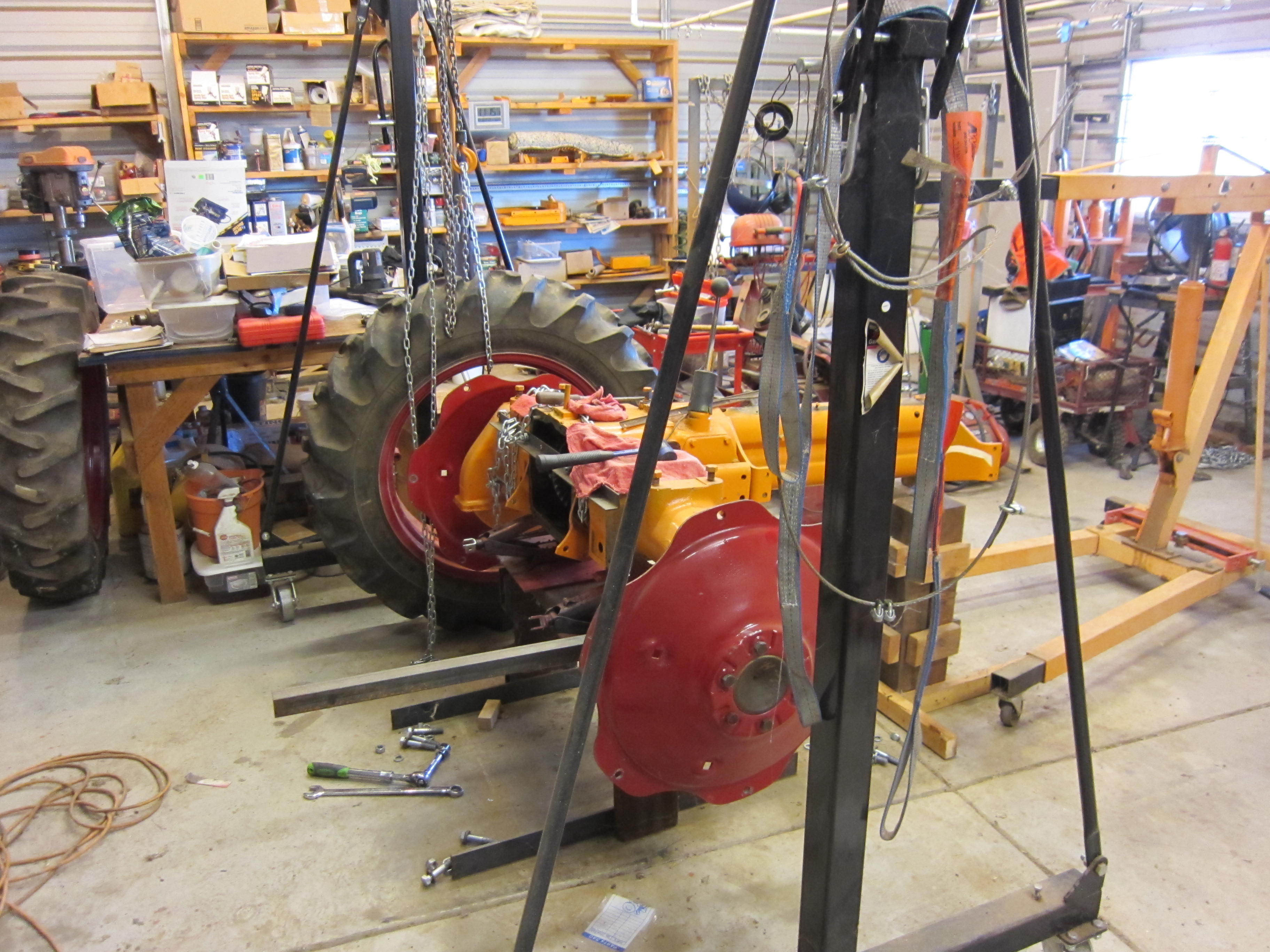

If your rears are loaded with fluid, I'd drain it out before removing the wheels from the tractor.
If you want to do heavy work on tractors safely you need the right equipment. Here's how I handled rear wheel removal/reinstallation when I restored an old 1951 Minneapolis Moline BF tractor. Even then you need to be very careful when rolling those rear wheels around the shop.
Good luck and be careful out there.
