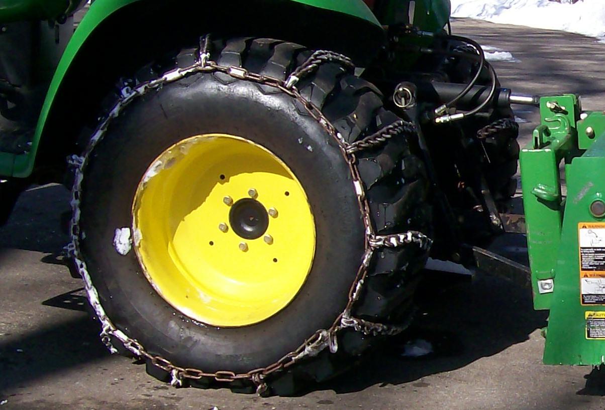

Just flip them, I did mine and there is plenty of clearance. Same tractor and same wheels/tires.
No need for spacers.
JB.

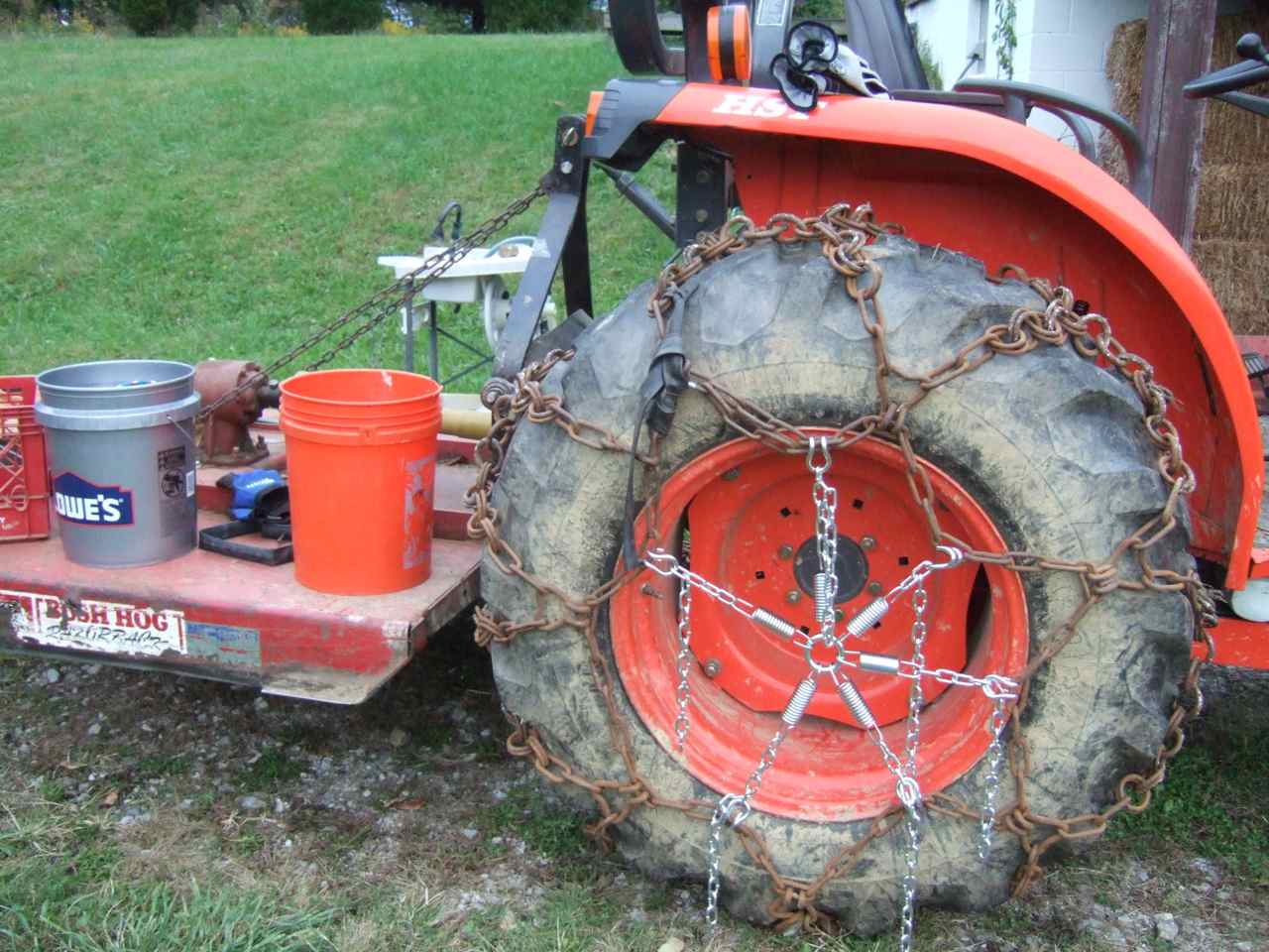

I flipped mine around as well, and made chains that have longer side chain and shorter cross chains. They fit higher on the tire and thus give more clearance. And a key here is that they "fit" the tire. :)
I'd go with the spacers only to add wider stance to the tractor.

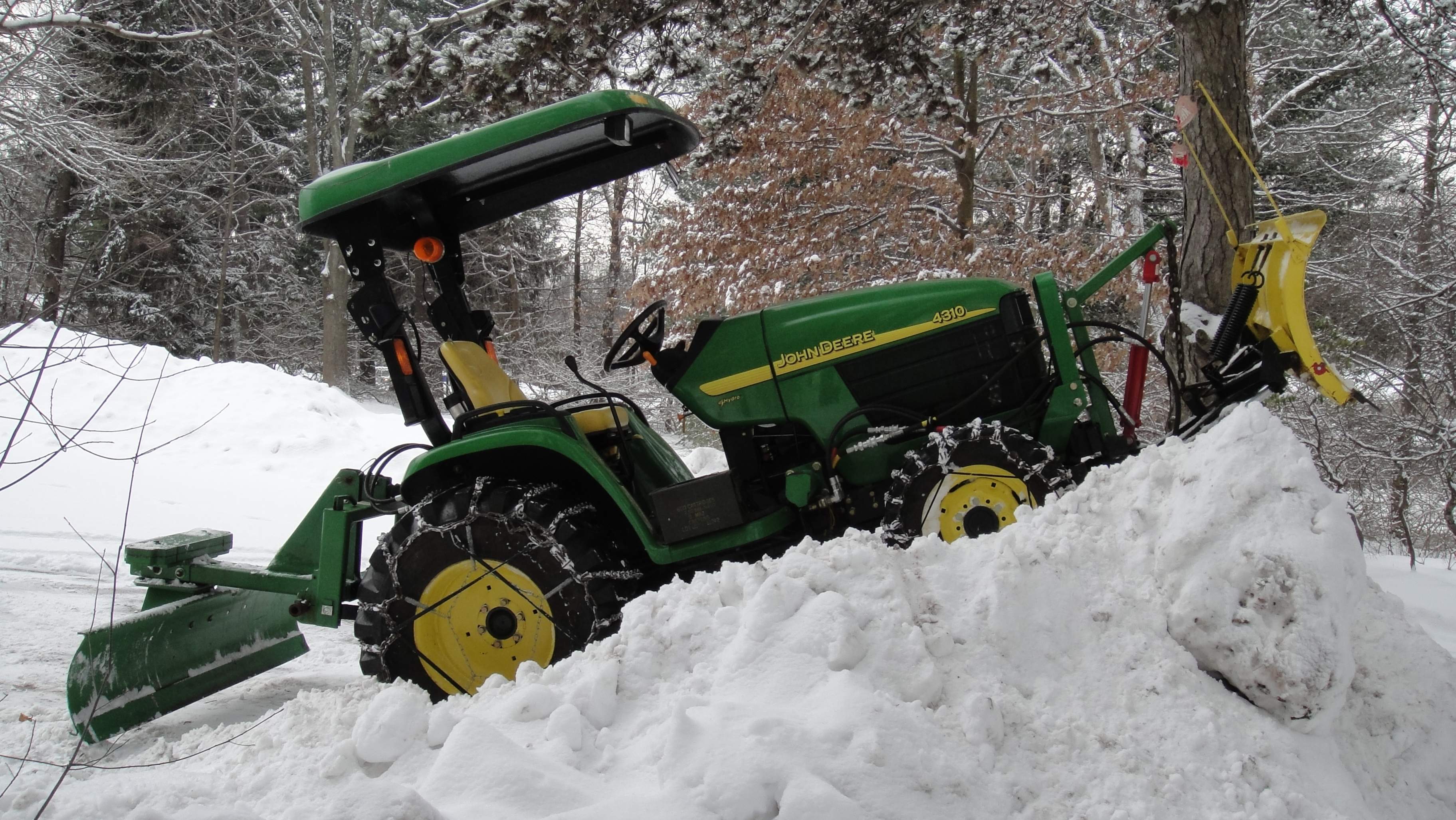

Well I said there's plenty of room, I should of said there is enough room.
You do only gain 2-3 inches, but it is enough room for chains. Flip them side to side of course so you maintain the directional tread.
As far as 4X4 goes, the short answer is yes, most of the time I'm plowing snow I'm in 4X4.
JB

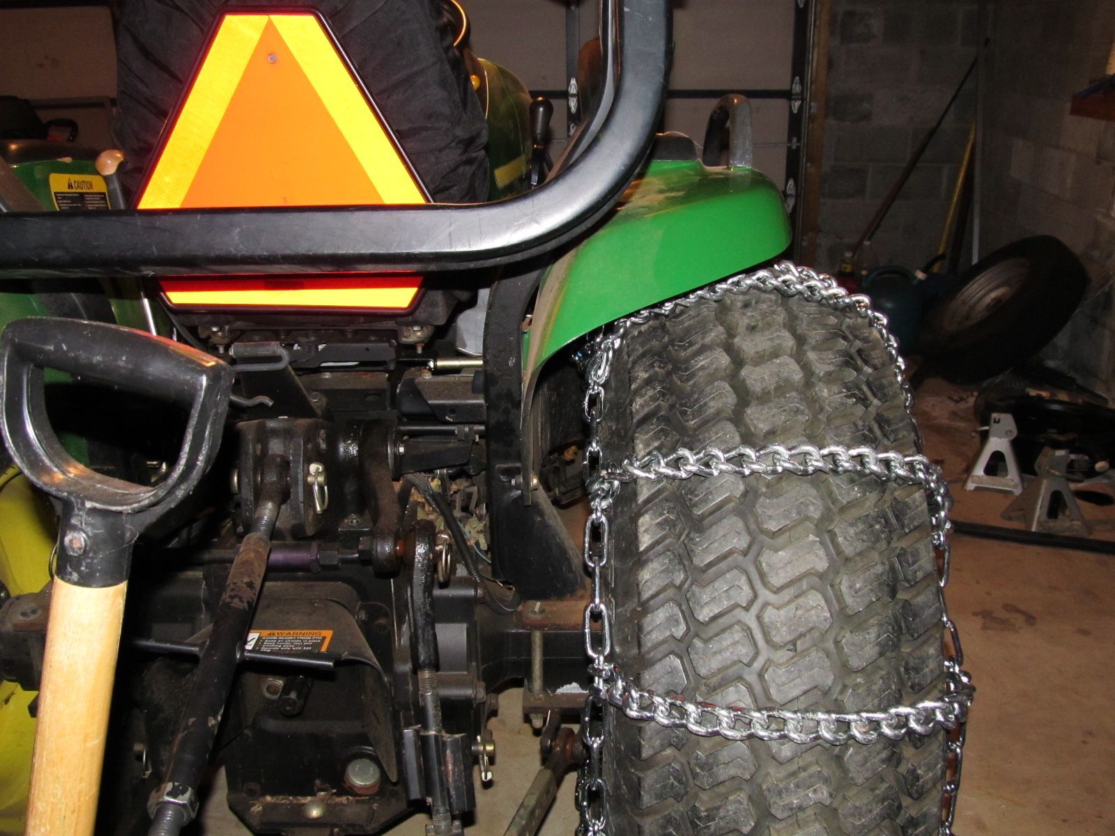

By swapping the rear tires (in my case, with turfs, I could reverse them), you can get quite adequate clearance for chains.
The chains are the 4-link ladder type from tirechains.com.
See the "Before" and "After" pics below:

On the R-4's, one will gain about an inch or inch and a half by reversing the tires/rims.

Depends on how deep they're dished. When I measured my 790's rear wheels (tires were 15-19.5...pretty common R-4 size for Deere CUTs), I calculated 2" per side.
I could be comparing apples to oranges, but it's worth measuring the dish before using spacers. Just MHO...

Caution:
If you're going to shorten your cross chains (width) and then lengthen the side chain to "raise" the side chain closer to the tire shoulder two things can happen.
1. As the chain moves it will tend to try to peel itself off the tire.
2. Additional torque on the chain could cause premature wear and failure.
The side chain is supposed to rest on the tire sidewall. Correct fitment allows the chain to move and sit properly on the tire. A chain that is too wide or too narrow will tend to give you some headaches down the road.
BTW...nice tip on the wheel reversal.
