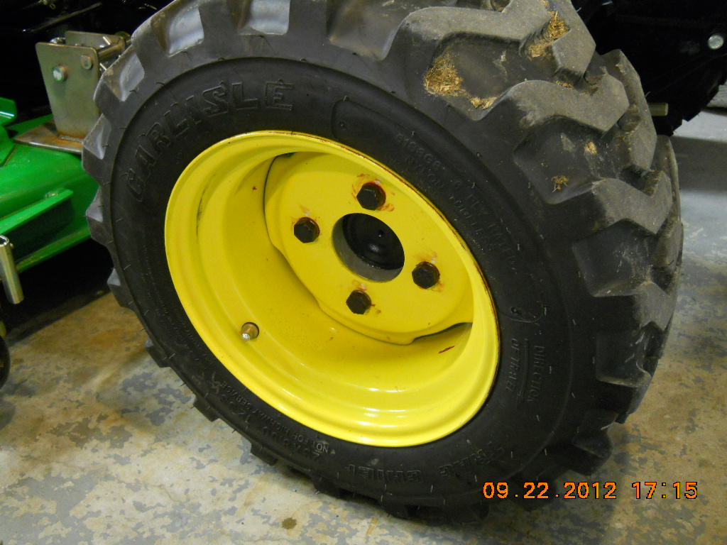

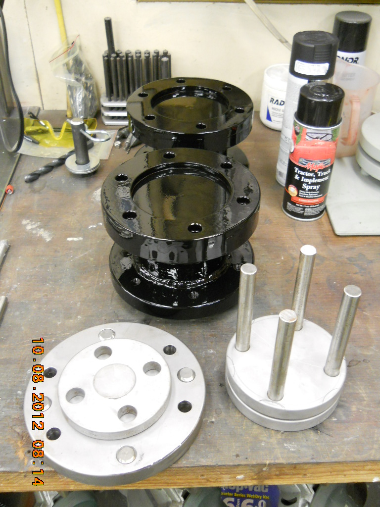

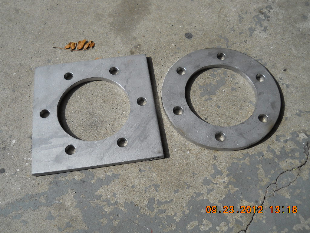

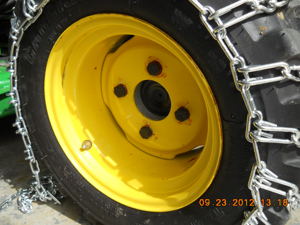

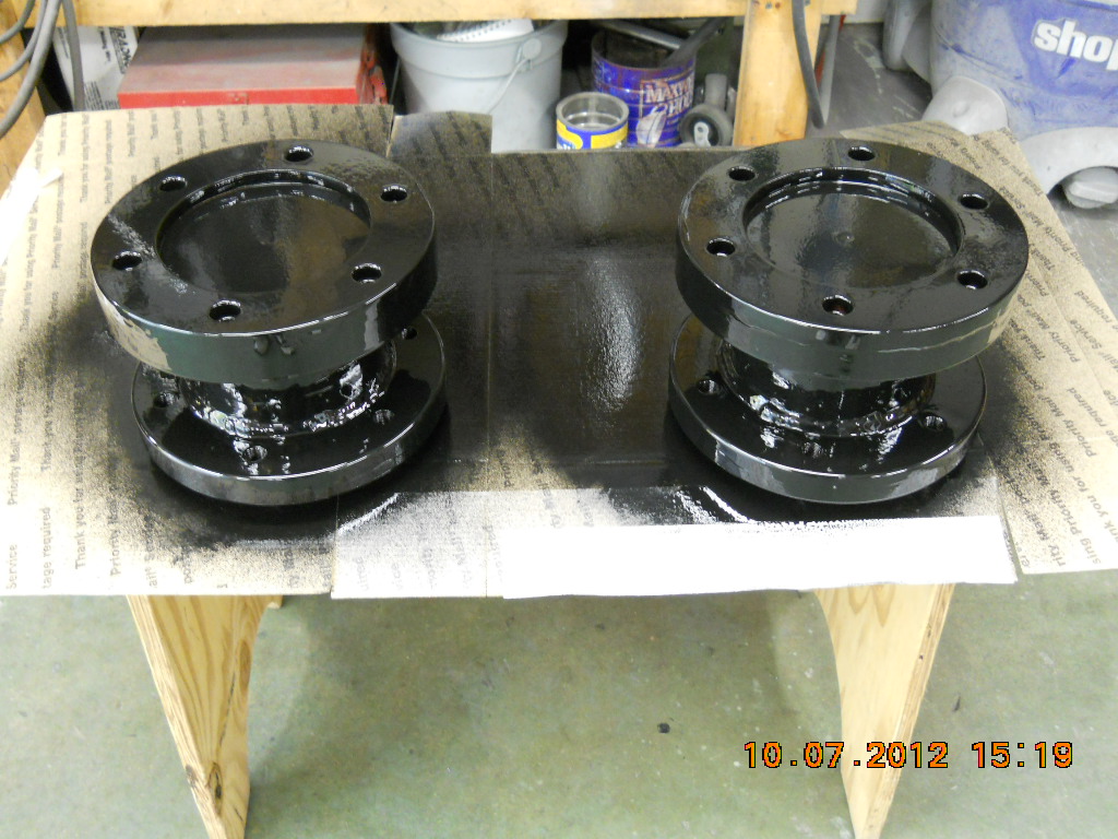

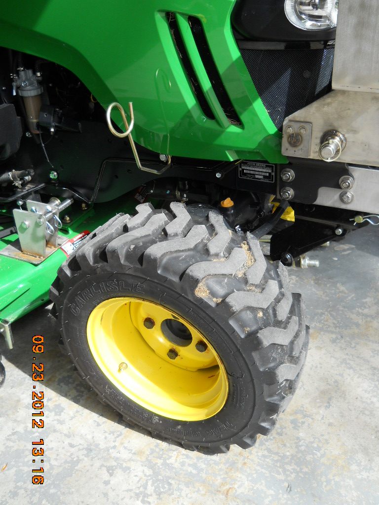

I recently made some wheel spacers for my JD 2320.
The front spacers were needed for tire chain clearance.
1" aluminum with pass thru holes for the lug bolts gives good clearance for the chains.
longer 14mm bolts were required.

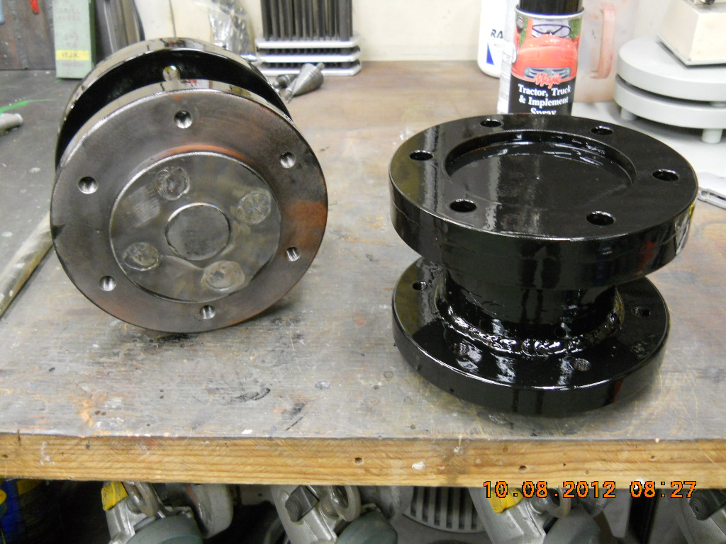

HD 2 link ladder chains "fit" on the rear of my 2012 and clear the hydraulic lines and weren't needed.
I made the spacers for future use when i will be pulling logs for fire wood and to give the tractor better stability on sloped terrain.
( I also like to weld and fabricate things for relaxation) i am married with 3 kids not including myself.

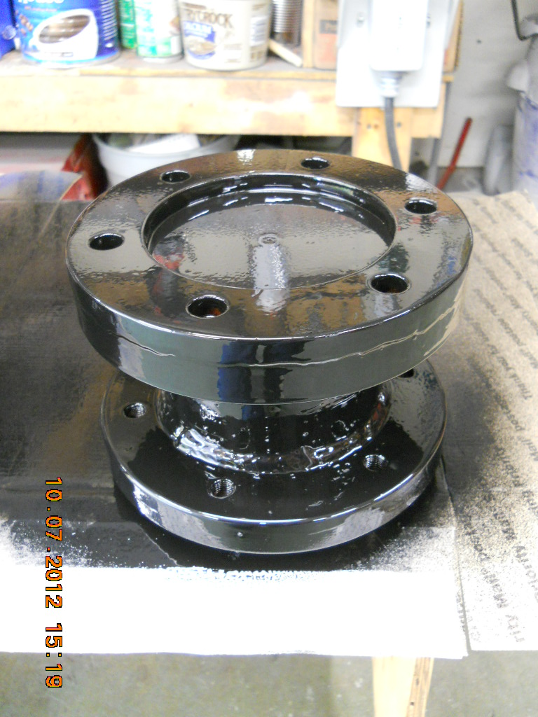

in the process of painting the rear spacers.

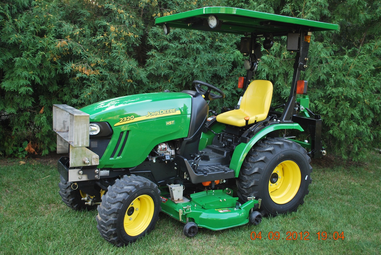

the rear spacers will not work with the 54d mowing deck on. the tires will hit the deck caster wheels.
so for those of you that have said chains on the rear of your 2320 will not fit without spacers keep this in mind.
I plan to remove them in the summer.
tom new tractor 241.JPGnew tractor 293.JPGnew tractor 294.JPGnew tractor 295.JPGnew tractor 296.JPGnew tractor 297.JPGnew tractor 298.JPGnew tractor 309.JPGnew tractor 312.JPGnew tractor 313.JPGnew tractor 314.JPGnew tractor 315.JPGWHEEL SPACERS 001.JPGWHEEL SPACERS 002.JPGWHEEL SPACERS 003.JPGWHEEL SPACERS 004.JPGWHEEL SPACERS.JPG

just waiting for some new 10.9 grade metric bolts from a local fastner supply company.
they had to order the length i needed.
i may also fab up some stainless fender extensions that can slide/latch on and off.
i don't want to drill or cut the original fenders.
