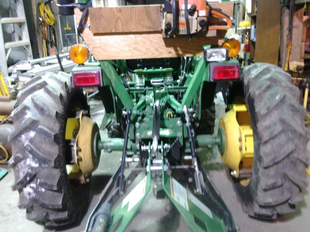

I made these spacers that go between the wheel center and outer rim a few months ago. Gave up on nice weather and paint... today they went on. Gained 4.5" per side.

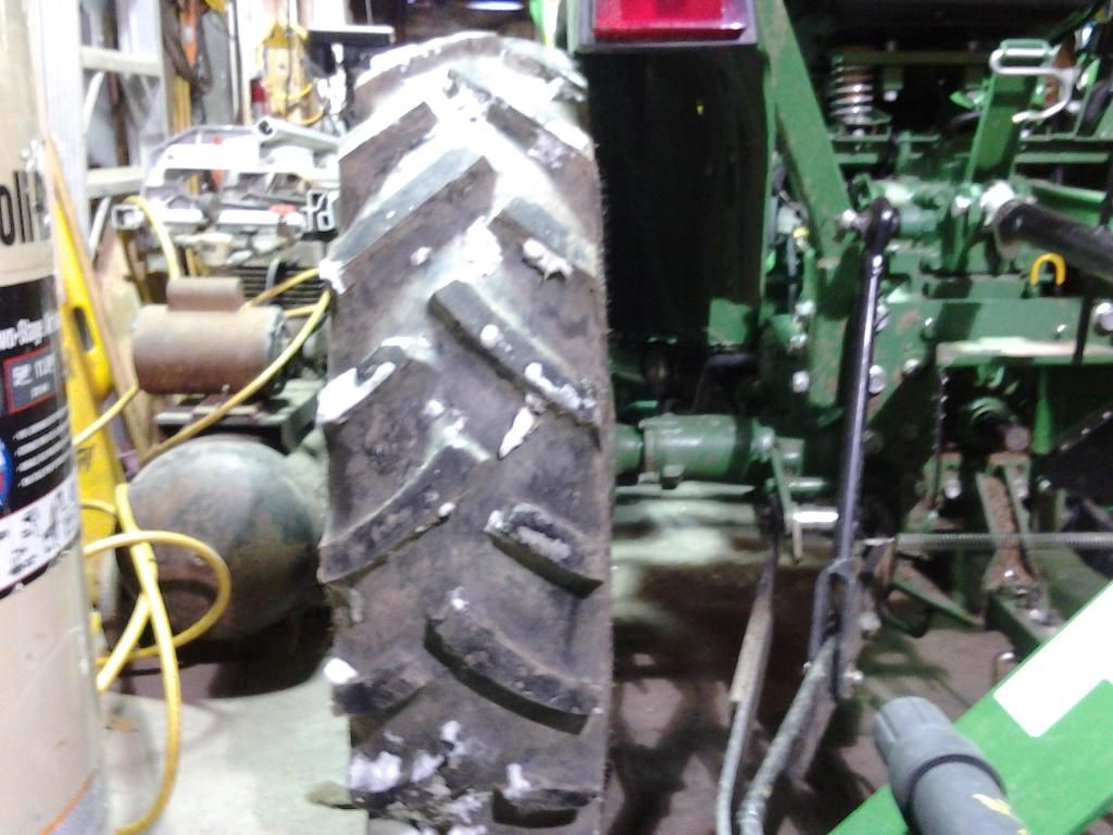

After the install. Hillsides here I come! 3 got sandblasted and painted last fall. The rest will get paint come spring or summer.

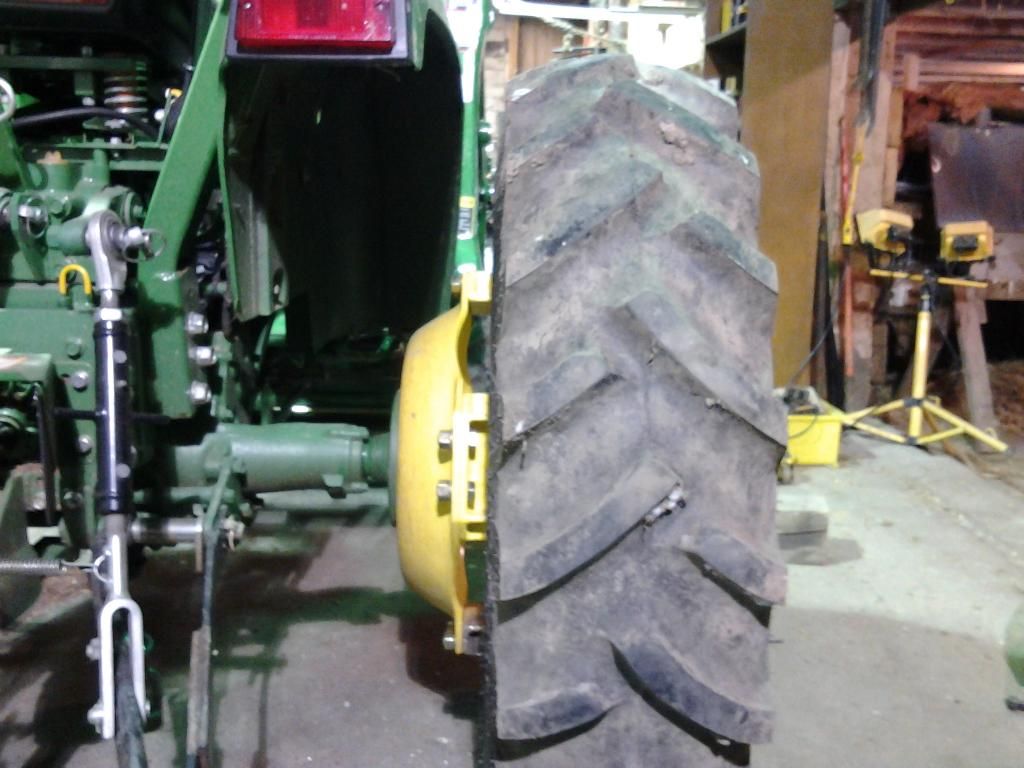

Left side before, for comparison.

WOW, did that ever widen your rear stance. Nice job. B.

Yeah... I think I might move the fenders out some too! Not only would it make the proportions right, I could gain 6" on each side of space beside the seat for a tool box, etc.

View from outside...

Boy, that's the good old 70's deep dished rims hot rod look that's for sure. I would think you would need something to cover the tires to help keep sling dirt off of you. Will you have to build a frame to move the fenders out? B.

I dont do much high speed mud flingin with the tractor... tires were mostly outside of the fenders before so not much diffrence in that area.
I was looking at the brackets needed to space the fenders out earlier today... it can be done but the additional levrage on the stock mounting brackets has me concerned.
