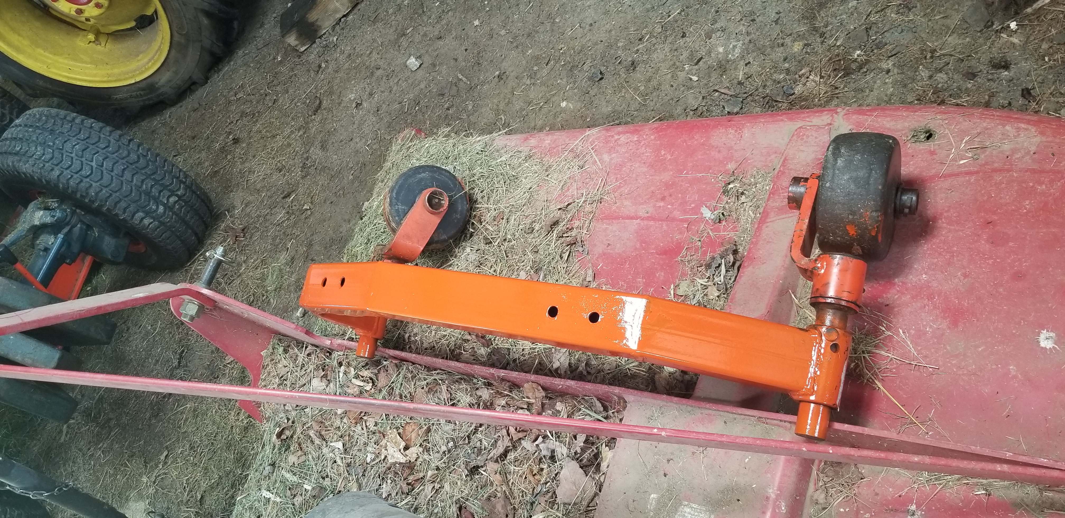

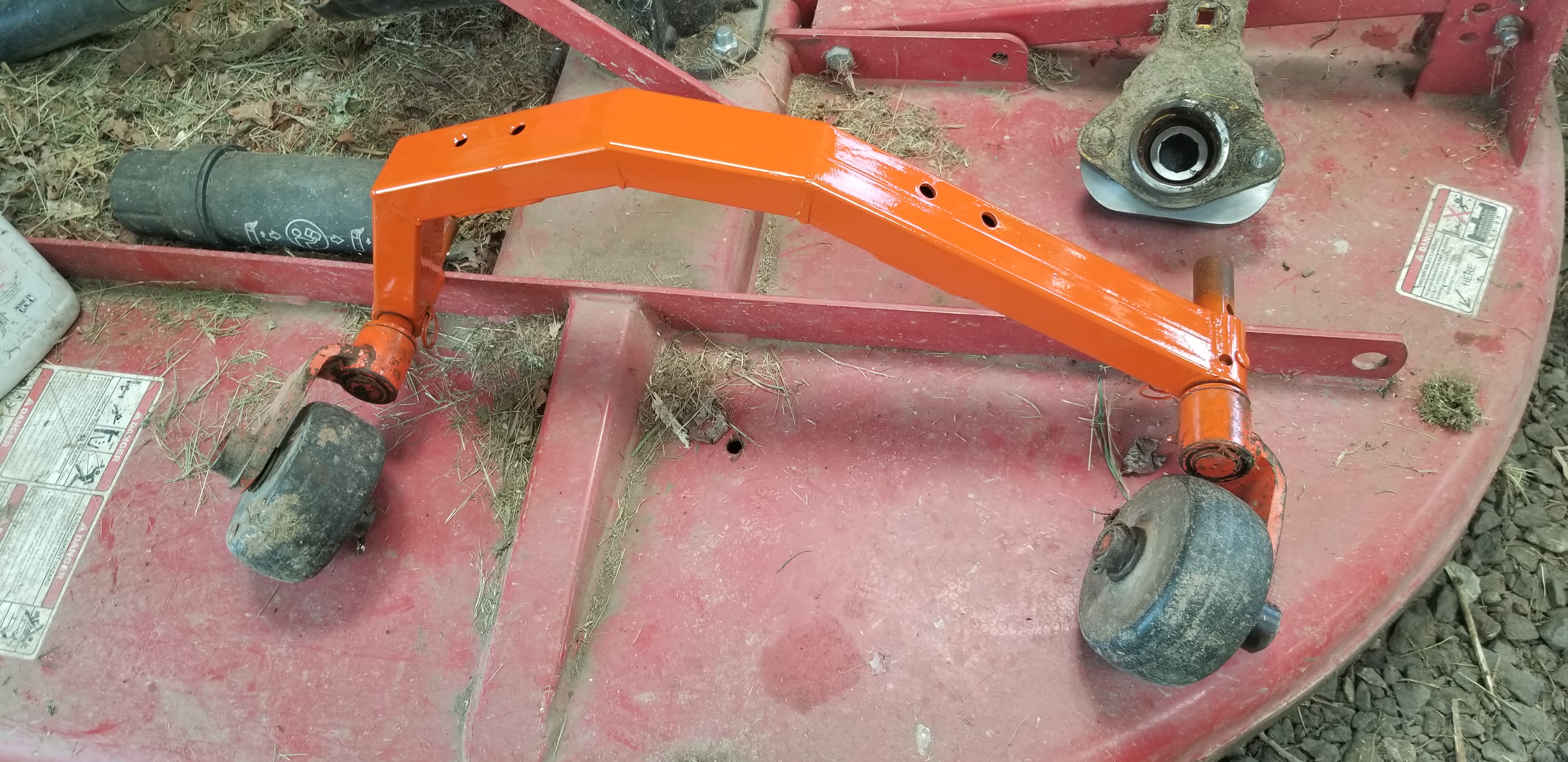

I have heard these arguments regarding gloom and doom and potential disasters with the rear wheel spacers and do not buy any of it. Never heard of a single ACTUAL problem. Only theoretical ones. Granted I use mine in a non-commercial farm environment where there is no bone-crusher workload and no FEL on that tractor, not that I think that would matter. I've seen no problems of any kind with the spacers (though I did just finish having a new set of gage wheel frames made for the MMM so that the rear gage wheels will now clear the big rear turf tires.) Spacing the rear tires a foot further apart meant the tires would not clear the MMM rear gage wheels in stock configuration. Tested that rig thoroughly Tuesday. All is well.

An update: I have the 6" spacers on each side of one of my B2150's. It is so comfortable to know that I can turn around and go sideways anytime i want to on a 40% slope and never be the least concerned about it getting tippy. I mentioned in post #5 that I had new gage wheel frames made for the belly mower so that the wheels clear the large rear turf tires. As I said , that modification works very well & I used it a lot more last week. Here is a picture of the two frames fabricated for me by a local welding shop in WV. They are sitting on top of a 5ft Bush Hog I also use with that Kubota -- ignore that.
