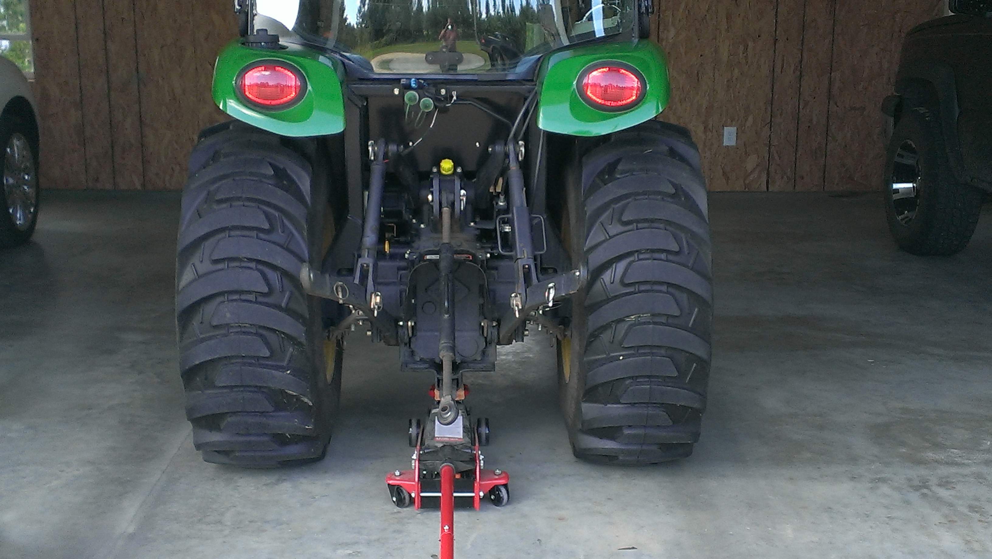

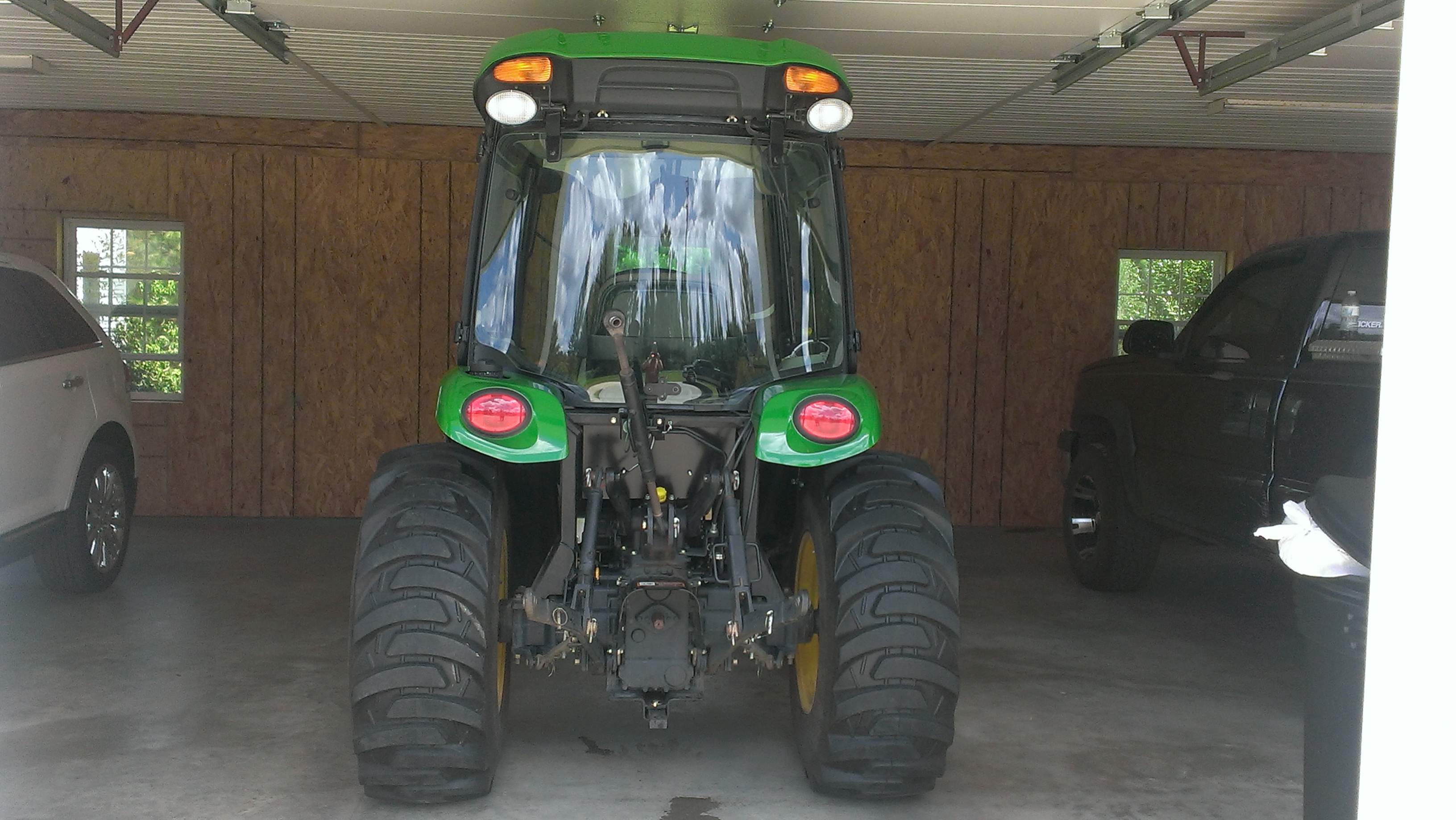

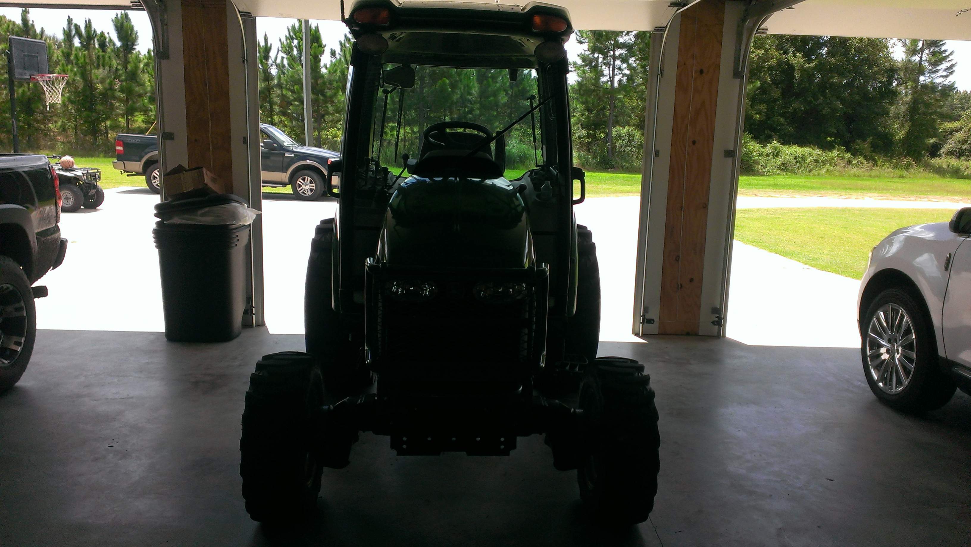

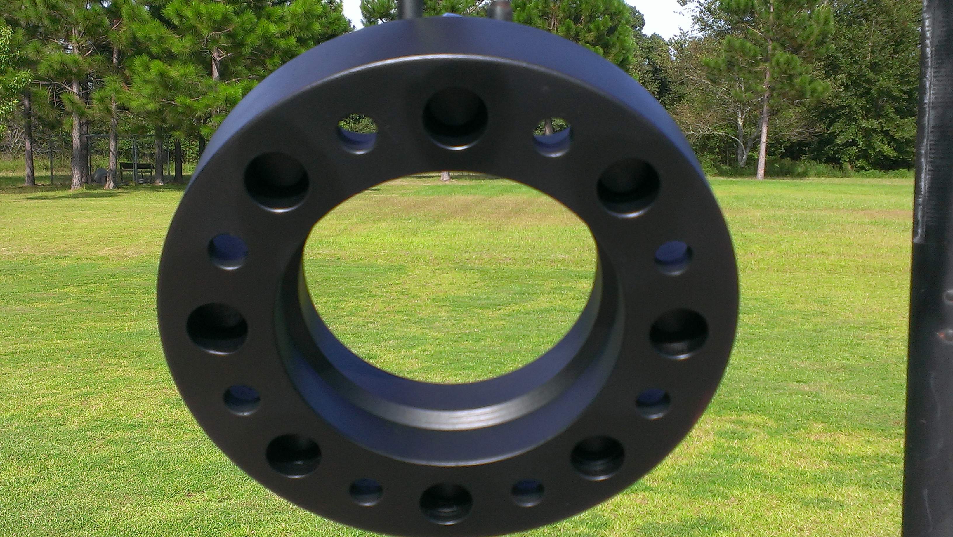

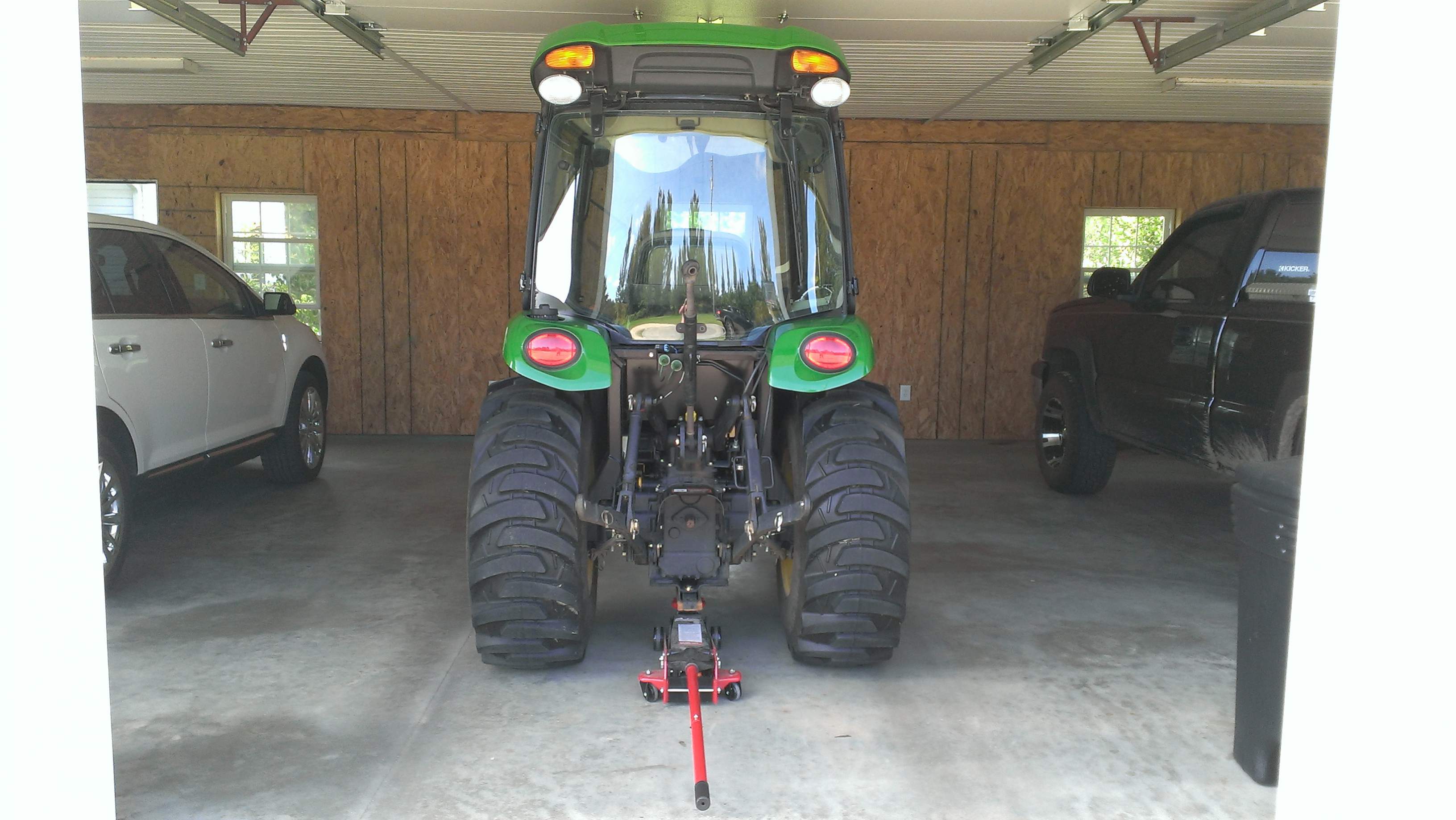

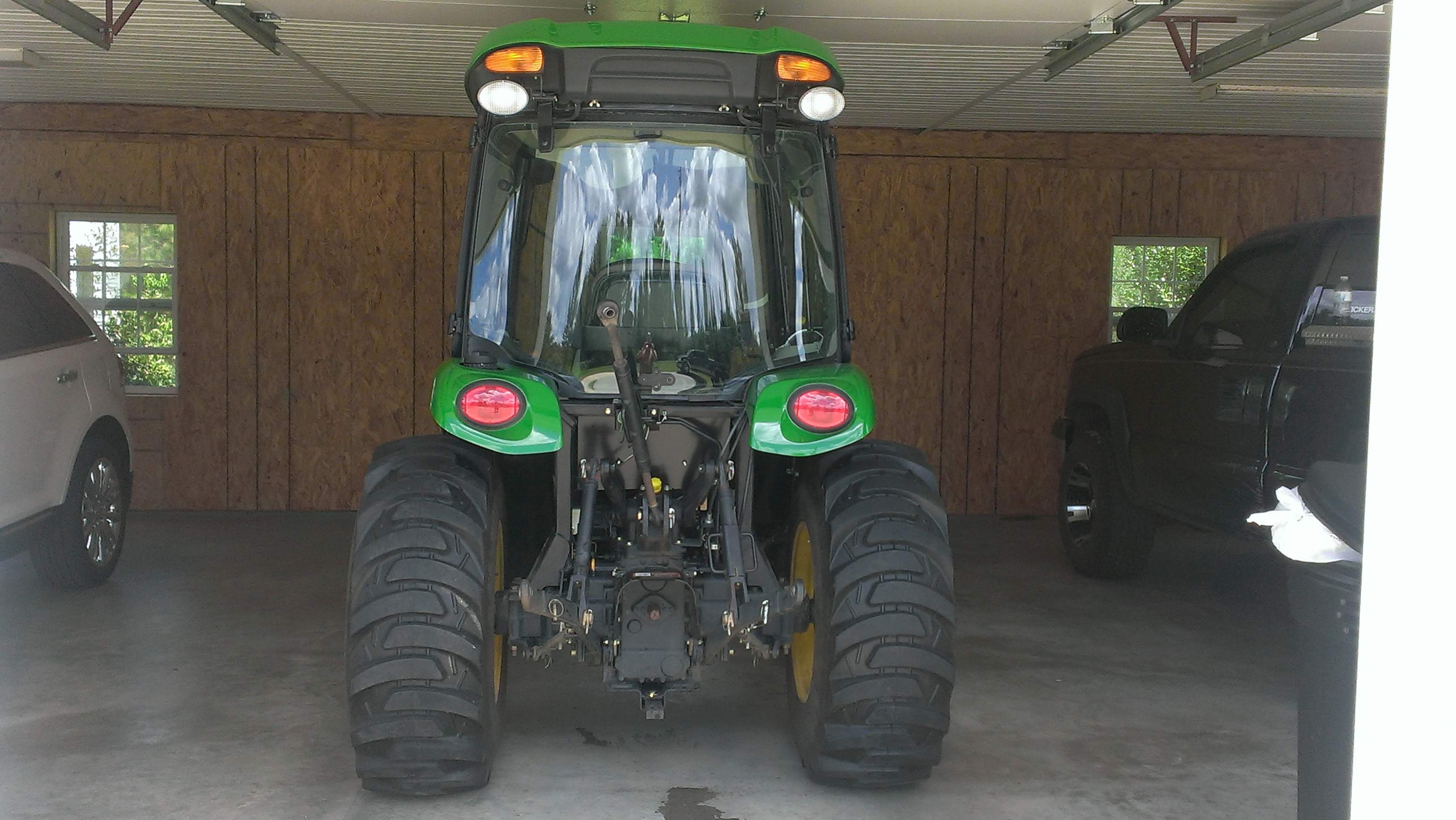

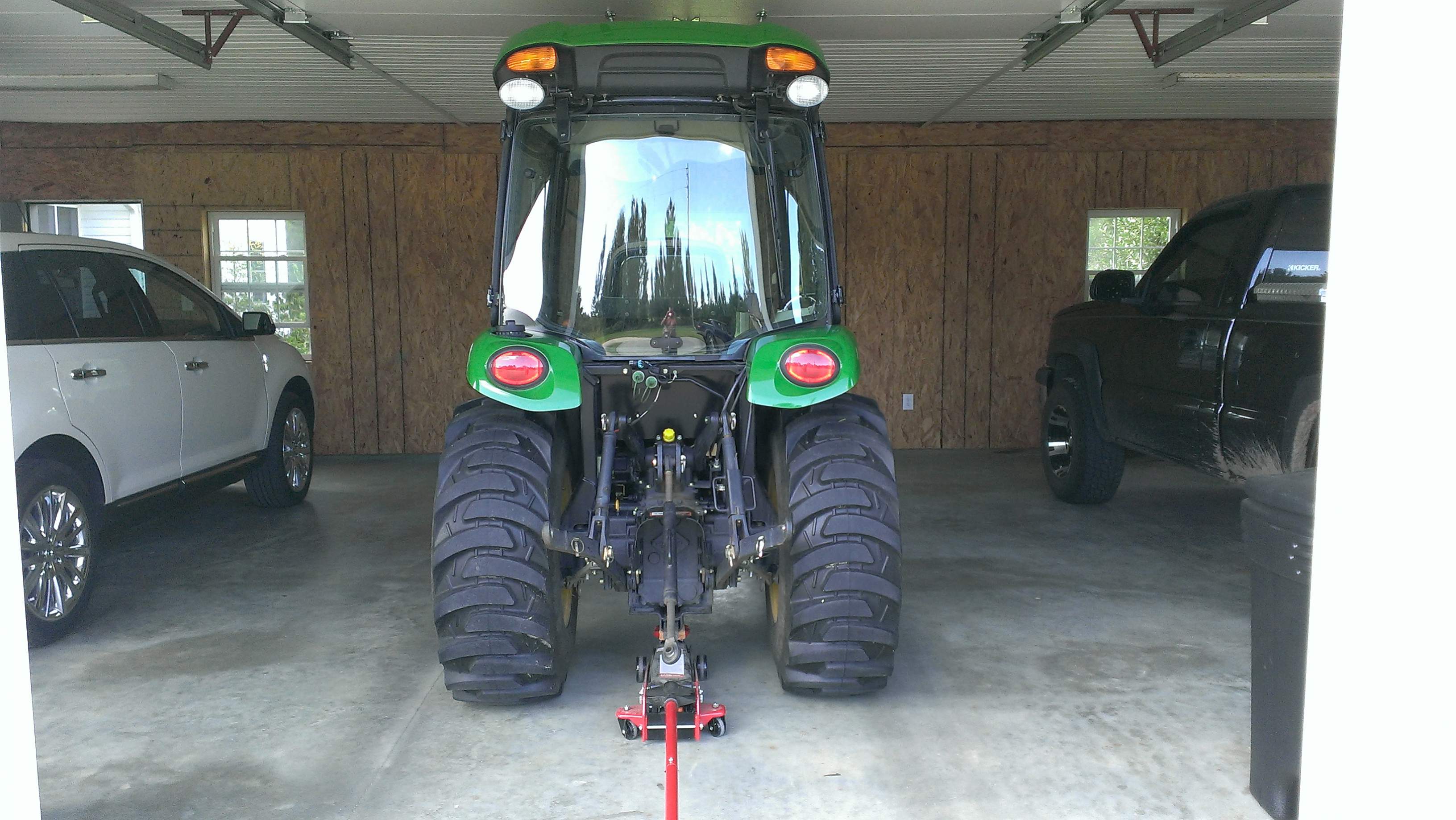

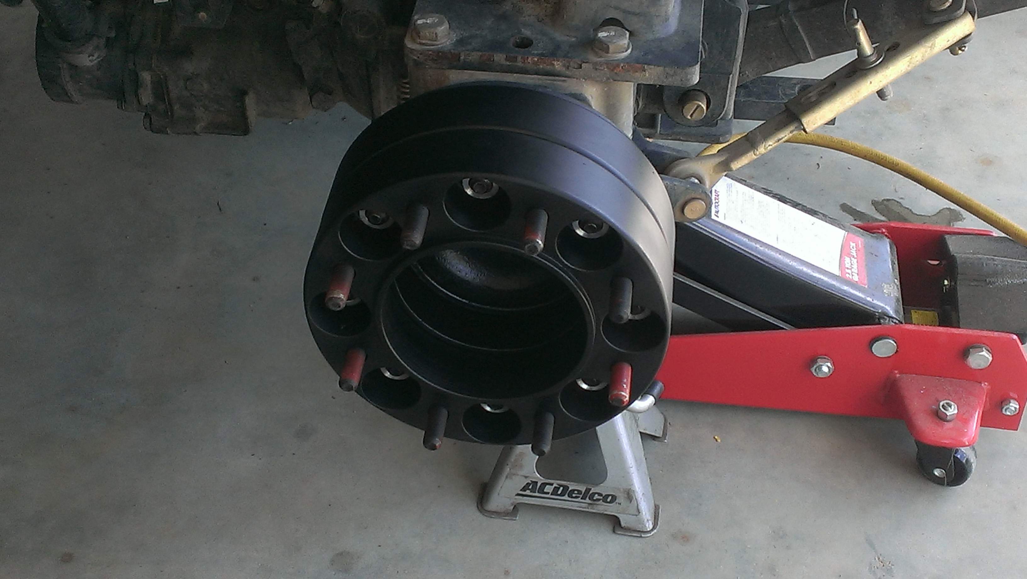

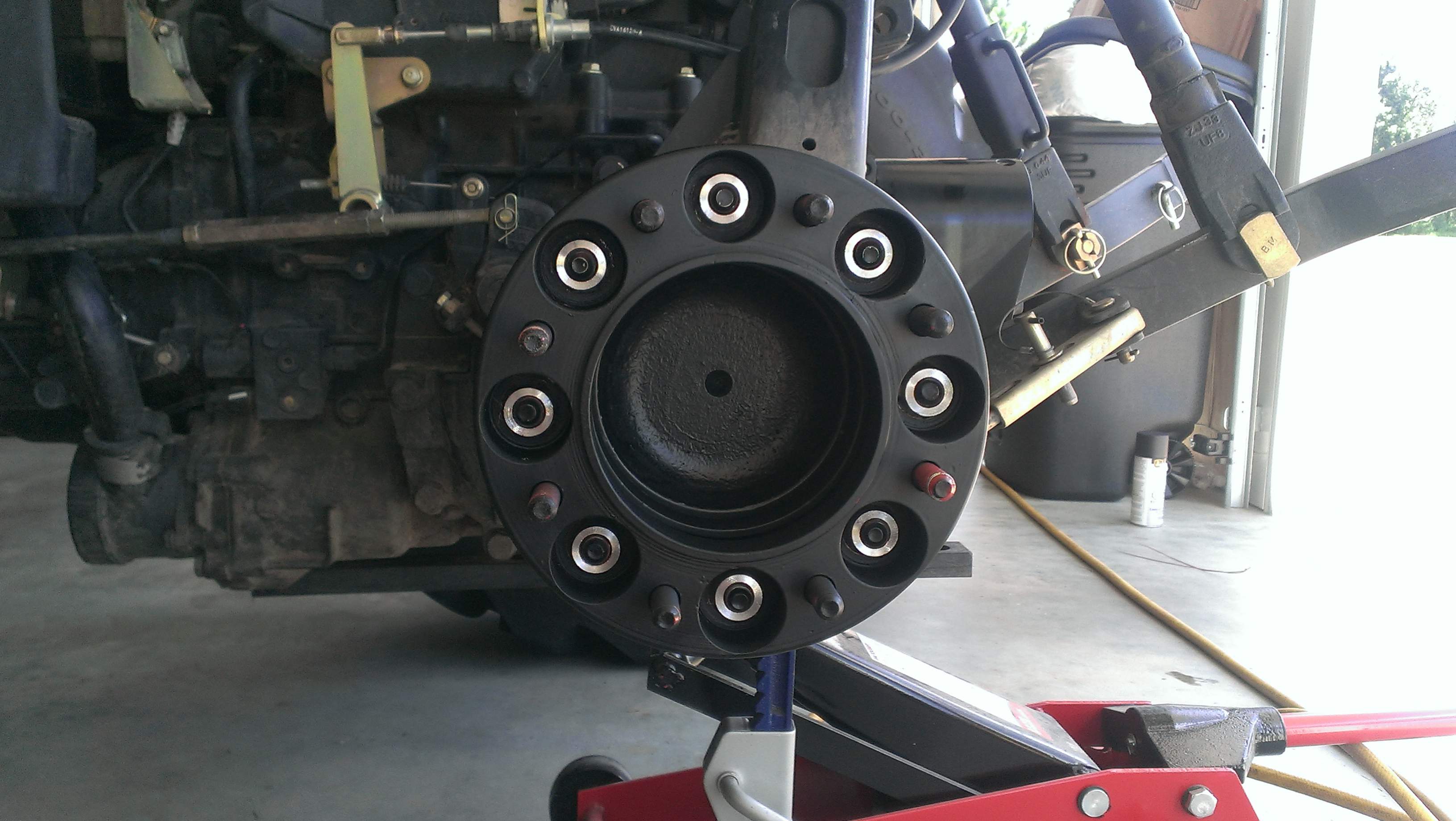

I installed rear wheel spacers on my 3520 with cab this past weekend. After three years, I finally have my stability problem corrected with the 8 inch addition. I purchased my spacers (4 - 2" with 8 pattern 9/16 lugs and lug nuts) from Skid Steer Solutions for 350.00 plus 45.00 shipping. I ordered them on 8/4 and received them on 8/9. Once recieved, I painted them John Deere Black. The installation was completed with no issues. Handling my water filled R4 tires alone was tricky though. I did use Loc-Tite Blue on the lugs to prevent future problems. Previous posts on this forum were a tremendous help. Thanks to all that provided those posts. Attached are some pictures of the installation. I hope this helps others that are considering adding spacers to 3X20 or 4X20 series tractors.

Now you just need a pair of fender extensions. See my 3720 wheel spacer thread for details
