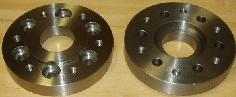

Here is a post of some adapters I designed and had a friend make for my Yanmar 1500.
This guy can also make them and seems tobe a pro...its is all he does I believe.
Here is his email:
Fred@wheeladapter.com
Here is his websight:
Wheel adapters

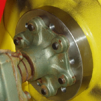

Here is a photo with them installed...before the painting that is!

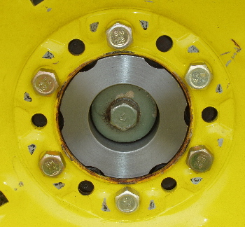

Here is a photo from the outside with the adapters installed. Hopefully this info helps rather than being too much..or maybe you already got the job finished!
