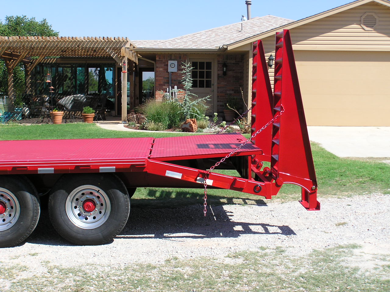

Can anyone tell me what wheel pattern is on a gooseneck trailer with 7k axles, for example I know that most 3.5k axles take a big bolt chevy wheel and 3k take a small bolt chevy. Any help will be appricated

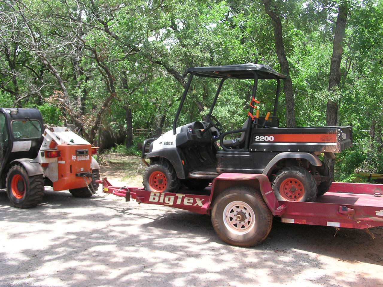

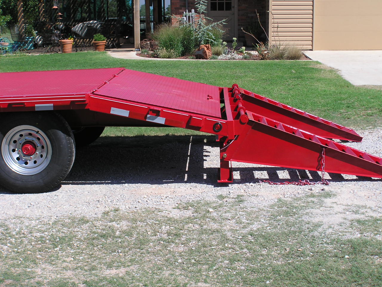

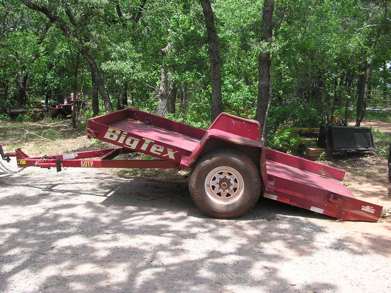

Mine is 8 hole
The 6K is also 8 hole.
   / wheel pattern
sorry guys, I may have mislead the question, I know it's 8 hole but what I'm wanting to know is what truck rim will fit my trailer. Ford chevy dodge ????
   / wheel pattern #5
all old 8 hole are the same but the center hub on chevy is smaller than ford don't know about dodge center hub size for sure though.
   / wheel pattern
thanks triptester that will be very useful information
   / wheel pattern #8
When using truck or auto rims on a trailer several things must be checked to insure they will fit. Center hub hole size, offset, and stud seat taper. Trailer rims usually have a large center hole but truck and auto rim center holes vary greatly. Trailer rims have the hub face centered in the rim where auto and truck rims can vary as much as 3 inches +/- . Most studs have a 45 degree taper but a few use a 60 degree taper.
